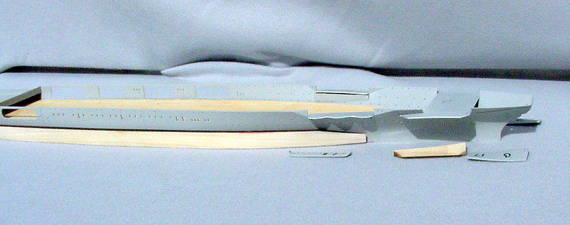

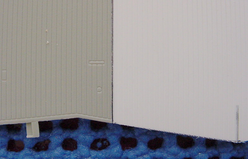

Converting the Trumpeter 1/350 CV-2 to a 1944 CV-3 has been on my to do list for a while. Finally started chopping, this post will show the hull roughed out (it can be argued the my finished builds are "roughed out" but we all build to the limits of our patience and ability). The Saratoga will be built as she looked at Iwo Jima, in measure 21.
I had good references, 1/192 plans of 1945 CV-3 from Floating Drydock and the Classic Warship Pictorial #11 - Lexington class carriers. The book has a set of very good pictures of Saratoga after her "dazzle" refit and she was 99%+ in this physical fit at Iwo.
Overall, I was very pleased with the Trumpeter kit, one BIG reservation being the FLIMSINESS of the hull. the plastic is way too thin and the flight deck locators are way too SMALL. The waterline hull was also bowed up in the middle by 1/8". The solution to the bow and in order to add heft, a wood stiffener was glued/screwed to the hull cross braces.
Hull work included lowering the hull (to match the FDD waterline) by cutting away the waterline plate flange to the level of the two foreward and aft reinforcing ribs, lengthening the forward sponson, removing detail at the 5"-25 locations (to convert to 5"-38 and quad 40mm), filling in the lowest level of portholes (again to match both plans and photos) and adding the large, asymmetric starboard blister. The blister deserved a photo of its own, it was carved as a single curved and twisted piece. The FDD plans do not have hull stations but luckily Friedman's carrier book had a Saratoga cross section with a dimension on the drawing (The blister is 6 feet at the top shelf, which is .21" in 1/350)
One final, editorial, comment. As I worked on the hull I was taken in by the "beauty" of this ship. I say this as many builds progress on line of Akagi, her contemporary (they were both laid down as WWI battlecrusiers and completed post WWI as carriers) which I appreciate as a historic ship and would build in an instant if I was doing IJN but after all these kind words still strikes me as an "ugly" ship.
Jim
Jim

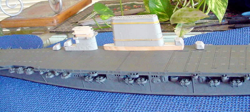

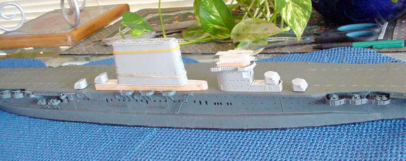

One pic of the island and stack roughed out, shot this pic primarily to show which parts were used and which were replaced.
I will be quiet for awhile, starting on the flight deck which I have been putting off because I could not figure out what to do with the life nets. Using them almost seemed as crude as using aztec stairs (which I did leave in the boat pockets - but will try to apply a PE side rail) but it took awhile to conceive of a scratch alternative.
Thanks for the interest so far.
Jim

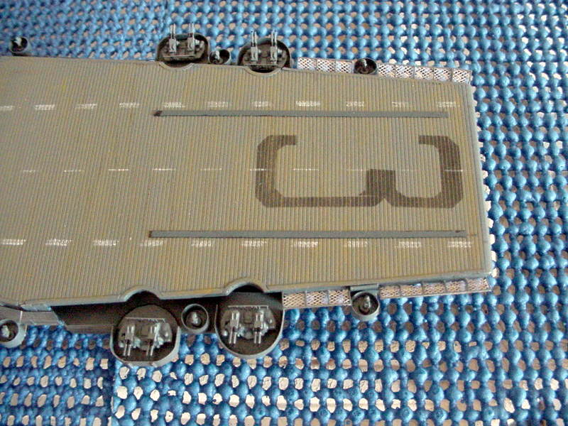

Modifying the flight deck turned out to be easier than I had any right to expect, the Trumpeter plank spacing was appx .039" and I bought some Evergreen .040 scribed sheet that was a very good match. Did NOT have to skin the entire deck.
As the pics show the flight deck bow and stern had to be modified for CV-3. The stern of CV-3 had the big ramp eliminated and was longer, while the bow section was slightly wider forward and had straight sides. Most of the midships area was identical (thankfully) between CV-2 and CV-3. The close up shows the match between Trumpeter and Evergreen.
Jim
Jim

Thanks for the offer of PE nets, but I think I found a material that will do the job. It is a plastic net hem stiffener that I picked up at a craft/sewing store (I get more useful stuff from this place). I brought along a sample of DD rail netting as an example and this material was finer.
I left the pocket aztec stairs in place. I have a conventional PE stair of the right size from which I will trim the two side rails. I will then glue a side rail to the side of the aztec stair. I think this will look OK.
Jim
Jim

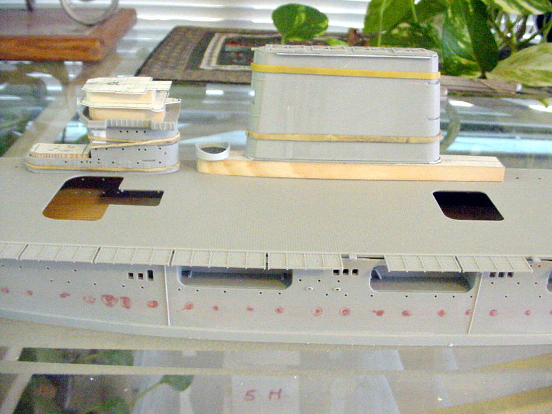

Have made LOTS of parts, some shown in first photo.
The second photo shows a test of the flight deck edge, made from black vinyl (electricians) tape. The tape is .006" thick and cuts with a very good edge. This photo also shows a test of my safety net construction. The frame is a staple and the net is the hem edging I mentioned previously. Comments pro or con accepted.
I do have a question to ask, The hull is just about done and it is a filthy mess. There is Bondo dust, styrene chips, sawdust and general grime everywhere! I am thinking about blowing off with the airbrush (unfilled) at 80 psi, followed by making some "tack rags" from an old t-shirt wet with mineral spirits. Any better ideas?
Jim
Jim

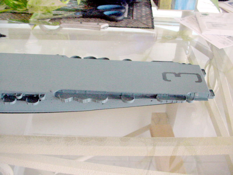

The hull is finally DONE! I am happy with the results so far, and that is not always the case. Two shots of the ship in general and a close up of the safety nets. I found some PE that was 4 1/4" squares in a row. This made a very good frame. The netting is the material I discussed earlier.
This is my first build with Crafters Pick "The Ultimate" (supposedly identical to "Gator Glue") and I very pleased with the stuff. Used it for "structural" joints on unprimed styrene and it did very well.
Jim
Jim
