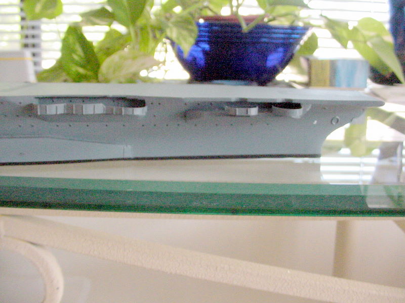

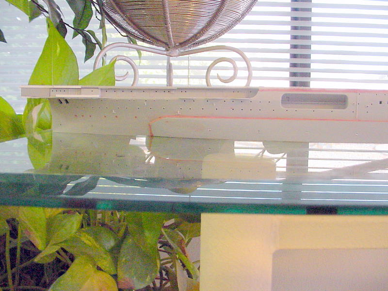

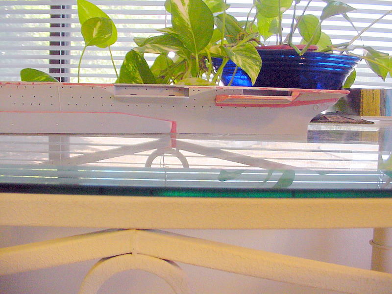

Converting the Trumpeter 1/350 CV-2 to a 1944 CV-3 has been on my to do list for a while. Finally started chopping, this post will show the hull roughed out (it can be argued the my finished builds are "roughed out" but we all build to the limits of our patience and ability). The Saratoga will be built as she looked at Iwo Jima, in measure 21.
I had good references, 1/192 plans of 1945 CV-3 from Floating Drydock and the Classic Warship Pictorial #11 - Lexington class carriers. The book has a set of very good pictures of Saratoga after her "dazzle" refit and she was 99%+ in this physical fit at Iwo.
Overall, I was very pleased with the Trumpeter kit, one BIG reservation being the FLIMSINESS of the hull. the plastic is way too thin and the flight deck locators are way too SMALL. The waterline hull was also bowed up in the middle by 1/8". The solution to the bow and in order to add heft, a wood stiffener was glued/screwed to the hull cross braces.
Hull work included lowering the hull (to match the FDD waterline) by cutting away the waterline plate flange to the level of the two foreward and aft reinforcing ribs, lengthening the forward sponson, removing detail at the 5"-25 locations (to convert to 5"-38 and quad 40mm), filling in the lowest level of portholes (again to match both plans and photos) and adding the large, asymmetric starboard blister. The blister deserved a photo of its own, it was carved as a single curved and twisted piece. The FDD plans do not have hull stations but luckily Friedman's carrier book had a Saratoga cross section with a dimension on the drawing (The blister is 6 feet at the top shelf, which is .21" in 1/350)
