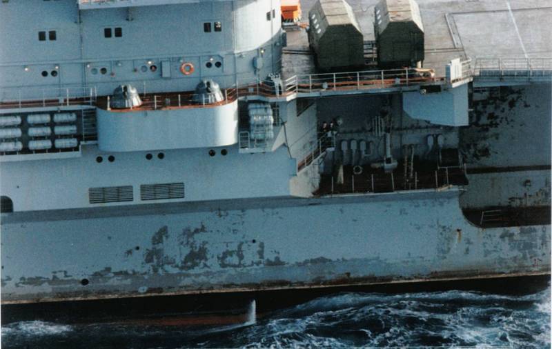

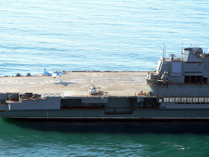

Look I have a few images of close ups of the Admiral Kuznetsov. The main directory is http://picasaweb.google.com/Mick.Elst/AdmiralKuznetsov
Here are a few:
Hope this helps you, mind you I'm still looking for better images.
Here are a few:

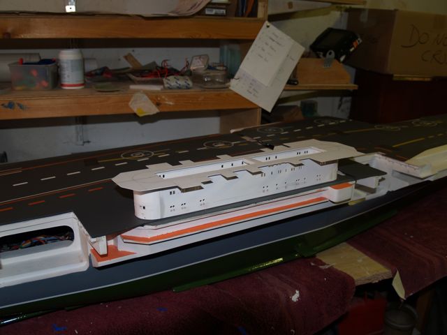

Work has been a little slow this month -I'm trying to produce a part Air Wing for my HST.
After a fair amount of effort I now have a flight deck That fits reasonably well and has all it's 'art work' on. There appears to be a few lining formats used on the deck of the Kuznetsov so I have picked one marked '1996'. After getting the surface reasonably smooth I painted it dark grey and matt varnished it before masking and painting the lines. Silo lids, JBD's have been drawn on the computer and printed on to tattoo film, cut out and stuck down. Helo spots were done the same way, but the computer printed images were stuck on the back of white Contact and cut out. I put some bridging strips in to help keep them round as they were stuck down. When all was stuck down the whole thing was matt varnished again to seal it
I don't usually make the Island until the hull/flight deck are finished but on the HST this involved cutting the finished deck, so this time I built the basic Island and fitted it before painting the deck - a bit safer I think - the Island will be put to one side now and finished at the end.
In between times I'm mass producing hand rails and trying to make some deck edging - which incidently, will help cover the deck joints. The railings are made from 10x20 thou styrene - five rail for 4 rail so as there is a spare rail to stick to the deck instead of trying to stick the tiny uprights individually.
Paul Bannon

OK - her goes with a bit more info - not to good at the pic's, I tend to get carried away with building a particular part and don't think of taking pictures. Example of this was working on the 'upside' of the boat and forgetting about everything thats really on the 'underside' and is best done with the boat upside down. Consequently I have decided to finish all these bits first - boat decks, underside of sponsons etc.
Have built the boat decks in the same way as I did on HST and the way Dave has built the ones on the Kiev. First cut the holes to accept the finished decks First Pic actually shows one deck fitted and the other two holes ready to be filled - holes are to let the wiring for the lights through in to the hull - each deck has grain of rice lights which will be under RC.
The first cut out has also been made for the life raft shutes and some work on the re enforcing for the overhang
