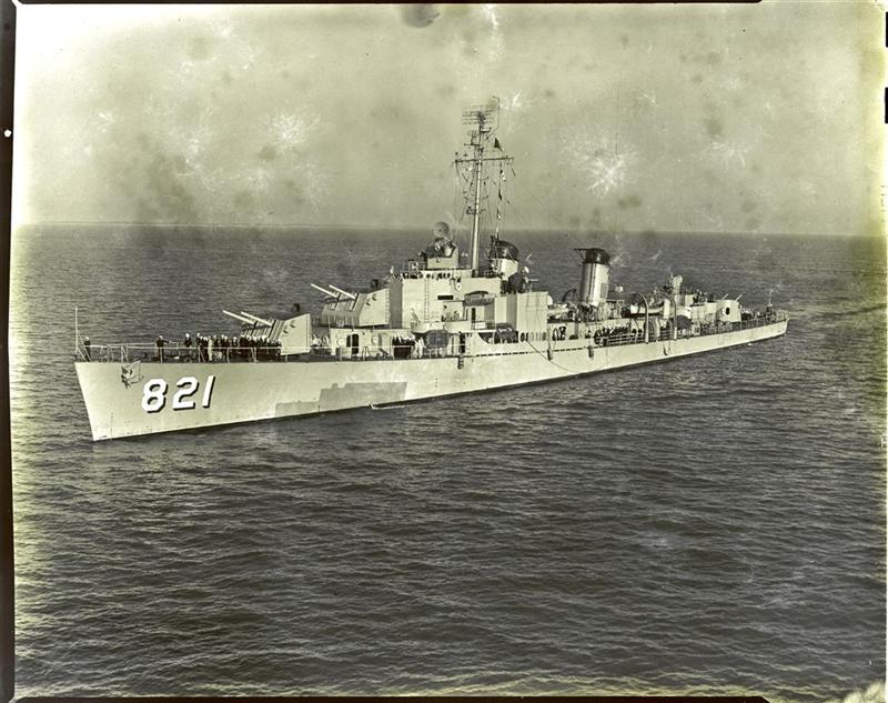

Here are three shots of USS Johnston coming into dock at New Orleans in Feburary of '51'. She was acting as plane guard for the USS Monterey as a training carrier. My dad made these while on board. Just found them in an old box of 4x5 negatives that my sister had in the basement fot 40 years.
Bob W

PostPosted: Sat Aug 22, 2009 9:05 pm
Posts: 3841
Nice views, she has been updated with 3-in guns, but still has a pole mast.
PostPosted: Sat Aug 22, 2009 9:25 pm
Posts: 3841
Bob,
I checked and I'll be dang if I didn't have an image from NARA of your father's ship taken about nine months earlier on 4 May 1950 off Boston. She just got one of two twin 3-in mounts (this was an early installation of this new mount on destroyers) and two single 3-in mounts. It appears from your photos that she still only had the one twin mount. That is interesting, I figured she would have gotten the second mount by the time of your photos. The USN was removing quad 40-mm mounts in 1949-50 to save crew manpower and planned to return the mounts in time of war (they did return the mounts during the Korean War), so maybe the same applied to the twin 3-in mounts???
PostPosted: Sun Aug 23, 2009 3:17 am
Posts: 786
Bob W
Hi Bob W, these 3 nice photos would be a remarkable contribution to Navsource....what do you think?
Thanks for sharing! :thumbs_up_1:

PostPosted: Sun Aug 23, 2009 5:20 am
Joined: Thu Dec 25, 2008 5:36 pm
Posts: 127
Hey Bob,
The photo of DD-821 docking looks an awful lot like the docks with Chevalier Field at NAS Pensacola FL in the background. That would be where the training carrier would be homeported at the time and would be "parking" to the left of the view in those photos. It looks like that photo was taken from the fantail of that carrier.
GREAT photos.............

PostPosted: Sun Aug 23, 2009 9:27 am
Joined: Thu Apr 03, 2008 10:07 am
Posts: 236
Location: Pittsgrove, New Jersey
Rick,
Great shot of DD821. My Dad was on USS Monterey, I think shooting from the aft flight deck. He was a photographers mate on board for about one year, went ashore in July of 51.
Jimmy,
I only have the three negs of DD821. Just got a HP Scanjet 4050 so I could save Dad's 4x5 negatives. How do I submit them to Navsource? There are maybe twenty shots of Monterey flight ops during Jan. and Feb 1951. Also, about fifty shots of the ship's visit to New Orleans for the 1951 Mardi Gras. And, a set of maybe thirty which show a visit of John F. Folberg, Ass. Sec. of the Navy for Air to Monterey. He was newly qualified for carrier ops to better understand his job.
Steve,
You may be correct, the shots are not labled as to local of DD821. I do know the ones of Monterey docking are New Orleans.
Thanks Guys
Bob Wescott
