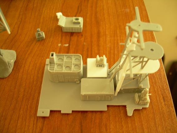

My idea is pretty much a VLS version of the Kidds. They would be equipped with a modern version of the New Threat Upgrade. I don't know how much upgrade would actually be involved becaues the system, epsecially in the late '90s was awefully advanced, but CEC would certainly be part of the package.
I would involve the Mk71 MCLWG for the forward mount and upgrade the aft five-inch mount to the Mk45 Mod4.
The Sea Sparrow mount would be removed and the massive void under it would be filled with another 64 cells of VLS.
SPG-51D/E illuminators would be installed
SPQ-9B in place of the 9A on the main mast
SPS-48 and 49
2 RAM mounts
Phalanx Block 1B in place of the current Phalanx
Permanent UAV antennas
Mk23 TAS
Mk38 Mod2 (would unfortunately be installed. They really suck.)
Here are the pictures I have so far.

Rockin' posts! The exchange of ideas you guys are having is very informative. So, let me ask you, I saw you said the displacement of existing DD-963 hulls could only support 9,200 to 9,300 tones but could not support 10,000 tones. With that in mind, could a DD-963 in your opinion support the addition of another 64 cell VLS pad back aft in the place of the Sea Sparrow launcher?
PostPosted: Tue Jul 21, 2009 8:34 pm
Posts: 1111
Some very interesting thoughts put forward here.
I would imagine, a Mk71 modernized, had it been retained, would have a newer Low RCS layout to it. And it might have, of course, been made into a slightly more compact version.
I always thought a VLS Kidd would look neat, so I look forward to seeing the design in action, Dave. She should be quite something to see.
