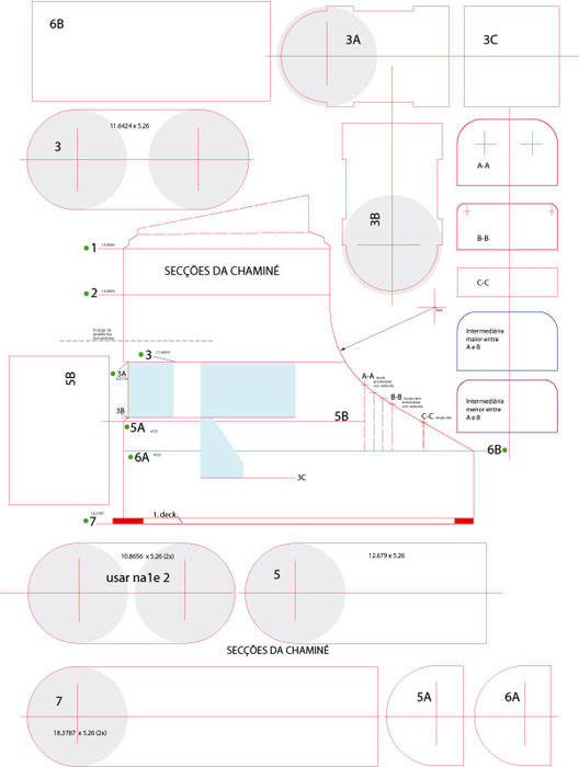

First of all i wanna to present my logotypes(i own create) of my two shipyards.
the first Netuno was created in 1995 and the new Marlim was created last week.
sure the two logos are ficticious i have no firm i work on an agency of publicity.
but represent a mark of my shipyards.
second i am showing the drawing i am doing to mount my funnel(wish me luck please).
some parts are round and this difficult a little the mount.
regards :wave_1:

Jimmy, esse desenho ai partiu da minha cabe�a de engenheiro miniaturizado.
� que eu costumo imaginar como vou construir as estruturas e vou fazendo sketches..
depois eu mesmo redesenho. isso ai que vc viu nao tem em planta alguma.
Jimmy are drawings made by my heads and hands..
i stay thinking how i can do determined piece and i make progress and try to make this reality :cool_2:

� verdade, esse desenho � bem complexo e me tomou muitos pensamentos.... :wave_1:

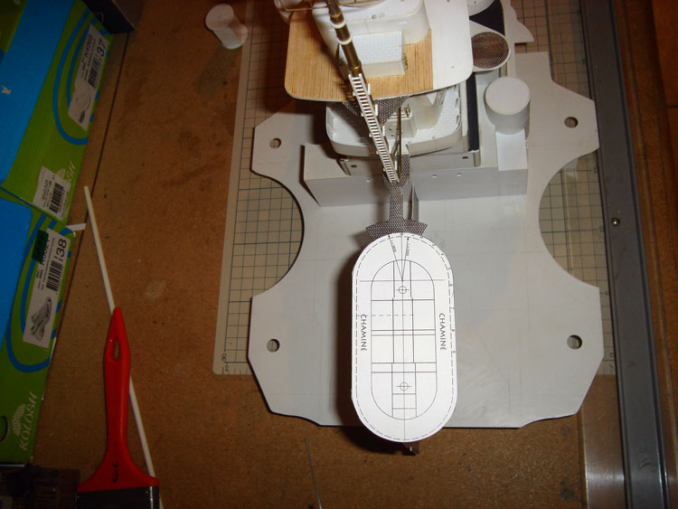

the drawings are based in this card paper model i am doing...
but i prefer still not use the central nervure cause i need make holes to prevent a possible
smoke who i can use if i decided to install a smoke funnel system.
maibe no... but.... :thumbs_up_1:

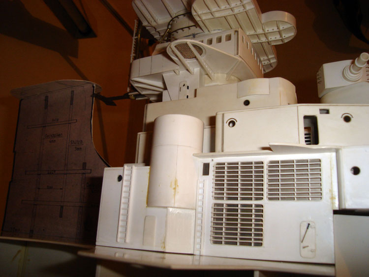

just more image and lot of paper :big_grin:

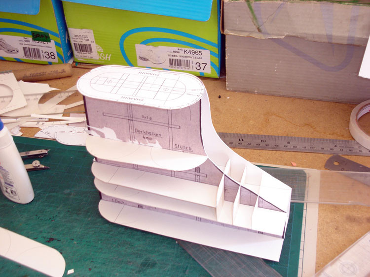

new advances on funnel's building.
i change the mode to do. not central nervure just part of it.
i need put a tube on the centre of funnel.
and i change some parts of drawing too.
but still in hard paper study.
Regards :wave_1: :wave_1:
