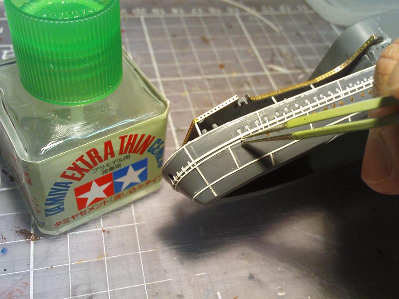

The following shows how to build the elec. outboard line. Cutting thin strip of plastic, bend it to the right shape by tweezers, and then cutting each one to precise length. I have to double check each one whether they are not too short or long otherwise it would look like a mess when they are placed on the hull. This process took me ages to complete, but very happy with the result after it is done. I actually use similar method in the 1/700 Zuikaku.
STEP 1
STEP 2
STEP 3

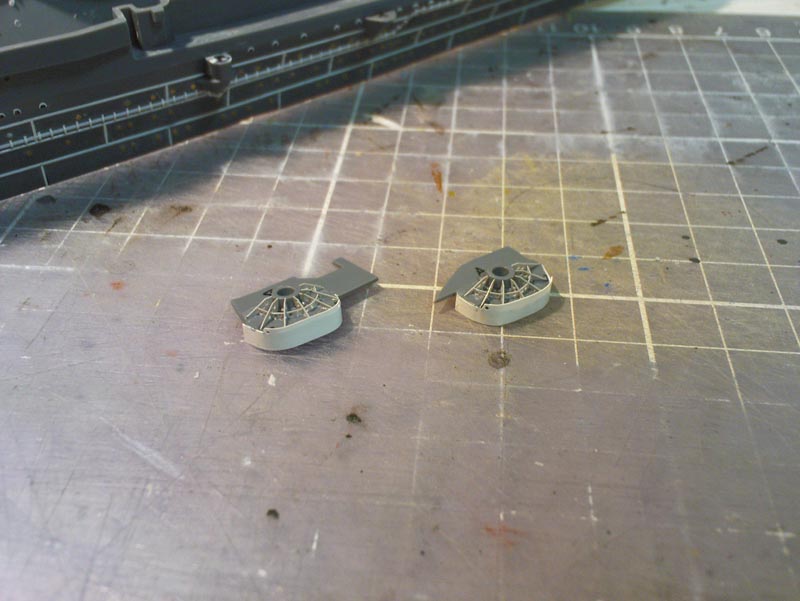

The AA-Gun platform's underside structures (flages) are all scatch-built by using "Yellow sub" plastic strip by Hobby Base (similar to Evergreen products but comes in grey colour, but much finer & thinner), drilled holes into each one. Each flages are custom made and none of them are equal in length. Again after it was completed I am very happy with the result. The good thing to made them yourself is that you can control the distance of the holes and length of each flage to match the unequal radius in each of the platform's edges, but photo-etch cannot give exactly what I wanted.
STEP 1
STEP 2

Between each flanges are the cross bracing, it was made by using 1mm wide "Yellow sub" plastic strip by Hobby Base. Each are measured & cut to fit between the flages so none of them are eqaul in lenght. Also need to drill holes in each of them. Result is better than photo-etch.
Continue from Previous post
STEP 3
STEP 4
STEP 5

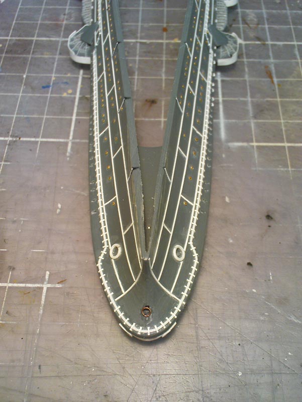

Another photo of the bow, the panel lines are very thin plastic strips cut out from evergreen plastic card,
Underside of the platform, see these flages, much easier to do compared to the AA-gun platform, cos they are mostly in the same lengths.

Bow details - flooring lines again created by cutting thin strips from plastic card.
