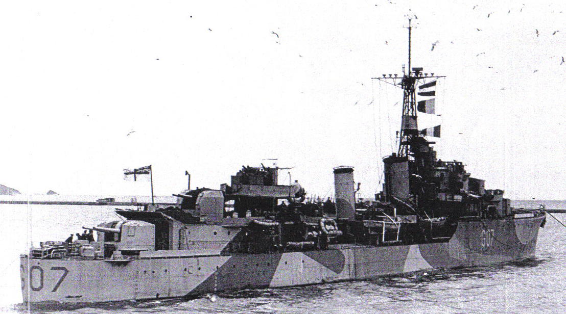

Tribal Class Camouflage
MATABELE and ASHANTI carried a multi-coloured camouflage (described as First Admiralty Disruptive) in the 1941-42 period. There's a photo of MATABELE's port side at http://commons.wikimedia.org/wiki/File:HMS_Matabele.jpg, and others of ASHANTI's port side in the same scheme have been published. There are several photos of what I believe to be the starboard side of the same scheme in various books (it looks vastly different). A colour profile of ASHANTI's starboard side and MATABELE's port side appear in the David Lyon's long-out-of-print Warship Profile No2: HMS Cossack (London: Profile Publications).
Does anyone know what colours were used?
Tim
Tim

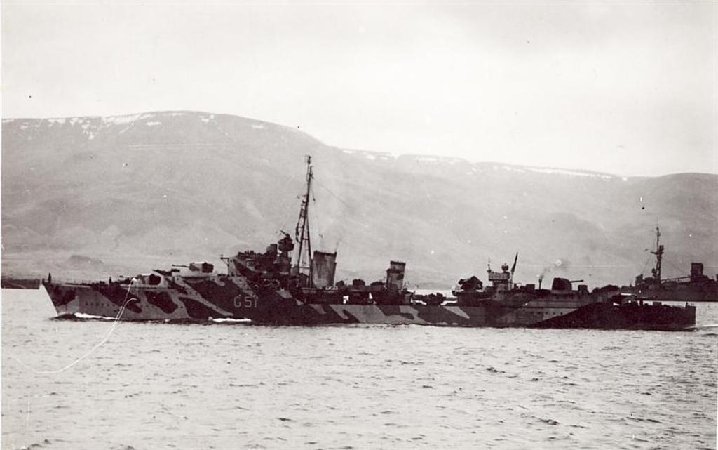

Hi Tim,
I'm after the same info.
Here's another photo to help jog some memories.
Min
Min

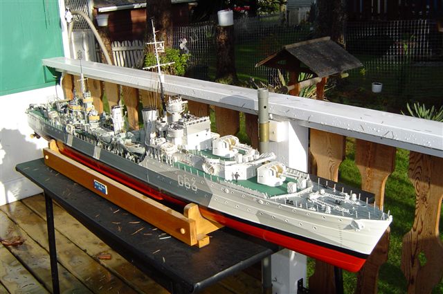

If doing Athabaskan with single 20mm and tripod mast you have a choice of two colour schemes.
For decks I would suggest a medium grey on metal areas, but the majority was covered with Semtex which at this stage of the war was green when new (as shown on this model of Haida) but presumably faded and dirtied fairly quickly.

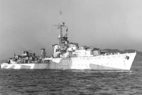

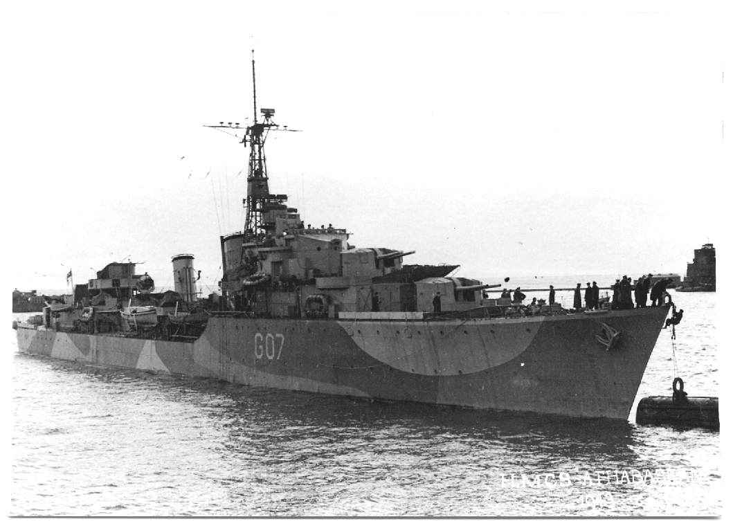

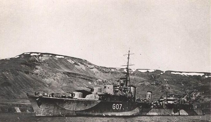

If you are thinking of doing Athabaskan (1) with lattice mast then you need to give her 6 twin 20mm in place of the single 20mm. Again you have a choice of two colour schemes: late 1943 and as sunk in Spring 1944.
Beware of the Shipcraft book. Much detail in it is wrong. The colour suggestion for Athabaskan on page 46 is hopelessly so. The pattern drawn is what she wore in 1944 - but MS1 was a very dark grey and if you painted your model MS1 where suggested it would look very strange indeed!

Alan Raven gives the colours for Athabaskan's final scheme as white and B55

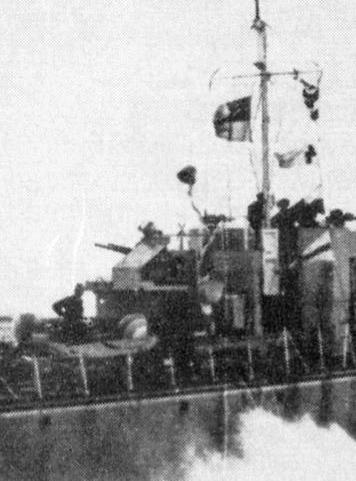

- Admhawk
- Posts: 964
Re: Calling all Royal Navy Tribal class fans
Mike, from what I can see on a few small colour images, it looks like rust coloured decks to me!Mike W wrote:Also I would expect the non-semtex covered decks to be in a dark grey, possibly AP507A or G10/MS1 - again any comments?
thanks
Mike
507B or MS2 look closer in some pics.
However, this photo shows what looks like G20 on the main deck of a River class frigate in 1945 with what appears to be 507B or MS2 on the fwd bridge overhang and maybe brown semtex on the gun deck?
