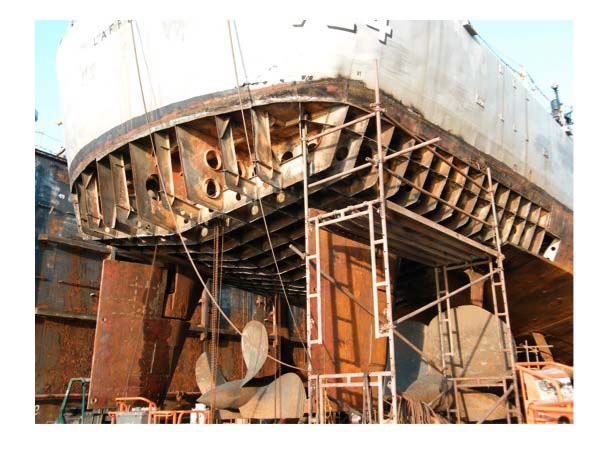

The most decorated WWII-era destroyer still in existence, the USS Laffey is the only Sumner Class destroyer still afloat in the world and is today a Museum at Patriots Point, USA.
USS Laffey in floating drydock, AFDL-47, at Detyen�s Shipyard in North Charleston, SC. She will be fitted for a new 3/8? bottom from bow to stern, five new bulkheads in the four machinery spaces, and new transverse/longitudinal frames and foundations in Machinery Rooms 1 � 4.
Source:
http://cv10navalaviator.wordpress.com/2 ... -dry-dock/
What I see that is very interesting, are the ship's ribs, exposed when the repairs are beeing made.
For modellers comprehension, I sugest the following pictures, that are rare to see.
