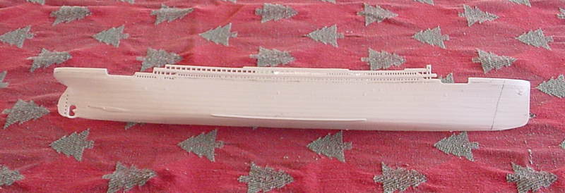

Re: The "others"..AO,AK,AP &&..USN/1944/350....APA-6
A photo of the shortened and semi waterlined hull.
Plans to the extent that they are drawn.
Jim
I had to straighten the new stem after cutting off 1.3 inches from the hull (pic 1). The left is the straight Titanic stem and the right is the curved new stem.
Water at 195 degrees F for 20 seconds did the trick (pic 2).
Straight stems. More bend to the bow was also added to make up for that cut off. Pic 3 is the result.
Jim

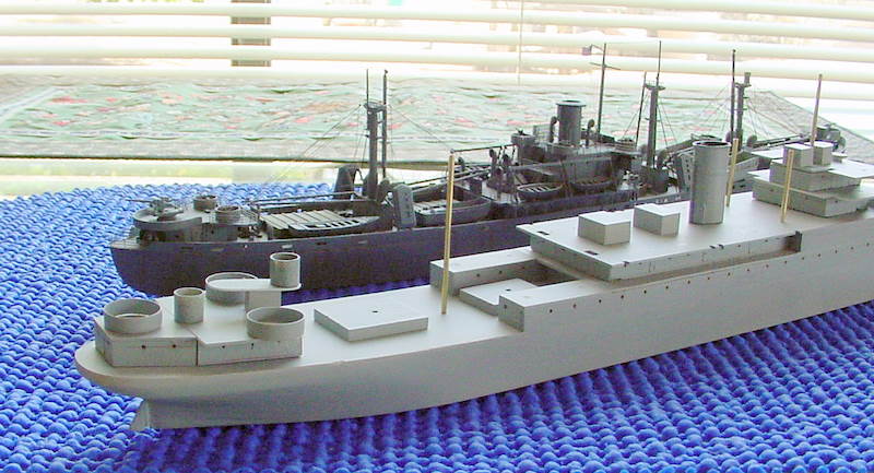

Re: The "others"..USN/1944..1/350 APA-6 from 1/570 Titanic
Plugging along. The brass rods show the location of masts, but do not indicate height or diameter. As you can see nothing much has been done regarding lift (masts & booms), boats, davits or cradles. I must be leaving the easy stuff for the end.
I did break down and buy a Trumpeter Liberty for parts (and I am known to TIGHT). During what the Phoenix area considers BAD winter weather (low 60's, cloudy, rainy and windy), I did not venture outside to do hull Bondo work. Tried to duplicate the steam cargo winches on the Liberty kit and failed miserably. Broke down and bought the kit for parts, winches, cowl vents etc.

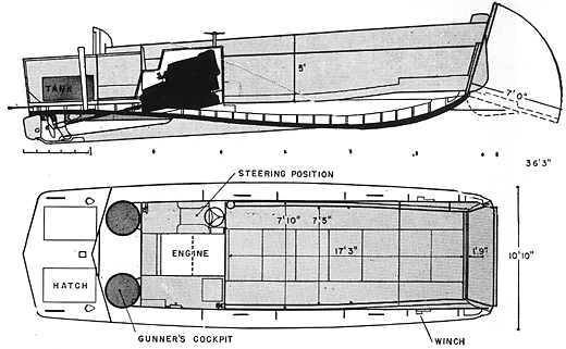

The BOATS........the main armament
pic 1 The full complement. 4 L'arsenal LCVPs in 4 L'arsenal LCM(3)s, 14 scratched LCVPs and 1 scratched LCPR. It turns out that I will have to scratch the LCM(6)s for the next ships. The original LCM(3) was 50' long and could not swallow the 36' LCVP with its ramp up while it's replacement LCM(6) grew to 56' and would easily swallow the LCVP. The Heywood's beam was 56' so a 56' boat would be cramped while a C-2 or C-3 hull would easily accommodate 56'. I started to scratch the LCVPs because I calculated I would eventually need well over 100 and I did not want to change my status wit5h L'arsenal from good customer to shareholder.
pic 2 Front row scratched LCPR vs ISW LCPL. Back row L'arsenal LCVP, scratched LCVP and ISW LCVP.
pic 3 Parts to scratch a LCVP.
jim
pic 4 The dry fit.
jim
pic 4 The dry fit.

The LCVPs dhould fit within the cargo decks of the LCMs and the ramps of the LCVPs should be below the tops of the LCM ramps.
http://www.navsource.org/archives/10/03/100300623.jpg
http://www.navsource.org/archives/10/03/100300622.jpg
From your photos, it appears that the breakwaters attached to the ramps of the LCVPs are too large, both on the purchased boats and on the scratch builds. And purely for reference
