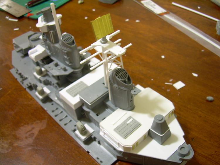

Here are a few more updates. These are the main structural modifications to make Tamiya's 1/350 scale 1980s refit USS New Jersey toa 2006-2009 modernized version of the ship.
Here's a decent view of the new Phalanx equipment and maintenance chairs, the ECM house built around the forward fire-control tower unique to Iowa, Missouri, and Wisconsin, the amidships elevated VLS facilities. The white rectangles the 5" guns are sitting on are the box that the 5" gun comes in. It's an entire assembly including the Mk45 Mod2 (modified to Mod4 except for the gun shield), loading assembly, and magazine.

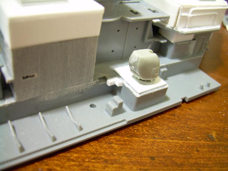

Here is the custom designed aft mast, the cleared off CIWS platform, and aft VLS arrangement. You see the SPS-48 and the rest of the platform is for an aft SPQ-9B. The aft CIWS platform has been cleared for the installation of a pair of RAM mounts where the Phalanx used to be.

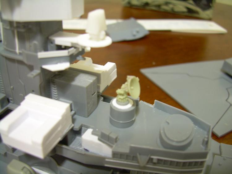

Here is the deck left where the aft ABLs used to be. Just think, this one arrangement you see here is as many missiles as the Iowa had in the '80s. Incredible. This simple VLS upgrade that was scheduled for USS Iowa in 1993 would have quadrupled her Tomahawk missile capability.
So, in this aft decking, what would you guys recommend be put here? I am thinking a second battery of SRBOC and NULKA counter measure launchers.

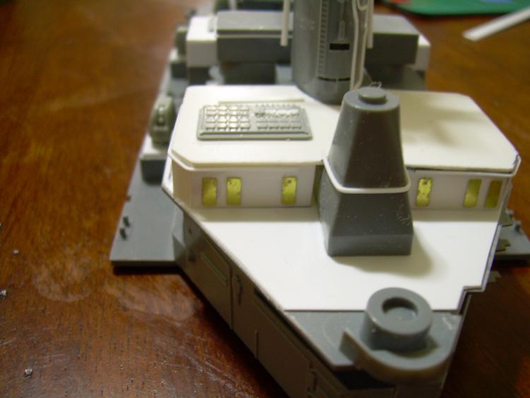

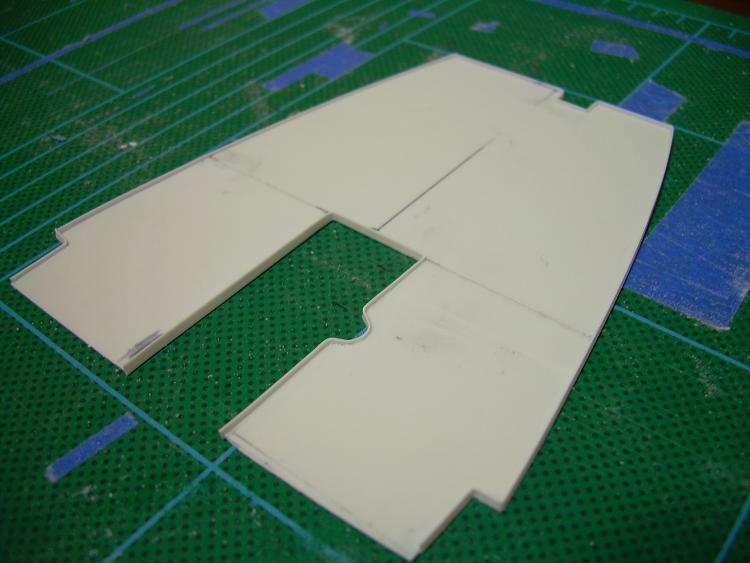

And now, the rest of the pictures:

Hey, guys! Here are sone updates to the Iowa.
Here is the addition of the vestibules that were going to be built on Wisconsin, and I assume back fitted to the others, that provided a way to get to the bridge without going outside. Appatenly going thorugh the conning tower was out of the question, so you had to go outside to get to the bridge. These fixed that!
Also, the cabling that runs around the outside of the bridge, additions to the fire control tower.
More of the bridge work
Here are some accuracies that were missed by Tamiya. In the '80s, shrapnel proof exhaust vents were installed to the 5" magazines.

Here are some updates. One inaccuracy most people see when making the Tamiya 1/350 Battleship New Jersey is her helicopter pad is not elevated and ramped down to the main deck. Here I have made an elevated deck with a lip running all the way around it.
