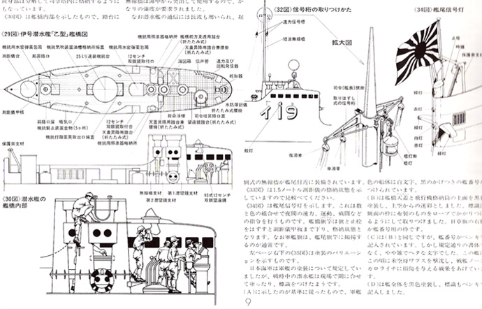

Hi Peter:
The upper sub in picture#1 is all gray with black stained decks, waterline is hull red.
Lower sub is all black, including decks. White identification markings as seen on deck.
Second picture is as follows.
I-19 All gray with black painted upper hangar and conning tower.
1-29 All black conning tower and hull including decks.

Re: Japanese translation help needed please!!! (Nichimo I-19)
The first image only has the profound instructions: deck color, lower hull (below waterline) color, upper hull (above waterline) color.
The second image describes the colors as "...like other submarines, the upper color was "mouse [gray] color", the underside was "red brown color", and the deck "wood color", with the advice that to make them more difficult to see from the air a darker gray was used, and a darker than wood color might be better for models, like "dark brown". A mix is then suggested made up of 25% brown, 15% black, 25% white, and 35% yellow (although I cannot make out that character easily).
I can't say this is helpful to any degree!
Do we know what years the schemes represent? More generally, can anyone speak to when INJ submarines were painted black, and whether they carried the flag painted on the side of the sail during the war, or only before (or only during?).
Thanks.
Thanks.
-- Scott
Thank you, Gentlemen.
I had hoped that the text over or near the second picture would give any indications to the time frame in which e.g. the black tops of the conning tower and the hangar would have been applied.
I only know that starting from the second half of 1942 (after the I-8 was mistakenly bombed by a Japanese G4M aircraft off Kwajalein in May, 1942) the white double stripes were introduced for ID purposes.
I am presently building a 1/350 kit of the I-19 and want to portray it in the time it sank CV-7 USS Wasp and DD-415 USS O'Brien and damaged BB-55 USS North Carolina, i.e. September, 1942.
Thanks again, and cheers,
Peter
Peter
Hi Peter,
On the cover of Model Art #34 IJN Sub issue pt.1 there is a painting of I-19 with an all gray hull, dark colored deck, and conning tower, and top of hangar painted black. White recognition stripes are also added. In background is the torpedoed Wasp.
The only innaccuracy of the painting is that she is sailing on the surface with Glen floatplane and crane deployed.
Bob Pink.
Bob Pink.
I meant to post the following when Tracy made his inquiry about I-19 before the holidays:
The illustrator of the Gran Prix Shuppan and Tamiya Random Detail volumes (I think his name was Mori Tsunide - I've probably butchered it) was extremely knowledgeable about the IJN and ship details, perhaps more so than any other illustrator or author. He illustrated details that, to this day, still seem to escape most eyes. For example, his GPS CV volume p.57 clearly shows the that Shokaku island topped Type 94 HA director was relocated to the post side, not deleted as virtually everone else thought.
As the Random Detail books illustrate, he clearly was preparing work on both a BB and sub volumes before he passed away in 1994. In vol # 1, p.8 are illustrations pertaining to the Type B1/I--15 class: a large illustration of the I-15 conning tower along with 4 b&w shaded illustrations of 4 sister boats - #s 15, 19, 27, & 29. I-19 is noted as of July 1942 with a grey conning tower with black around the top of the conning tower surrounding the scope bases and on the top surface of the dorsal portion of the tower extending forward. I -27 is similar but with more a regular outline, I-29 is all black for 1943. Just don't have time to scan and post right now.
IMHO, he probably has the details correct. FWIW.
@ Quincy: I think I have seen this painting. I also believe the illustrator is mostly correct, the white ID stripes should be there, and I have seen the irregularly outlined black colour on top of the hangar extension on a photograph of I-19 (alas undated). And yes, the deployed Glen floatplane and crane in sight of the torpedoed Wasp is somewhat ridiculous.
In reality, I think I-19 had better things to do after the torpedo salvo, like escaping the destroyers.
@ Dan: What a pity that Mori Tsunide has not been able to finish his work on submarines. I would be strongly interested in scans of the illustrations you mentionned, whenever you have the time to make them. Thanks in advance!
I really love Japanese submarines - the variety in types, purposes, camouflage etc. I really hope that this new trend of 1/350 IJN submarine kits will continue.
Peter
Peter
