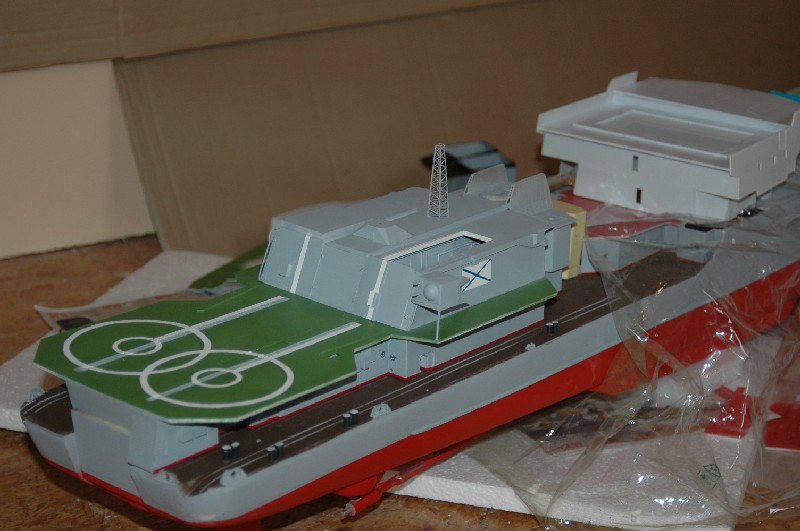

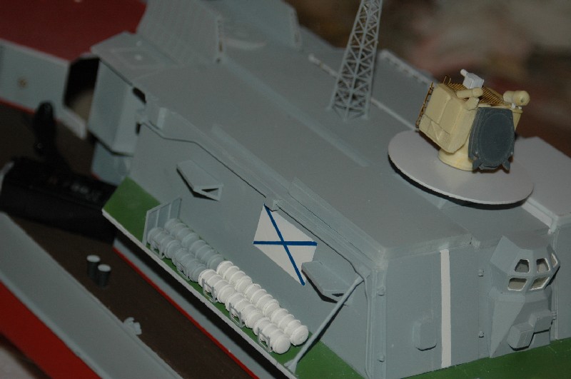

Here is a small update. the helo pad markings were done next. The straight lines along with the flags on both sides of the hangar were sprayed white.
The circles were/are a problem. Decals weren't provided, so I stencilled them like we do on the 1:1 thing. Unfortunately the paint is much more liquid, so the result wasn't quite satisfactory. After some touching up with a brush it looks better, although not excellent. Two more lines, small ones going outboard from the large circles have to be placed afterwards.
I might go and search for some stickers like Dave did for his Kiev (although I doubt I'll find anything close to such stickers over here).
With those circles and the lines on the helo hangar doors I noticed the helo handling aid rails are too far apart. In reality the big circle comes closer to smaller one on the other rail, however if I increase the diameter they become so large that it wouldn't fit on the outside of the deck. So I chose to make them slightly smaller.

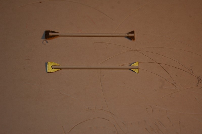

I'm pretty happy with the flags though. Next up are the stanchions which are shown in the second picture. The triangles are supplied in PE, they're supposed to go with some supplied steel stanchions, but I doubt it would be easy to attach them, so I chose to take a piece of 1mm styrene, make a gap in both sides and slide the triangles in. One of these stanchions is on port side, the other on starboard side of the hangar, after placing them I can start with the liferaft racks and liferafts.
Also the hangar roof is still remaining.

Tried to get started on the helicopter, with moderate succes, also did some more detailing on the Podkat radar to mount it on top of the hangar. And of course the tedious testing of the hangar roof top system. Practically it would be best to make the rails in PE to have them strong enough and fine enough. However I'm making it from styrene and hence it's a little oversized and weaker (strengthened it with some PE bars and CA to keep it stronger though). But ok, I'm ready to pay that price for an opening hangar. :heh:
On the particular period I'm modelling Tributs, she had two grey liferafts on each side, mounted like they are on the model. I guess they were repainting them underway, because pictures of slightly later show them all white.
