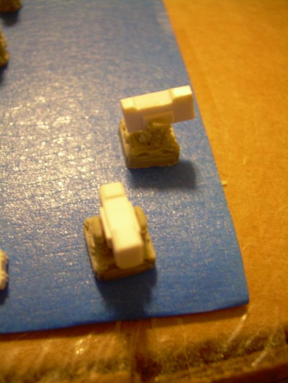

So here is the CEC com dome as is equipped aboard the Ticos, Phalanx Block 1B and a bunch of other stuff you have see on here before. Here we have our aft SM length VLS positioned aft. Maybe it would actually be "strike" length like in the Ticonderogas. Likely SM-2 length. Here are the "modern" helo deck markings that would be expected aboard the helicopter decks of the modernized Spruances, as are on the Burke DDGs. The Mk71 and VLS pads are ready for paint. Everything aft ready for paint. Phalanx Block 1B ready for paint. SPG-51s needed a little more detail added. As one knows, the tiny resin pieces wind up breaking off, and one has to replace them. I had to do the same with the SPG-51s. I am anxious to see how this winds up! The RAM lauchers will be put on top of the A/C vents. The structural members are installed in the intake stuctures so you really can't see them, so it just looks like they are sitting direcly on top of the A/C intakes.
I am looking forward to paint on the pieces tomorrow, guys.
Comments are welcome!

Thank you very much for the complements! I am sure you can tell I am being very careful. I still like your WIF example of a patrol boat with the battleship turrent on it. There was a real-life "monitor" proposal that would have put one of the turrets from the George Washington (BB-56) on a little mothballed DD hull. How rediculous!carr wrote:Dave,
At the risk of being repetitive, what nice work. Great job! This is what a WIF should be. Well reasoned, solid research, and great execution. Looking forward to seeing more.
The bit about the launchers on top of the vents with the support members inside, caught my attention. I wouldn't have thought of that. You're comfortable that the supports wouldn't significantly interfere with the air flow?
Keep up the good work!
Bob
I have been thinking about the air vent thing for a while. I think there an easier way to do it and not mess with air flow! I guess the best thing of best things to do is to actually make a chair/platform that stratles the vent so you don't have to do all kinds of fancy internal reconstruction. I think the platform's legs would go down the corners of the vent and a large plate would sit on top so the entire thing could be lifted up and away if the vent needed to be removed. Also, if I am right, that vent might actually be the access to the turbine engines. The Sprucan and Kidd-men know for sure.
Thanks, Bill. The really funny thing is that I am using a stupid, little, 6 year old Nikon Coolpix L4...because it takes better pictures than my Olympus E-500!!! The E-500 takes better pictures of Iranian forces at 3-5 miles with a 300mm lense, though. The lighting is my biggest enemy.Bill Liebold wrote:David,

You are correct, Bob. RAM launchers are a direct adaptation of the Phalanx system. Instad of having a gatling gun, ammo, computer, and radar pivoting between its legs, it just has a giant missile box. As a result, RAM is just as much as plug-and-play system as Phalanx. New construction has the controlling motors and all under the deck-work. Add-ons like on most existing ships, they literally install power plugs and cabling, and there you have a RAM mount...anywhere it will fit.carr wrote:The RAM launcher seems to be a self-contained item that requires no sub-deck installation (I may be wrong about that). If so, what about a deck-edge mounting? I've seen photos of RAM's mounted at the extreme aft corner edge of the fantail/deck on various ships. Maybe a bow and stern main deck-edge location? I've never seen one mounted in a forward position - wonder why?
Bob
Now, as to why there's ever one on the bow is beause you take so much water over the bow that you don't want anything up there. Not even machines guns do well up there. The bow takes so much vilolence anything electronic would pretty much be ruined.
Something I did consider, however, was keeping the RAM position aft like you do see on some Spruances and adding one up top on the super structure somewhere for the forward and aft coverage, perhaps on the port side of the bridge while Phalanx is on the starboard. I do like the idea of keeping them all up on the super structure, though.
Thanks for the idea!
