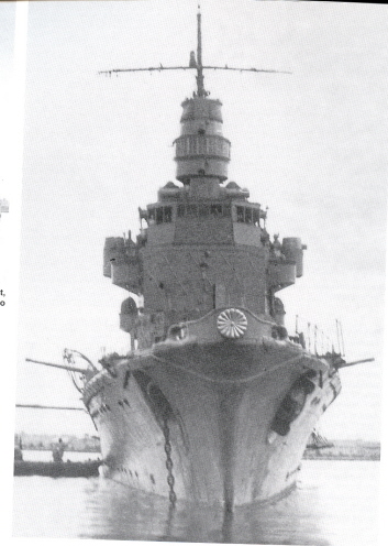

Naka 1942, via Fukui. One of several of her after being torpedoed. DOn;t think she changed much, aside from AA into 1943

Another photo of Naka from Fukui, 1942
