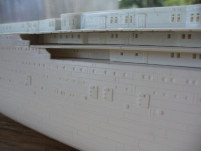

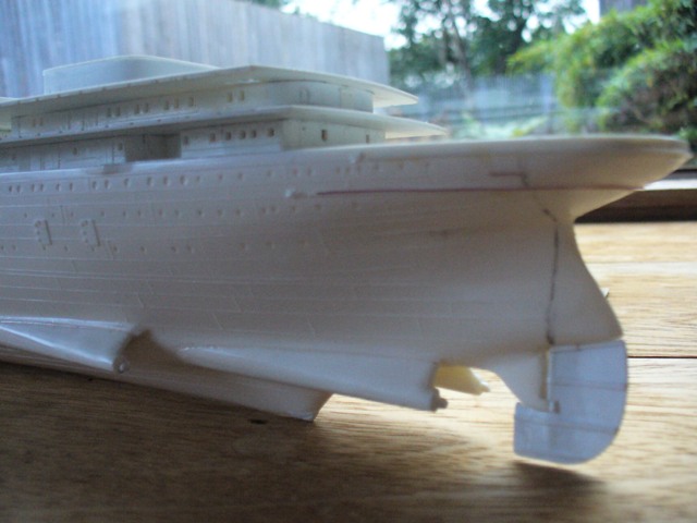

I've completed the first phase of my conversion of the Mr. Hobby (Gunze Sangyo) 1:350 kit into a credible Mauretania. He're some pictures included.
The most prominent changes are:
reshaped stern (poop is the better word I believe)
new scratch rudder
reshaped stem (sharper, more angular at bottom)
reshaped anchor wells (triangular, Lucy's are D-shaped)
larger bow bulwark
and completely replaced all decks, with Evergreen 2020 V-grooved plate, backed with 1 mm sheet for the Shelter Deck and 0.5 mm sheet for the decks above. I corrected and increased the width where necessary, this giving a considerable difference with the kit parts.
I used the sidewalls supplied in the kit, with suitable modifications along the way. As I don't have detailed plans about the window layout I accepted this for the time being, but all the decks are still accessible and I can change the windows as more info becomes available.

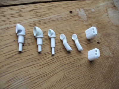

Further I scratchbuilt some parts: the larger and middle sized ventilator cowls, to be cast in quantity by a commercial resin casting company. The small ventilators with the slant necks at the front of the 2nd class Boat deck (unique to Maury, Lucy had no vents there) I made too but I'm not sure yet to have them cast. Also made the deckhouses over the engine room ventilation shafts, slightly different from Lucy's (smaller and rounded).
Well I'm looking forward to your comments and suggestions!
Maarten
