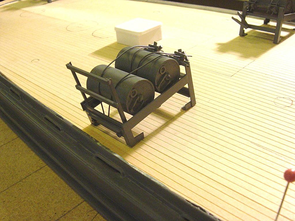

Hello again all! :wave_1: Work continues on the 83. Now that the pilothouse and shields are fabricated for the most part, I decided to move on to some of the weapons carried aboard. Namely, the depth charges and racks and the 7.2" rocket projectors, commonly known as "mousetraps". More work has been done on the pilothouse as well as the rest of the boat, so lets take a look..............
Here is one of four depth charge assemblies. There is one port and one stb. about midships, and two aft. These were fabricated from various sizes of strip and angle styrene, utilizing photos and drawings as a guide. The charges are cast resin from &quot;Macs Mouldings&quot; of the UK. Cable stays are thin steel wire. There are 53 parts to each assembly. This is one of the aft racks.
Here is one of four depth charge assemblies. There is one port and one stb. about midships, and two aft. These were fabricated from various sizes of strip and angle styrene, utilizing photos and drawings as a guide. The charges are cast resin from "Macs Mouldings" of the UK. Cable stays are thin steel wire. There are 53 parts to each assembly. This is one of the aft racks.
