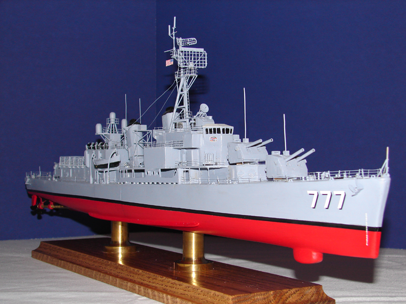

I have only scratch built one ship the USS Zellars DD-777 Sumner class circa 1960; scale 1/192. I used a plywood keel and basswood for nearlly all other facets of the ship, hull sections, super structure and such, only because those were the materials availble to me at the time. I am planing a build of the USS Independence CV-62 Forrestal class circa 1960. I have not settled on a scale as yet but I am leaning toward 1/350th. I have heard a lot about styrene but have never used it and wanted to get some input from more experienced modelers as to wether this is a good materail for the hull or is it more for super structures? Are there any books or other literature that covers working with styrene?
Here is the starboard view of the Zellars I completed last September. It was about 15 months in the making.

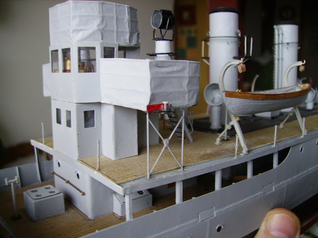

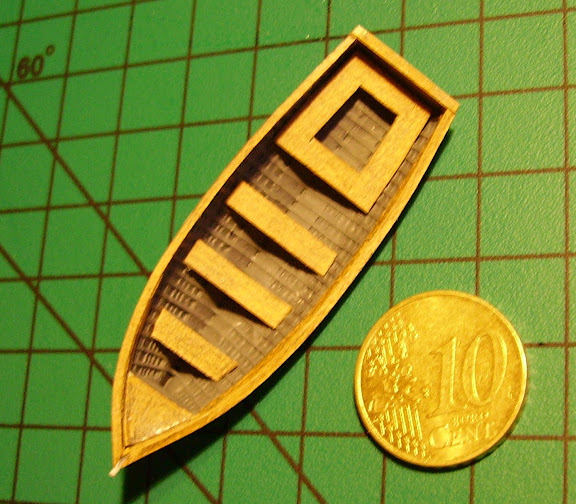

never thought to use paper & card? I use it instead of styrene, except for some rounded or square profiles. Glueing is easy, can be done with white PVA glue or with CA glue.
everything here under has been made out of paper & cardboard:
it asks for some skills, but you may give it a try, it's cheap ans more healthy for the lungs when working paper with white glue.
Laurent
