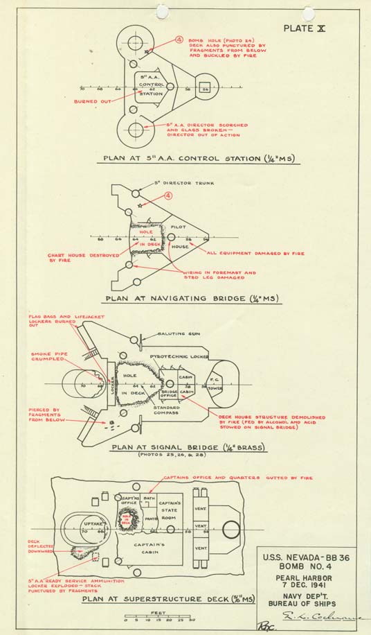

Aloha & welcome aboard! I'm a researcher who posts things from the national archives on my site (see the link in my signature). I have Nevada's damage report but have not posted it yet (planning a big Pearl Harbor update next month, but hers is large enough I probably will not get it done in time). Contained within the damage report are 12 damage plates, the most relevant of which (that I've reassembled) are below. E-mail me if you want to discuss further.
With regards to the camouflage, both were in Measure 1 with the Measure 5 bow wave at the time of the attack.

Thank you for the welcome, and many thanks for the plates. =) Some days on this path are frustrating and without results, others produce smiles. Thanks for the later.
