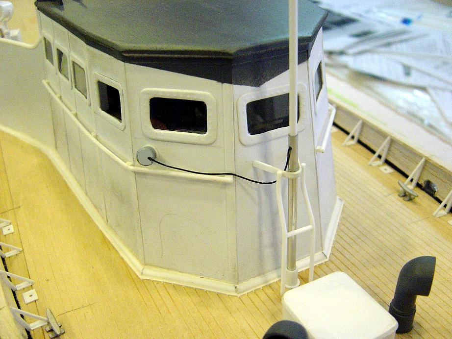

Hello again all :wave_1: Now that most of the sub-assemblies for the boat are completed, I decided to begin final assembly. Been busy with regular job, and this boat becomes more involved as I go along. It is however, coming together. Lets take a look at the progress to date......
File comment: I have now permanantly attached the pilothouse and spray shields to the deck. A few more details have been added to the pilothouse such as nav. lights, horn,RDF antenna, etc. As on the actual boat, a section of quarter round was added around the base of the shields and the pilothouse.

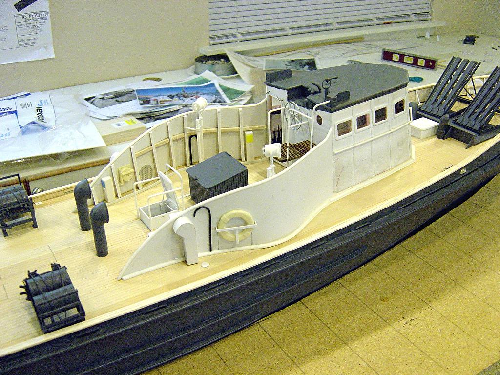

File comment: View here from portside. Note the seachlight / signal lights. These are a purchased part while the mount is scratchbuilt from styrene. Ships wheel is cast metal. Grating on flying bridge is laser cut basswood from Bluejacket. All railings here are fabricated styrene rod. Large grey box is life preserver stowage, scratcbuilt from leftover decking material and styrene. Large cowl vents are from a Haynes PT boat, in resin.

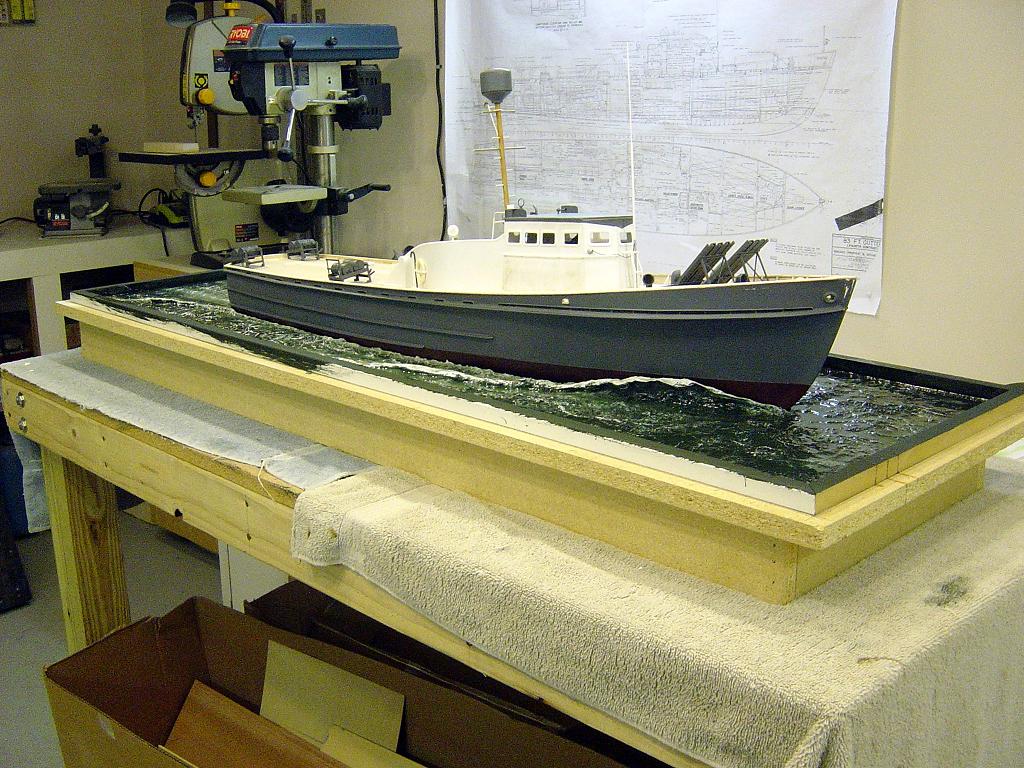

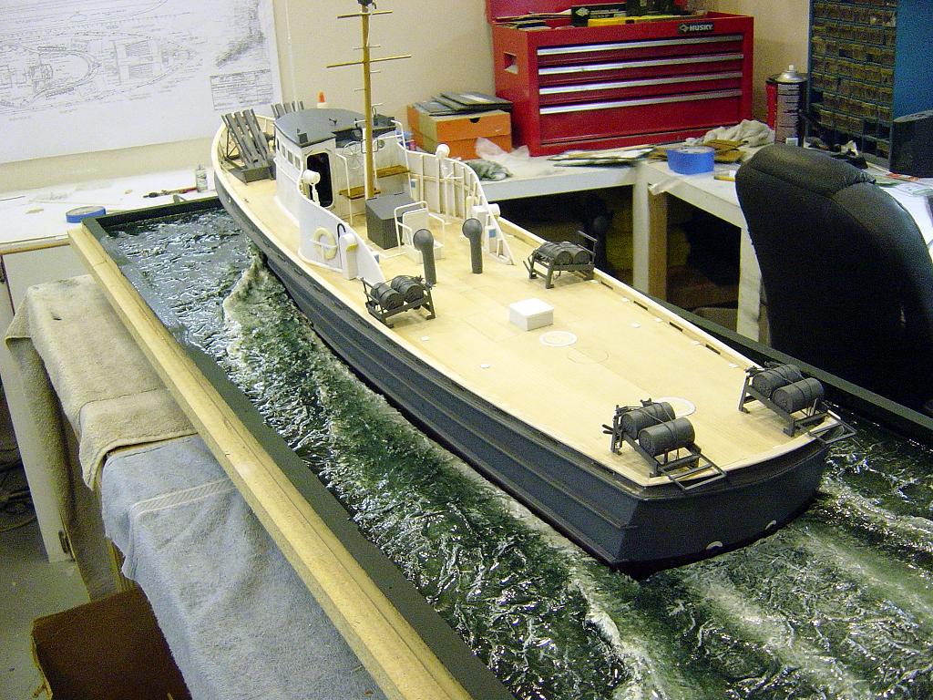

File comment: Now that placement of most items on the boat is nearing completion, I decided to try to model the water base. At this stage, the model is still removable from the base as final paintwork has yet to be done. Water not completed yet, but the following photos will give you an idea of the overall picture. I figure the boat making about 10 knots or so, thru relatively calm seas.
File comment: More to be added to the water such as spray, froth, etc. I'll do that later once the boat is completed. It is getting there!
Thats it for this update. On to final paintwork, decaling and more details! Stay tuned, more to come.........I continue on............. :wave_1:

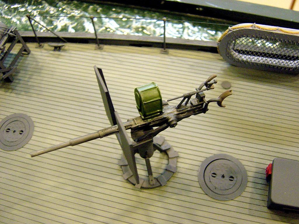

Hello again all :wave_1: I have now finish painted the boat, and I've fabricated and added more details. I have also worked on the water a bit more. The further I go with this the more interesting it becomes. I am becoming attached to it. :big_grin: They sure crammed alot of stuff on these boats. It's no wonder their top speed dropped 5 knots or so. Lets take a look..........

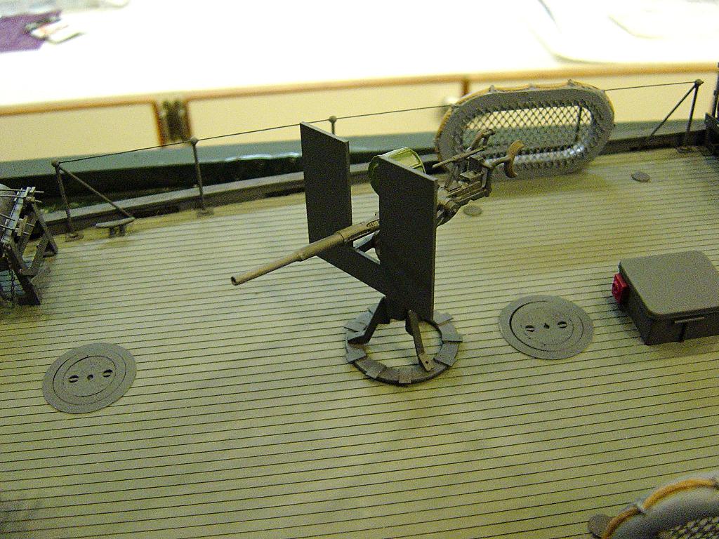

File comment: I'll start off with the 20MM gun mount. This is a combination of two small kits, one from JR Haynes, the other from Dean's Marine. By combining the two, I got the correct configuration for the boat.
File comment: Another view. I have since added a different sight, not shown here.

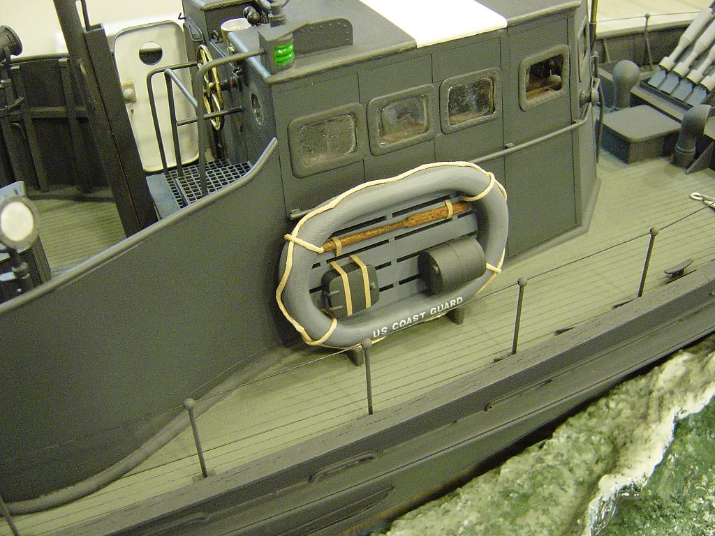

File comment: 10 Man liferaft here. One on the other side as well. This was completely scratchbuilt. The raft itself is a resin casting, the slats on the bottom are styrene, as well as the water container and first aid / ration box. Oar is basswood. Rope was added using waxed cotton cord. Finally the decals were added, letter by letter.
File comment: Heres the 5 man rafts, slightly smaller than the others. This is from Macs Mouldings. I added the mesh on the bottom. I'll also add oars and other items to these as I did to the larger ones.

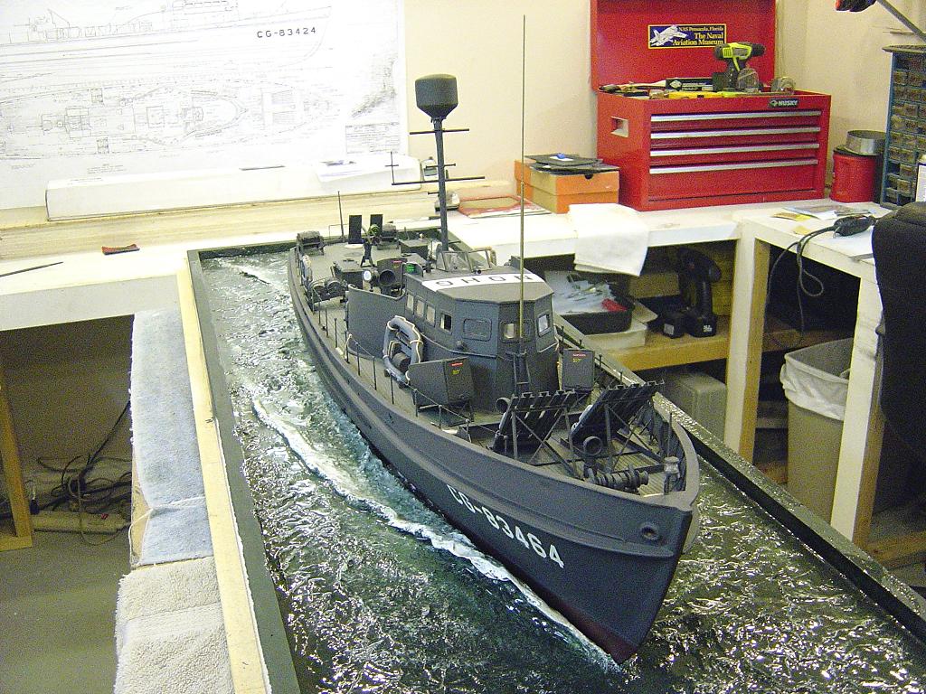

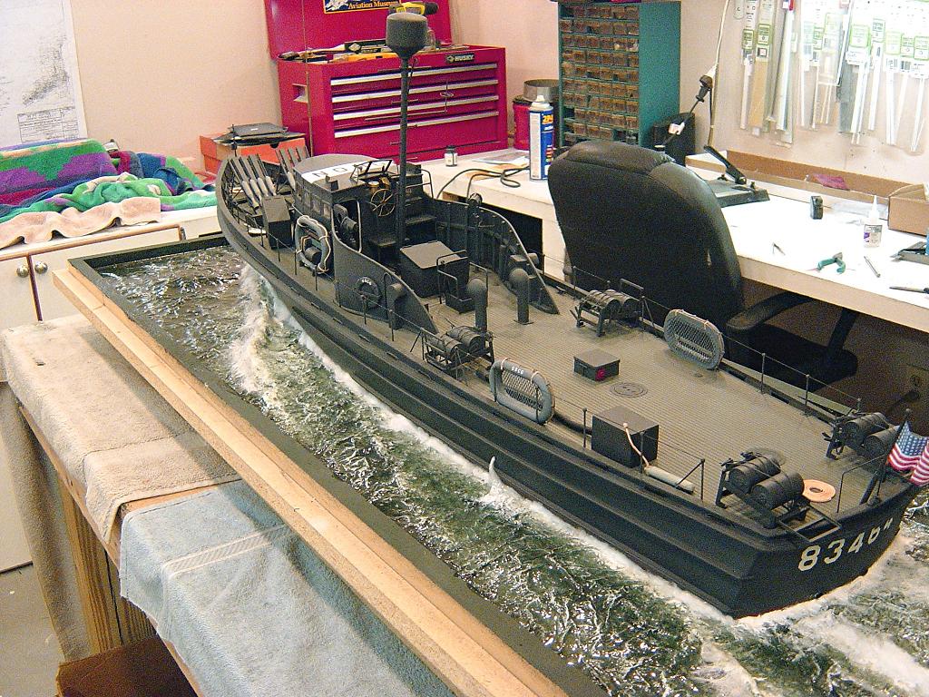

Heres some overall viws of the boat.......

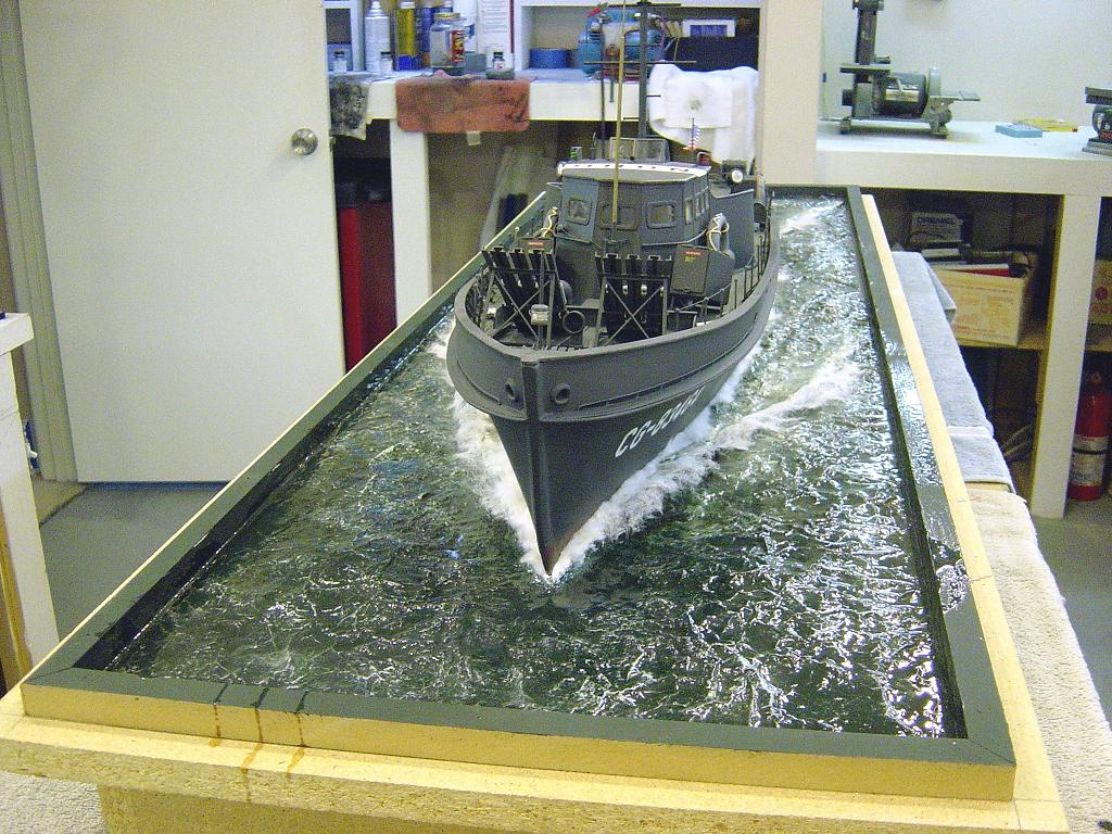

As I stated above, I have been fine tuning the water a bit. Heres some overall views of my tinkering.......
Well, there you have it. Getting close to completion. Stay tuned......More to come.....I continue on.......Comments welcome :wave_1: :thumbs_up_1:
