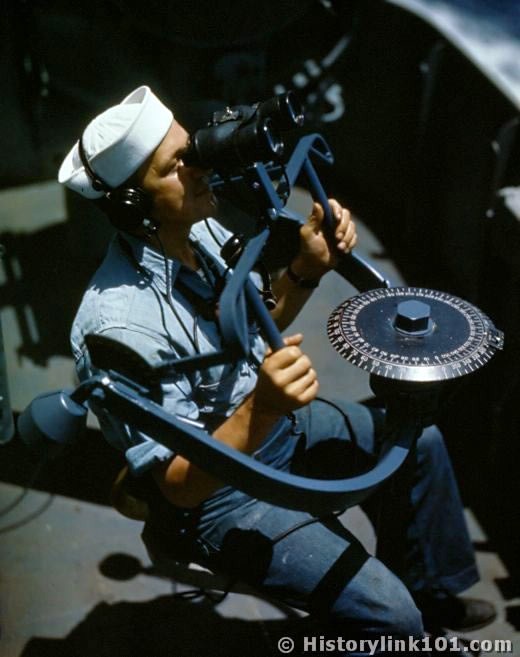

I'm trying to deal with the seated binocular mounts behind the spray shields atop the pilot house: parts K-1 and (PE) MA-2 and MA-6. The instructions are absolutely hopeless here, even with a magnifying glass! Rick's photo posted here May 29 helps some, but not clear enough on how to bend and attach those minuscule pieces of brass shimstock.
Any help? Drawings? Photos?

Does this help?
Russ
Solicitor
Post by Solicitor »
WOW! Yes!

I've seen two other photos in B&W, somewhere in the Naval Heritage & History Command on-line collection. They were two views of the devices taken in the design office. I'm kicking myself for not copying them to my folders. Floating Drydock has blueprints available.
Russ

Found this shot in the USS Slater newsletters. http://www.ussslater.org/
They'd appreciate any help in maintaining one of the last two DEs.

The Floating Drydock's Planbook of the Gearing and Sumner class destroyer shows a few images plus drawings of the sky lookout (called air lookout in UK parlance).
(This is a most useful reference if you want to build a US destroyer).
