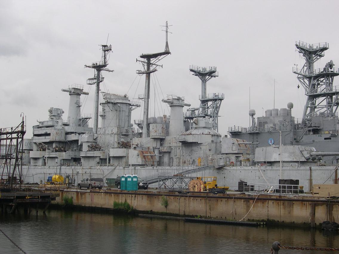

Here is a pretty good Comparison of ship size and mast size and type. Here we have Des Moines in the foreground and a Spruance behind her. This certainly illustrates how the mast/masts could be arranged on board.
While the original masts look pretty stout they don't offer a lot of diversity or room for expansion. I liked how NAVSEA drew up the mast on the original reactivation project, but I want some originality. The forward mast unfortunately cannot be like that of the Iowas in that the legs straddle the stack, because there is an expansion joint just aft of the mast. An idea is to just reverse it to where the legs go forward. Following that I would replace the original vertical pole and construct an entirely new mast instead of trying to incorporate the original one.
So, if you're still listening, Seasick, which is good for replacement of the secondary radar? I am thinking of the secondary radar being able to track air and surface targets and be able to illuminate for the ESSMs.

I have my sketches, but does anyone have an idea about masts? Should there be one, should there be two?
To repeat your list of included radars:
SPS-49 for 2D, long range air search
TRS-3D for 3D, air search
SPS-67 for short range surface search and nav
SPQ-9B for low altitude air and surface search
Questions:
*What is the range of the TRS-3D? I can't find a value.
*Can the TRS-3D take the place of the -49? It's lighter and smaller so it would be great to eliminate the -49, if possible.
It's probably possible to fit all these radars on one mast, however, you absolutely want two conceptual masts. This is a ship designed and intended to step into a fight and stay in it. So, you have to account for combat damage. Having all the radars on one mast is asking for an unlucky hit to take out all your main sensors. Thus, you need to spread the locations out which means, conceptually, a second mast. Now you don't need an actual second physical mast; you could simply mount radars on top of superstructure housings spread across the ship, if that's possible within weight and height requirements.
You also want redundancy in the sensors. While I realize that each main sensor can, to a somewhat limited extent, provide the functions of the others, why not have two -9B's and two TRS-3D's as widely separated as possible. The additional incremental cost is minimal and skimping on the cost to provide some of the main components that are needed in combat would be foolish. This is a fighting ship; give it what it needs to stay in the fight. Again, this is a strong rationale for having two masts, basically mirror images of each other.
You've already stated that you don't need Aegis or even NTU for this ship because it will be in company of other ships that will provide the "big" picture. With that said, my suggestion is to eliminate the -49 and mount (2)-9B and (2)TRS-3D on two widely separated masts.
If you want to stay in the fight, have redundant sensors on two widely separated masts so you don't have to cut and run after the first unlucky air burst.
Here's the wrong way to do it. The Burke has all major sensors in a single, tight location.
Here's almost the right way to do it. The Spruance has a forward mast located as far forward as possible and a second mast with decent separation. I'd try to move the aft mast even further back.
I realize that the Navy doesn't design "war" ships anymore, just floating missile platforms, but you're attempting to design a true warship. Do it right! You're already breaking with tradition so keep going and give your design what it needs.
Bob

I agree with carr's assertion that two masts are necessary for combat redundancy. I had originally figured on putting a second heavy mast aft of the stack supporting the 3D SPS-48E/G radar. Hoever perhaps something as big and cumbersome as a SPS-48 is unnecessary when there is another 3D radar that suits the ship's uses a little better, the TRS-3D. Being able to reach out to 50+nm, the TRS-3D is very small but very high powered and effective for its size. For a radar of it's size I would like to put both a second SPQ-9B and the TRS-3D and a pair of domes housing comminications equipment in them on a mast similar to that of the Ticonderoga-class's forward mast. The mast just needs to stand tall enough to see over the aft fire control tower.
