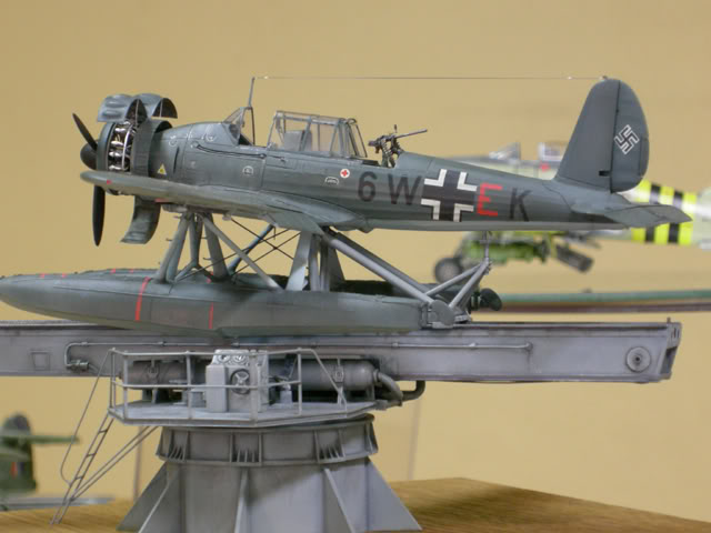

Will you be using the Heller 1/72 scale models for Bismarck ? You can modify the kit and have detailed cockpits and engines .Other than being more stable , 1/72 scale has the advantage off having detailed aircraft available . :woo_hoo:
Happy new year :wave_1:

Hmmmmmmmmmmmmm!
Lovely Arados.
Yes, they are Heller.
I had other makes but was advised on Heller so exchanged them.
The rest WEM 1/72 Bismarck Class Catapult Ref: PE 7247.
