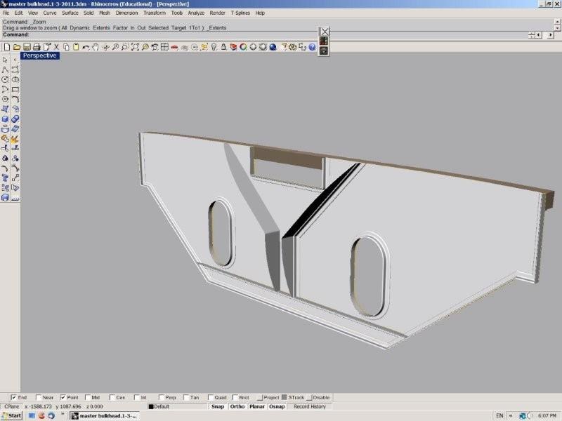

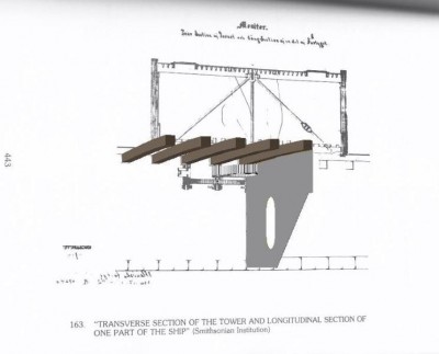

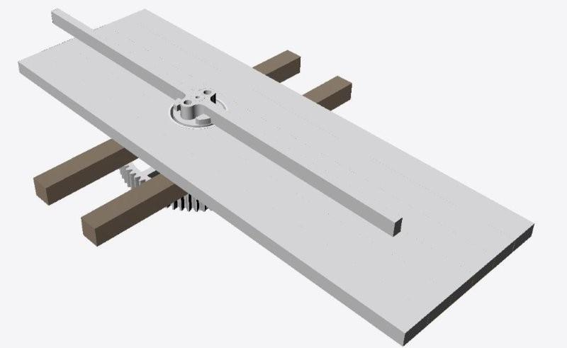

Made a beginning on a part of the USS monitor that I have not seen modeled in much detail: the turret drive mechanism. I am using Rhino3D. Line drawings of the various components were scanned from the book, Drawings of the USS Monitor, by Capt. Ernest W. Peterkin.
USS Monitor decking is aligned with the long (roll) axis of the ship

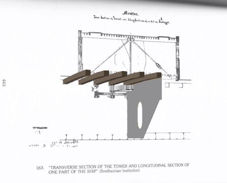

The monitor was planked with 7"-thick pine, and the above sketch shows the how the turret drive mechanism penetrated this deck. The brown oak deck beams run beamwise, and the turret support beam is shown aligned with the long axis of the USS Monitor.
view with the deck layer turned off, showing oak beams

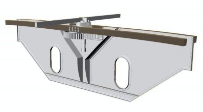

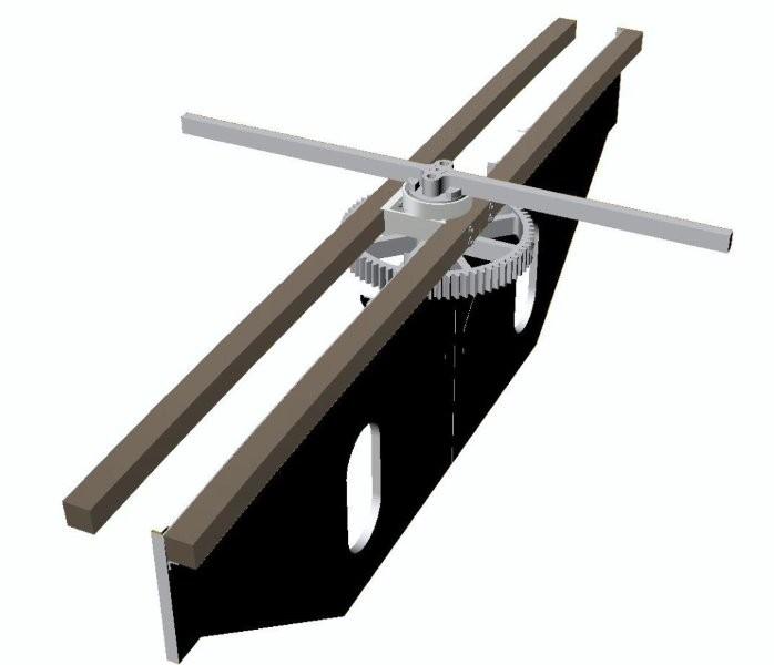

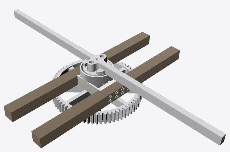

If we subtract the pine planking as shown above (by turning off the layer) the cast bearing and its oak beam supports become more clear. The bearing was cast in one piece, and mortised into the oak deck beams. It was further secured by bolts through the deck beams.

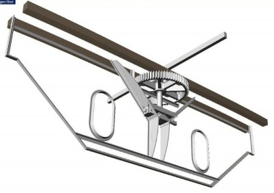

view of machinery with deck beam layers turned off

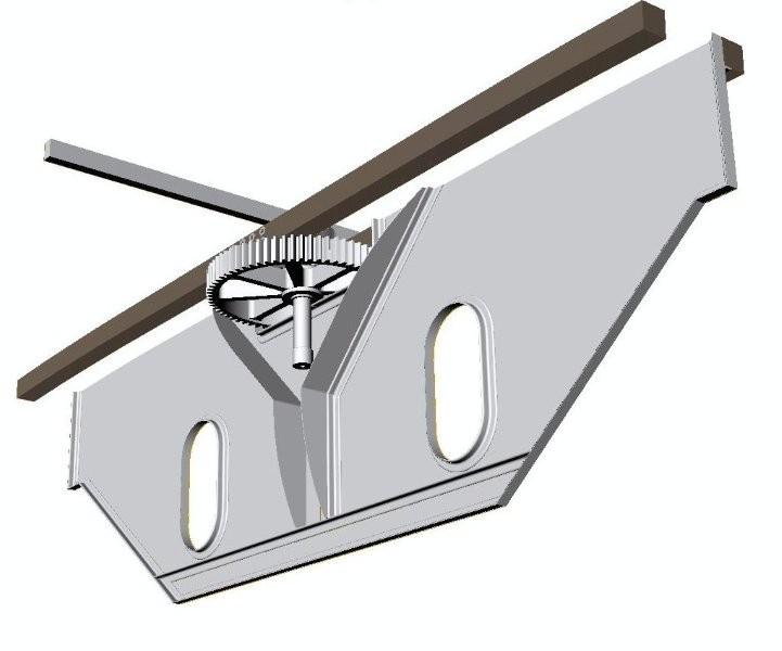

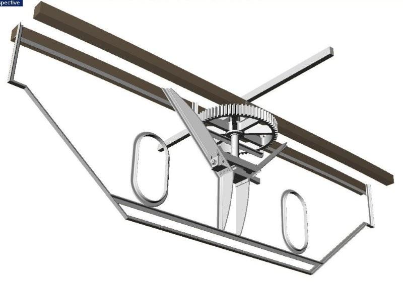

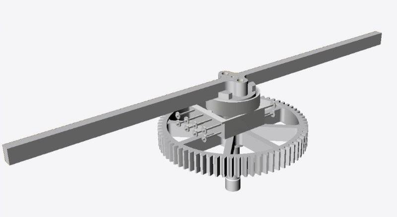

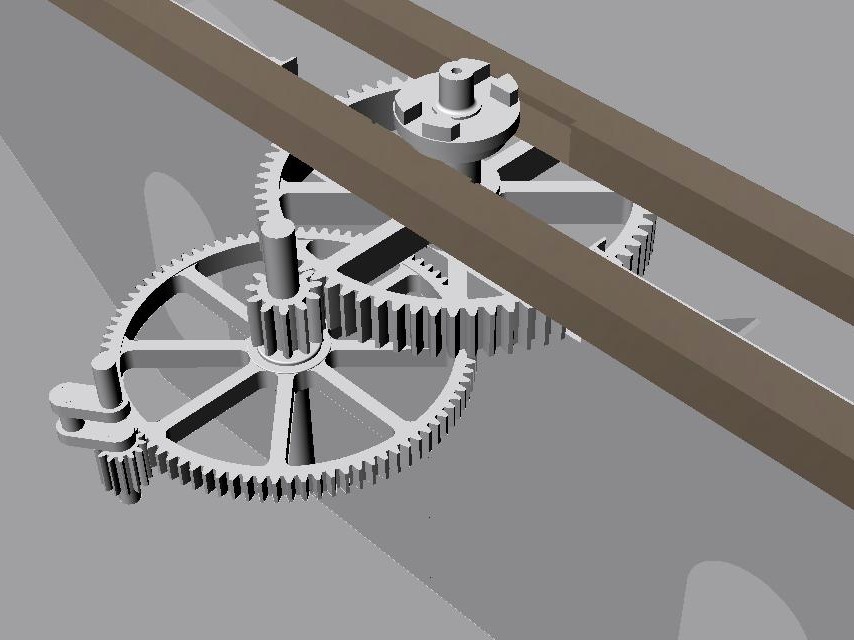

Finally, if we turn off the oak beams, the bearing and drive can be seen whole. Note that the toothed drive "clutch" appears to cradle, rather than lock or rigidly secure -- the turret beam. The turret contained two 8-ton Dahlgren guns, and these were on rails to permit recoil and running out. It appears to me that with so much mass in motion, Ericsson may have decided to simply let the turret rock a bit. The outermost rim of the turrret was supported on a brass bearing ring.
The gear itself is sized and toothed per the drawings and specs, but the spokes are conjectural.
Next step is to finish drawing the central bulkhead and the fittings that supported this whole system.

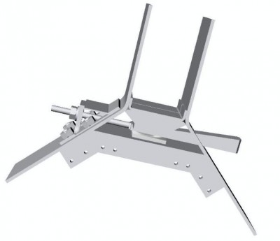

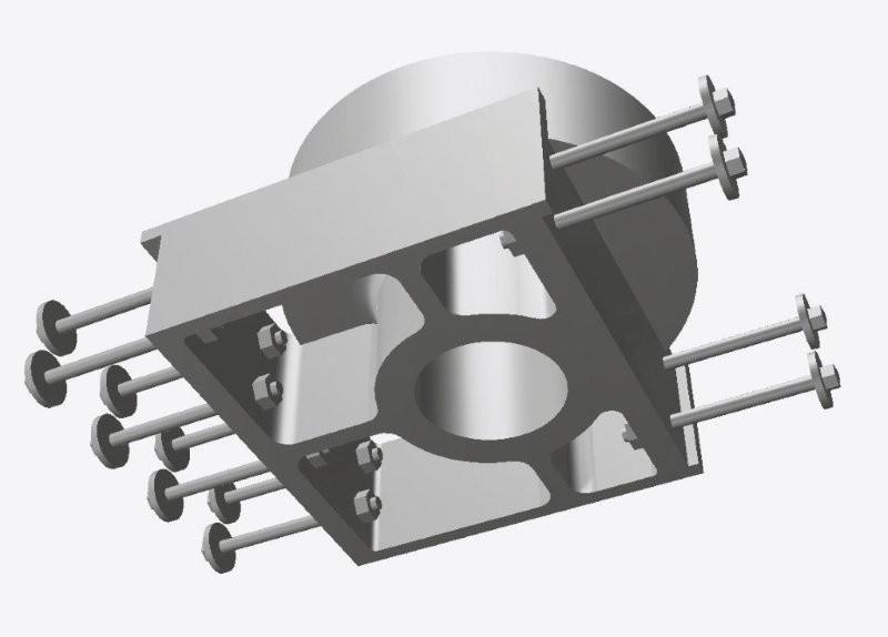

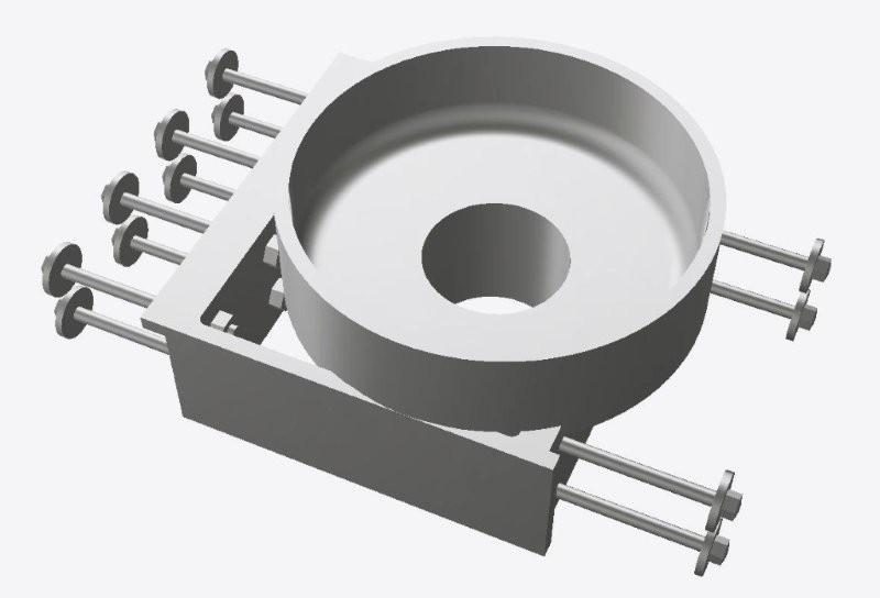

Here are two views of the cast bearing viewed in isolation:
casting seen from above
casting as viewed from below decks
Notice the horizontal and vertical flanges. The flanges, and the front of the bearing "cup" were mortised into the oak deck beams.

Thank you for your encouragement. To put this in context, here is a sketch of the turret bulkhead.
Turret bulkhead, forward side
The casting for the turret bearing, shown in the posts above, was bolted to the middle of the oak deck beam backing the bulkhead. The turret shaft descended on this side of the bulkhead.
The oak deck beam was flat under the turret, then tapered off slightly toward the edges of the deck to form a mild turtle deck. The cutout in the top of the bulkhead is for the main turret gear. The "butterfly" flanges flank the turret drive shaft. The butterfly structure is one of those features that is shown in many drawings of the USS Monitor, but I didn't quite understand what it was until I worked it out in 3D.
Shipyard tracing of Ericsson's plan
This model is being assembled on a contemporary shipyard tracing of Ericsson's original plan. Thomas Rowland was co-owner of the shipyard (the Continental Iron Works), and the tracings were kept by his family. In general, they are sharper and more legible than Ericsson's work, particularly in the legends and captions.

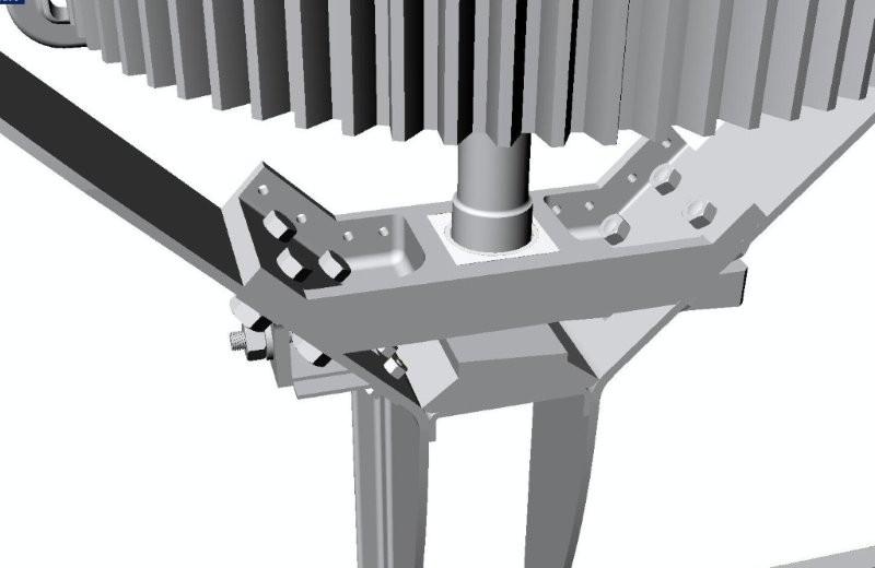

Here is the turret drive shaft and bearing box in position, mounted at the bulkhead.
Bulkhead viewed from below, looking aft.
Seen from above, from the kitchen side of the bulkhead
The bearing box was notched and bolted between two oak deck beams.
The oak deck beam seems like a large clear span in these screen captures, but it was additionally braced by two columnar stantions mounted just outboard of the doors.
Noticably missing is an anvil-like fitting Ericsson mounted at the narrowing of the butterfly flanges. This fitting supported the turret shaft -- and could be used to jack the turret slightly off the deck. It is an intricate chunk of machinery and I am still working on it.
In general, the materials and methods of 150 years ago are very different from ours. They integrated wood and metal in interesting ways. The wood was milled in sizes and shapes we don't often see any more.

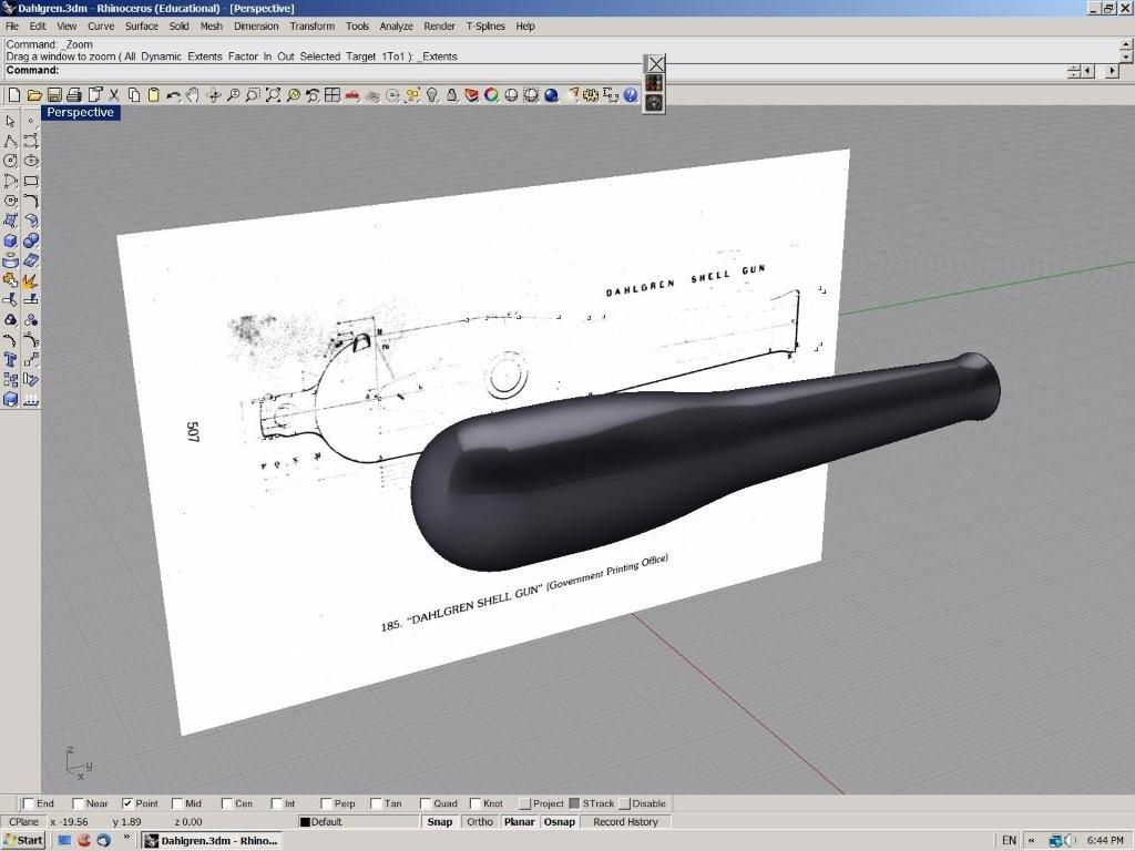

The basic shape of the Dahlgren, generated from coordinates.
The 11-inch Dahlgren
The Monitor's Dahlgrens were raised from the wreck and are being restored at the Mariner's Museum:
This photo is published on their riveting blog. http://www.marinersmuseum.org/blogs/ussmonitorcenter/

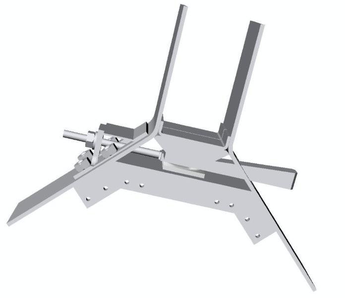

When the USS Monitor was under tow the whole turret was lowered so that it sat solidly on the deck. The turret had to be jacked up slighly off the deck to enable it to turn freely.
Here are some sketches of the turret jacking mechanism.
The components include a boxed bearing that supports the turret shaft. It is poised above an anvil-like casting, and between these two parts slides a long wedge. The wedge is pulled to the left by a threaded shaft 2 inches in diameter. I have not yet filled in the threads. Notice in the drawing above that the wedge slides within, and is positioned and guided by, a square hole cut in the butterfly flange.
Note that behind the jacking nut there is an elongated vertical slot, shown here viewed from the bulkhead side of the assembly. This slot allows the shaft to rise slowly in the plane of the wedge as the nut is tightened. The top of the wedge stayed horizontal. The height of this slot puts a limit on how high the turret could be jacked up off of the deck. If you make the measurement in CAD, the full range of vertical motion appears to be 1.75 inches, but from the resting position as drawn by Ericsson (with the turret decked) it is slightly less. Maybe 1.5 or 1 5/8 inches.

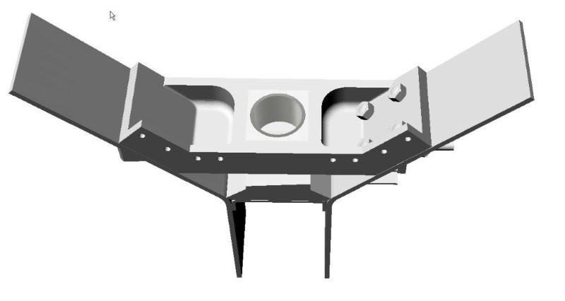

The bearing box for the turret shaft is positioned by a massive V-block casting, shown here from above.
In working out castings like this one in Rhino3D, I find it is easier to draw the plug first, as if to make a model of the mold. Then do a Boolean subtraction from a simple V-block solid to achieve the look of a casting. It is a process that is sort of similar to the work they did in crafting the original molds 150 years ago.

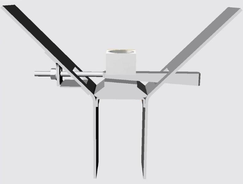

Here, finally, is a view of the assembly flipped upside down.
The jack appears from the drawings to have been a one-way device. Rotating the nut clockwise raised the turret, but rotating it in the other direction just backed out the nut. To lower the turret (that is, drive the wedge to the right) I think I read somewhere that the sailors used a sledgehammer.

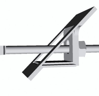

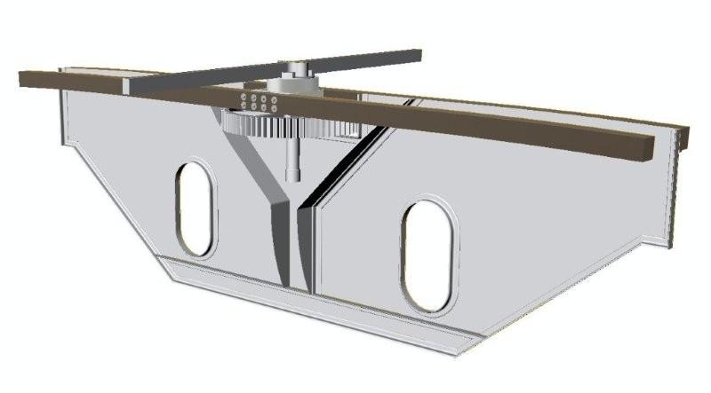

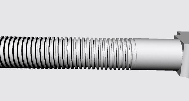

The turret elevating wedge, which Ericsson called the "key", has a 2-inch diameter shaft, and it is threaded at 3.75 threads per inch. I cut these threads using an old Acme profile, because it looks something like threads on a part the divers have brought up. But this thread profile is conjectural.
Here is an overall view of the turret bulkhead frame. The 1/2-inch bulkhead sheet is turned off for better light.

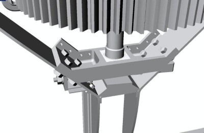

Finally, here is a detail shot of the massive V-block casting as mounted to the bulkhead. Each of the 8 main bolts securing it to the butterfly flanges is 2 inches in diameter.

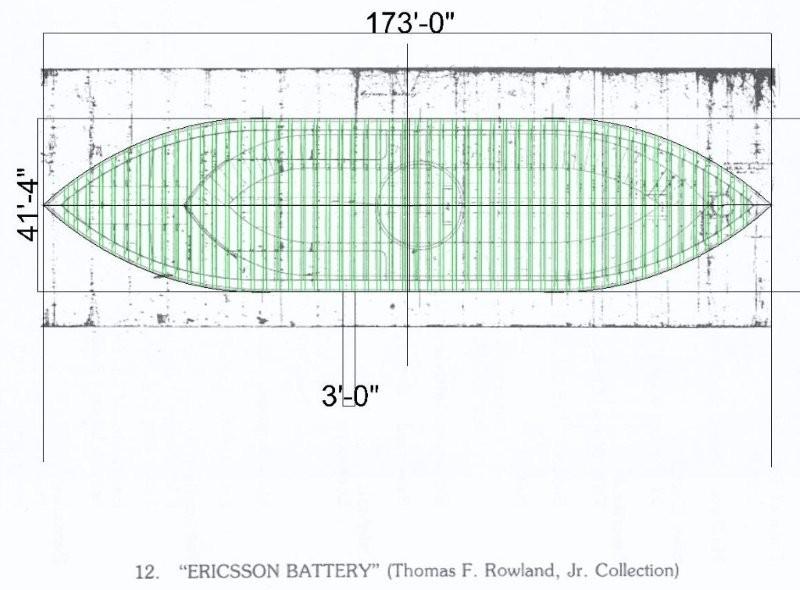

This is an overhead view from the shipyard's tracing of Ericsson's layout. The drawing is near final and the basic dimensions are as built.
I drew the oak deck beams as an array. They are spaced at 3-foot intervals, if we use the face of each 10" deck beam as a marker. If we dropped a plumb bob from the face of a deck beam, then directly below it, spanning the bottom of the ship, was positioned a floor "timber." These timbers were in fact iron sheets transformed into I-beams or C-beams using angle iron. They were also positioned at 3-foot intervals.
The ship's outline is perfectly symmetrical. I drew only one arc and mirrored it to draw the hull. Parenthetically, there were two 12-inch oak beams at the pilothouse. I don't see that these two heavier beams altered the 3-foot period of the beam spacing, however.
The beam spacing makes it possible to "good eye" the spaces within the ship, since the oak beams form a ruler marked off in 36" increments. The galley space we are now concerned with was rather like a tunnel, shy of 8' from the bulkhead wall to the boiler backs. But it was a long tunnel, spanning almost the full width of the vessel. The curved lines behind and outboard of the turret are the walls of the ship's coal bunkers. There were two passages running along these bunkers between the galley space and the engine room, one on either side of the boilers.

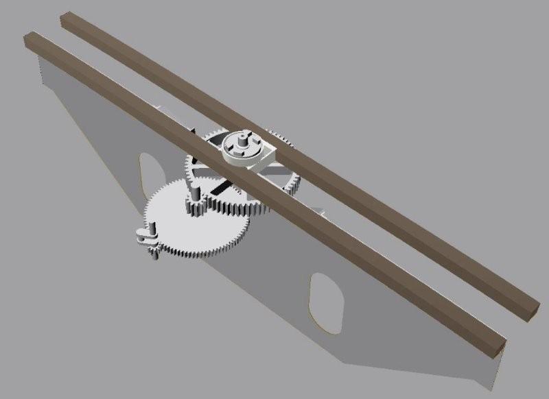

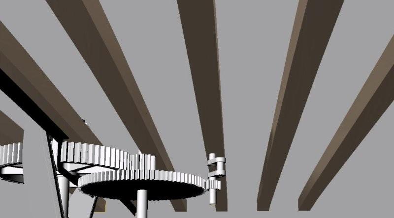

Here is a view of the turret gear train, seen from below. The bulkhead has been turned off for better visibility.
. Here is the same machinery seen from overhead, with some deck beams turned off for better visibility.
Basically the drive train is just four gears, two spurs and two pinions. Power is to be applied at the crankshaft by a pair of "donkey" engines. The two cylinders were mounted in the form of a "V" just above the 2nd spur gear. The engines have not yet been sketched in. Quite a bit of other detailing to come, including spokes for the second spur, hubs, more precisely trimmed shaft lengths, pillow blocks, gearbox structure etc. But this is the core layout. As noted the gears were recreated from a table of specs. There is a free plug-in for Rhino3D that makes gears out of specs, so this was a straightforward job. Michael

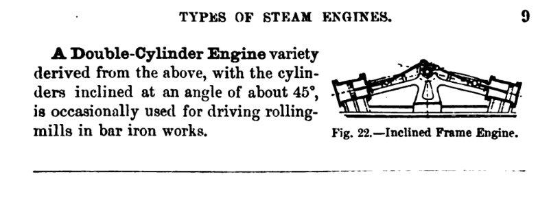

Here is an illustration from a handbook of steam engine practice published in the late 19th century.
The V-twin engine's quality of quick and reliable reversing may have encouraged Ericsson to use one to turn and to quickly reverse the Monitor's turret. The V-twin was made for the USS Monitor at the Clute Brothers' Foundry in Schenectady, NY. It would be interesting to learn if they also manufactured and supplied engines for rolling mills and, above all, if they published an illustrated catalog. For CAD, an actual picture of a similar engine from the same manufacturer would be a great help.
