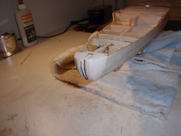

hello all fellow modelers,been working on hull frames.the bow and stern of the center board has a piece of heavy styrene added for the last little bit,this makes it easyer to make the transition to the bow.the frames and center board are slotted ,the frames from the bottom and the center board from the top,this allows the frame to slide in from above.there are 28 hull frames to cut from 1/4"plywood.it is tedious work cutting them,i broke 3 blades ,it is just about impossible the get all 28 frames perfect,if they end up to big just sand them down,if they end up a little small i just glue a piece of styrene the right thickness on which ever side needs to be wider.this is easyer then cutting a new frame,i use plain old white carpenters glue to attach the frames to the center board.before the planking can start the center board has to be fastened to somthing to keep it true,i use a board,make sure it is flat no twist in it.the center board only has to be held steady for a few planks .then it can be taken off to make it easyer to work on.

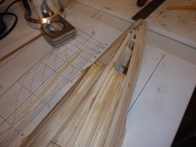

just a little update.i have fitted balsa blocks in the bow and stern,and planked the hull. the planking stops where at the prop shafts start to pull away from the hull,i will drill a hole in the end and then fit a shaft in then try to fiqure out how to make the rest of it.that will not happen till the the hull is completly faired as it would be hard to sand in behind the strut assembly.next thing to do is mix up some epoxy and coat the entire hull this is not to fill anything it is to glue all the planks to the frames.it makes a gooey mess but this way i know that the planks will not spring.i paint it inside and out..oh first i rough sand any high spots in the planking down.if it ends up i little thin in the odd spot no problum as there will be a layer of fiberglass bondo that goes on, then after that fairing putty.

bow sanded down,you can see the styrene piece that was added .this makes it hard to sand away to much
well the hull is now very strong,after painting it with resin which stuck everything together,i now coated the out side of the hull with bondo which has fiberglass strands in it.one has to be fast here as it sets up in about 10 min..not much time to mix it and apply.it is not easy to spread smothly as you can see ,but all i whan't it to do is fill in all the low spots and sharpe edges,bondo glazing putty is what i will use to fair the hull.once it is set up i sand it with a power sander,it would take forever and a day by hand.the hull is now about 50%wood and 50% resin and bondo glass.next is to fair the hull it takes 3 or 4 apllications of glazing putty to do this ,it takes awhile.i ordered a couple of books ,but after 2 weeks i got a reply saying they are out of print .if anyone has info or pics of the bridge as of 1940-44 it would realy help,i have some, thanks to dave and a web site of volker weischenberg,but the more the merrier.

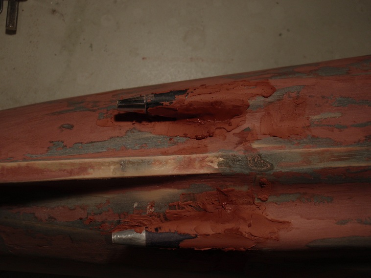

andrew it is simply amazing,how many times of filling and sanding it takes to get the hull fair.I am constructing the prop shaft tubes.I am a bit of a scronger when it comes to finding differant fittings and stuff, there is very little photo-etch or accesories in 1/144 .i spend a lot of time looking for things that look like the part i want to build,craft shops,dollar stores and the such.the prop shafts where right under my nose,ball point pens.i found two in the stash of pens that where out of ink,that matched up darn close to the real things,all i had to do was flaten one side to match the hull,redrill the hole to my shaft size and ,'bobs your uncle' it looked pretty good.i have two sets of plans but not one of them has the armor belt shown or plating,one shows it so high up that it covers the lower line of port holes.i know this is wrong,i have some pics showing the stern area ,but not the bow.i can fiqure out the length of it but the depth eludes me.any input on this would be very helpful.
this is the pen,trimed and drilled out to the shaft size
this is sytyrene that the shaft will slide onto
on the under side i gut a slot for the styrene to slide into
