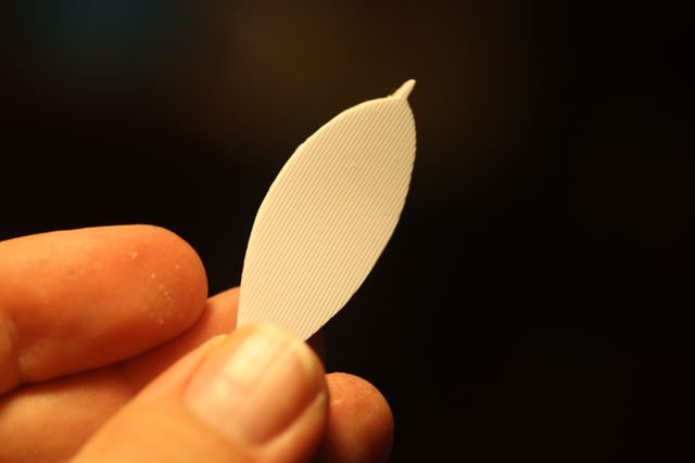

I had been haunting these pages watching other people do things and, on a whim took a stab, one more time at an original ship. I have always been interested in ships from different eras, and as I got more into the Hobby it seemed to me that the more remote a particular ship was from the usual model subjects, the more I had a desire to build it. I also thought it would be really cool to create a detailed Age of Sail subject in 700th scale. I decided I would start out with a Carrack, a high-charged warship from the 16th Century, partly because I thought they were exotic looking, and partly because I felt the lack of documentation would give me a little leeway in my first attempt at creating a ship from scratch.
This was my first pic. I didn't start documenting until well into the build.
Ok, so hopefully these pics will post and I can continue as I have begun...

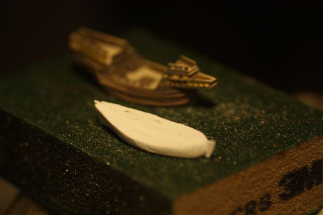

Funny you should ask about resin casts Carl... That plays right into a continuation of the story.

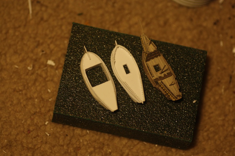

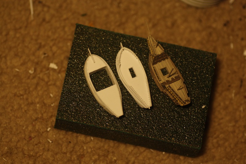

Here are some more pics
Soon after I reached this point I decided to take it to the IPMS club. One of the guys there is the renowned Rusty White of Flagship Models. Rusty looked at it for a second, and immediately talked about the problems and potential of selling it as a kit. How it would cast, what I would need to change in order to make it cast well. This was one of those moments this last year when my thinking about models suddenly began to open up and take on new directions. Still thinking about what Rusty said, I took it home, worked on it some more and showed it to my online friends Bruno and Jean (among others.) Bruno emailed me back saying 'I want one!' ...
Now I knew, because of the way I had constructed the ship that it would not cast properly (because of what Rusty had told me about the casting process) So what I decided to do was to begin again with a second 'castable carrack' that I could cast from resin and send the copies to Bruno and Jean. I was also hoping that Bruno would be willing to perhaps create some custom photo etch for it to help snazz it up a bit. But Bruno went much further...

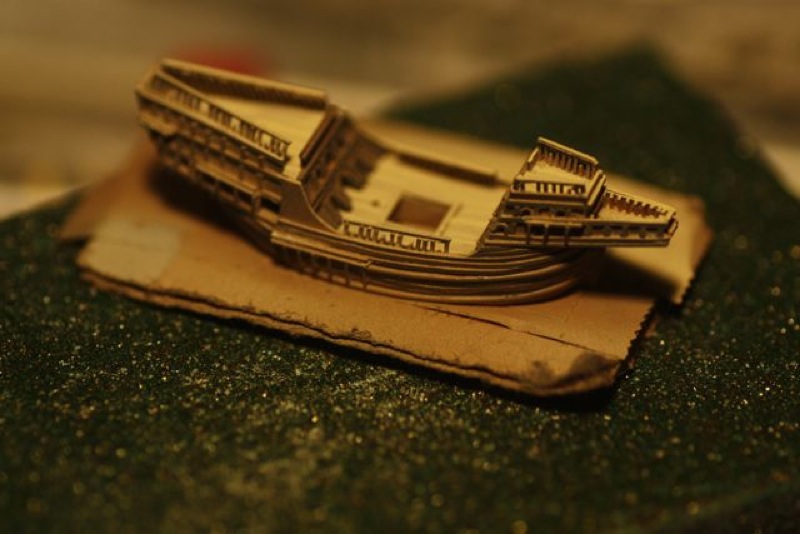

Here is the beginning of the 1st San Bruno. This shows the method I used for the construction of both models.

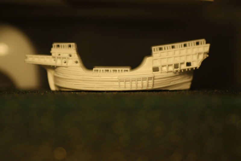

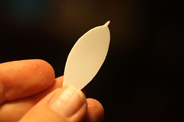

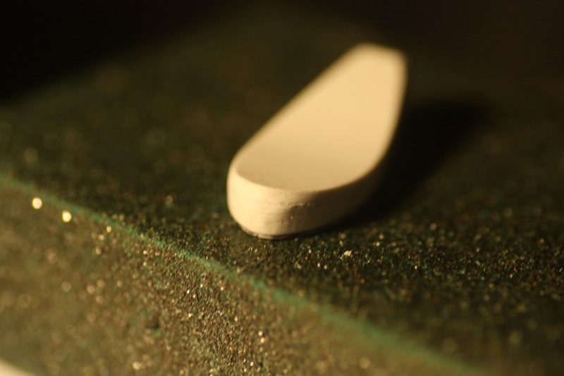

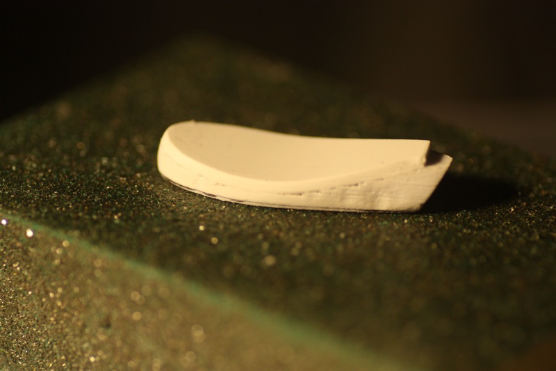

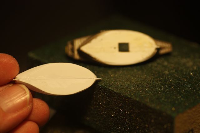

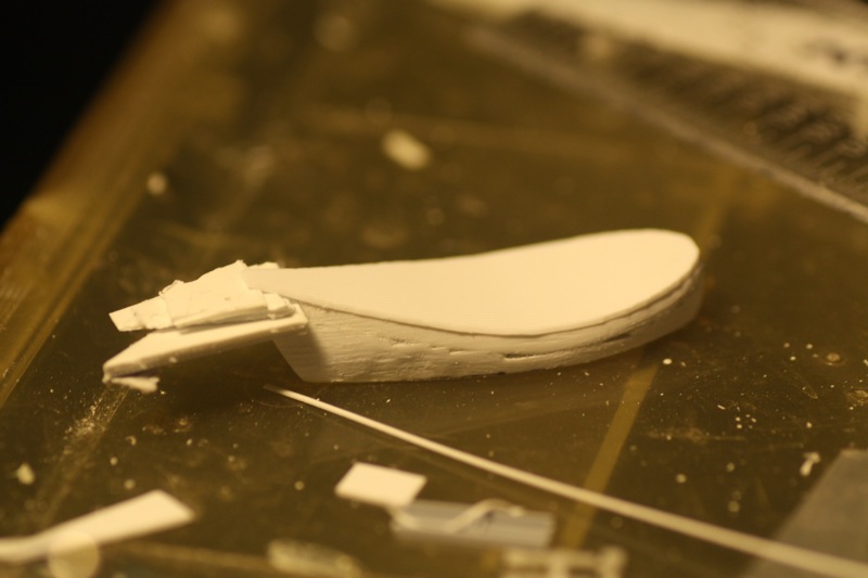

After creating the basic hull shape I took strip styrene 0.020 x 0.010 and began to lay it down in strakes along the side of the hull. After gluing each strake down I would cut the strakes into segments, being careful to stagger the cuts. The resulting effect looks like planking. It also looks as though each plank were individually cut and placed, which would be extremely time consuming, but that is not the case. Here is more of the 1st Bruno:
After planking the hull up to the level of the weather deck, I added 0.020 thick styrene around the edge of the weather deck to create gunwales, etc. These would be trimmed to shape afterwards.
Once that was done I continued the planking up the gunwales.
The next step was to carve out the hold.

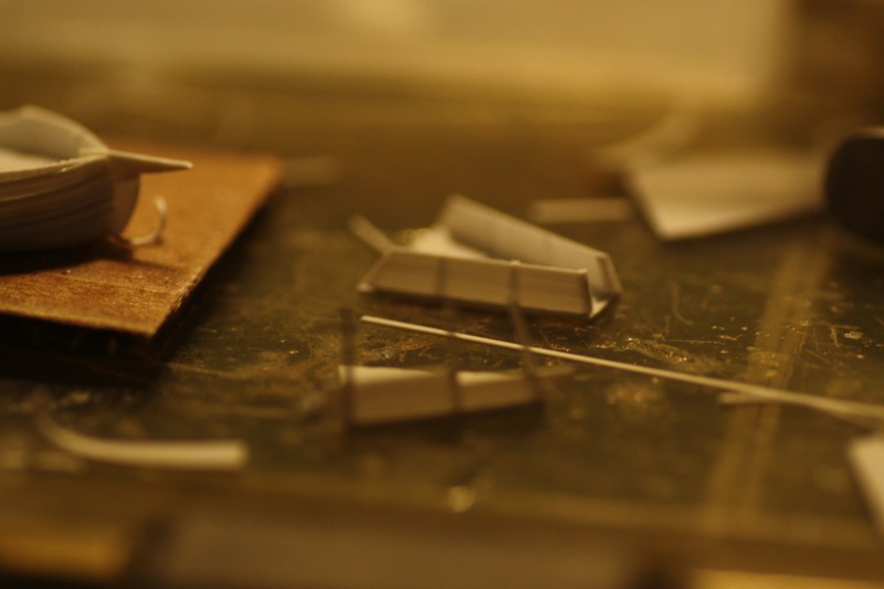

And then to begin placing the frame ends inside the gunwales. These are glued first and trimmed later.
Much easier and faster than trimming before fitting.

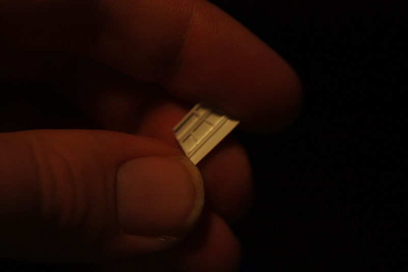

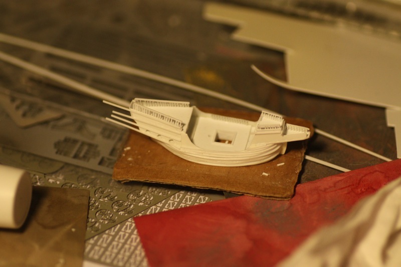

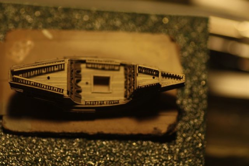

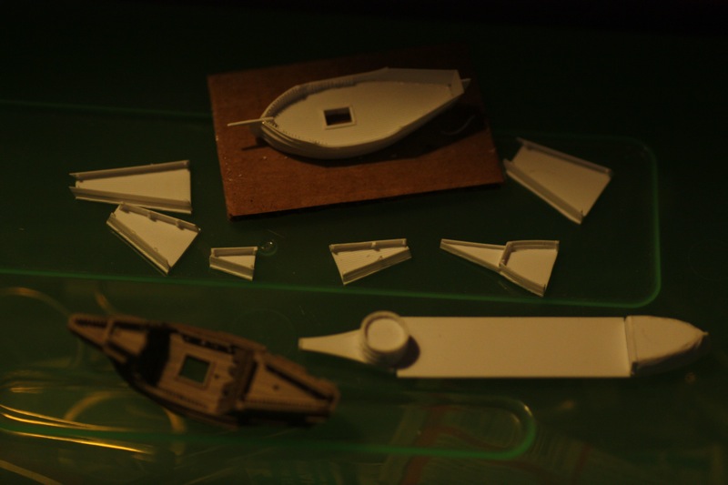

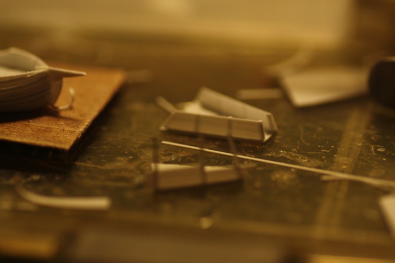

While I was working on the Bruno, I also continued work on the Beja, the original carrack attempt.
Unlike all of my previous scratch building attempts this was going really well. Part of what I liked about building these ships is they are almost completely styrene, which I enjoy working in. I was able to avoid having to use putty, for the most part, which was good, because I am not very good at it.

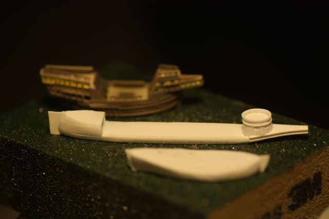

By now the Sailing Ship Bug was really taking hold. This is a shot with the Venetian Galleass Master that I started at the same time. However, I think I will need to deal with the Galleass in a separate post.

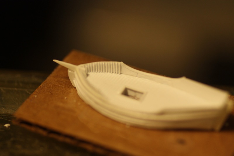

By this time the San Bruno had reached this stage. This is about November of last year.

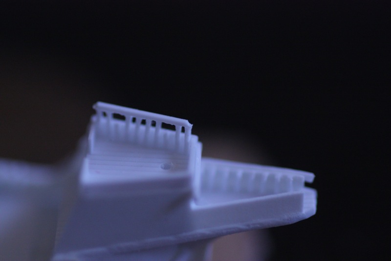

I began construction of the superstructure parts. I decided that these also would eventually be cast in resin. I decided to make each level of the superstructure an independent piece so that various configurations could be made from multiple casts. By the way, I want to thank my friend Jean Mahieux for encouraging me to document all of this stuff. He insisted I start taking pictures as soon as he saw the first pics of the Beja. That's the only reason I have these pics now. Here's more.
This is a 'proto galleon' configuration. I had the thought that once the galleon was developed many of the carracks might have been cut down and made 'race-built' to emulate the qualities of the galleon, even though the hull lines of the two types are different.

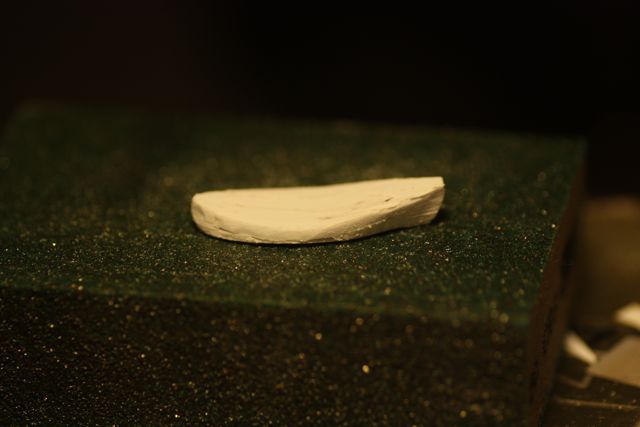

It's true I haven't been working from a plan, but, to be honest, plans still scare me a little bit. I haven't actually attempted to make something from a plan yet... That's another bridge I'll need to cross at some point. The hardest thing I've found about these builds is getting symmetrical results on both sides. You can't take anything for granted. Just because you laid so many rows of planks on one side doesn't mean the wales will line up on both sides, microscopic spaces between the strips can lead to noticeable results in the final build. So far I've gotten lucky, I think, but I'm also improving. Eventually you come to the conclusion that symmetricality is 'relative', and that actually it probably was on the real thing as well. After all, they were built 'by eye' just like I'm building mine.

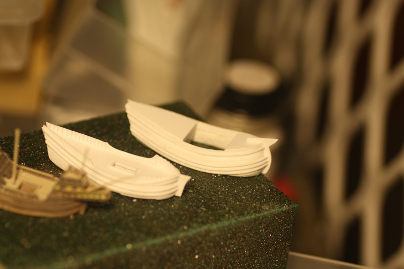

Ok, so here is the birth of Bruno 2:
This time I decided to start finally using my Dremel Tool, which sped the process up considerably.

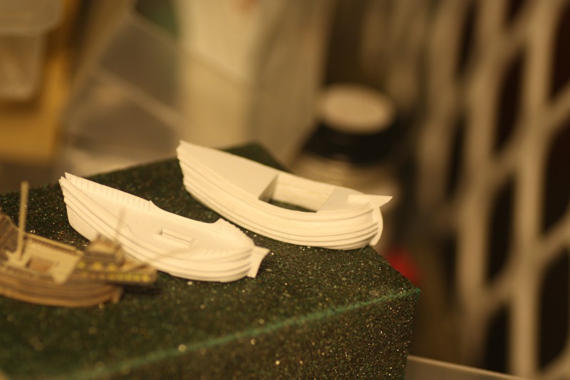

Here you can see the crucial difference between the transoms of Bruno 1 and Bruno 2 A chunk is missing from the stern of Bruno 2, but that will be added shortly.
Another comparison shot. The Bruno 2 has a higher stern. Also the widest beam has moved forward from amidships, a feature, that, on reflection I started to worry about, but I've decided to go through with the completion.

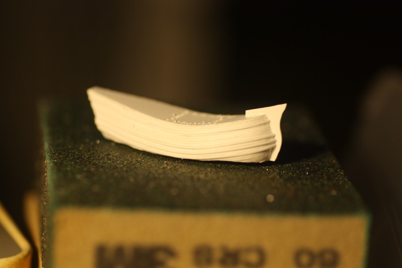

So this is Fatty, and this brings us up to this week. I know it's probably confusing, but there's actually four different builds that I've documented here. Bruno 1 will be discarded. The original Beja I've decided to complete as a scratch build and not wait for the turned brass and photo etch. I don't want to waste Bruno's details on the Beja when the others are going to turn out better. I will skip the majority of photos of Fatty. It was constructed the same way as the others.
Part of the problem with Fatty was that she was really really high out of the water, keep in mind this is just to the weather deck, no gunwales yet, which would only increase the height. I thought about sanding down the bottom of the hull, but that would have destroyed so much of the curves that I worked so hard to create. The solution, I finally realized, was to carve out the waste deck into the existing hull and create, what was in essence, an upper deck with fore and aft superstructure out of the weather deck. Here is the result:
A little scary, and I did actually break through the gunwale on one side at one point, but it was only a minor error, not really noticeable.

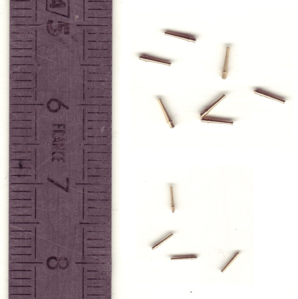

Here is a shot from Bruno of the turned brass that BMK made for us. Cannons! :woo_hoo: I can't wait to get it!
