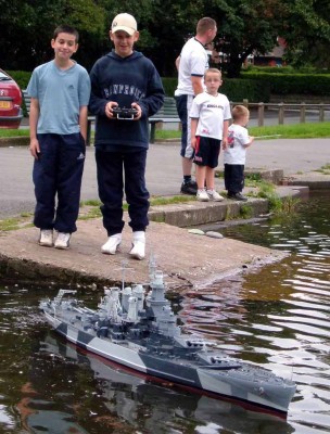

What has he got under wraps :heh: , well here is an earlier picture of the master model builder showing how it's done.

I remember seeing that build on the main page before joining the forum. Did you let some kids passing by take the controls so you could take a few pictures of the first sailing?
Dave, thanks for posting that old picture back from the Iron Duke days. Memories.

Found it. Confirmation.
