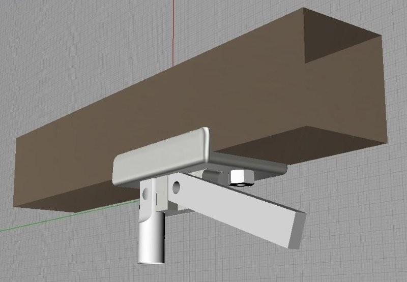

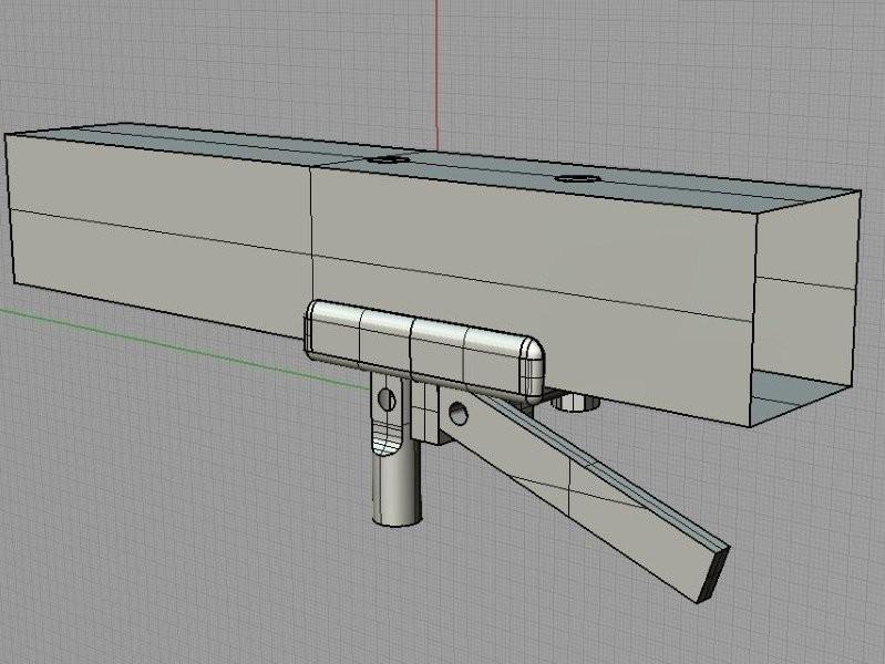

Working on framing. This is a cast iron bracket that is deeply mortised into, and through-bolted to, each oak deck beam.
To the bracket are bolted a vertical stanchion that extends straight down to a floor timber, and a diagonal brace that runs out to ship's armored sidewall. This bracket is a recurring element in Ericsson's design. There were 70 of them, two on each deck beam, 35 on each side of the ship.
If you hammer away at CAD on the USS Monitor for long enough, you may notice that Ericsson had a design mannerism: he liked to make things 17-inches wide or deep. The sheet iron webs that support the turret shaft are 17 inches deep. These brackets are 17 inches wide. Where you or I might use 18 inches as a default for something that needs to be the the next size up from a foot, John Ericsson favored 17 inches.
The bracket casting is in the shape of a tray, with ridges that project upward from its upper surface.
If we peer inside the oak beam, it is clearer how these brackets were mortised into the wood. I don't know if they had power routers, or if they used chisels. But with so many of these brackets, I would guess the beams were grooved for the brackets using jigs, as a milling process before the beams were mounted.
Another guess would be that the bolt heads on top of the beam were immobilized -- molded or cemented into place with tar or something like that. After the pine deck went on, there would be no way to put a socket wrench on them. Here is a rendered version.
Nuts and bolts TK.
Take two. A closer look at the original drawing shows the bracket was secured with 2-inch square bolt heads. There is no top view, but the word "square" is handwritten on the front view. These square boltheads were mortised into the tops of the deck beams. They looked like this:
No cement, no tar. Simple solution.

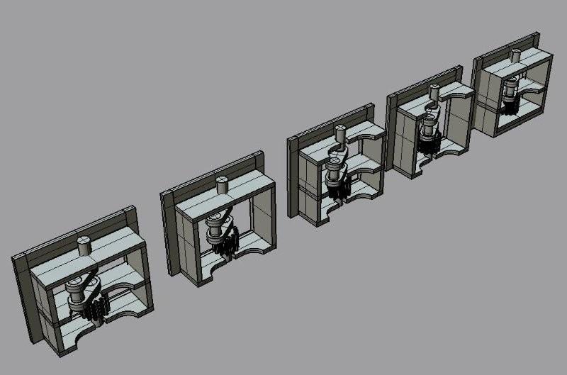

mcg
Posts: 201
Re: USS Monitor turret engine crankcase
Post by mcg »

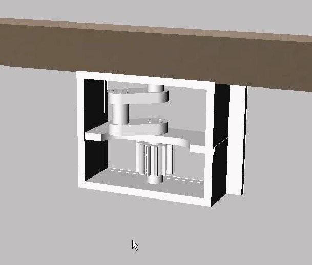

We have a couple of overhead views of the crankcase for the V-twin turret engine, but the side views are incomplete or unclear. So basically we start from a 2D overhead view. The best one we have (Peterkin #176, Stevens McCord collection No. 30/124) is a rough draft, with several crossings out, erasures, overdrawings and redrawings. Accordingly, there are several possible 3D interpretations of how the turret drive crankcase looked and worked. Here are five mocked up possibilities:
2D shows at least one curved shelf -- but why, where and how many?

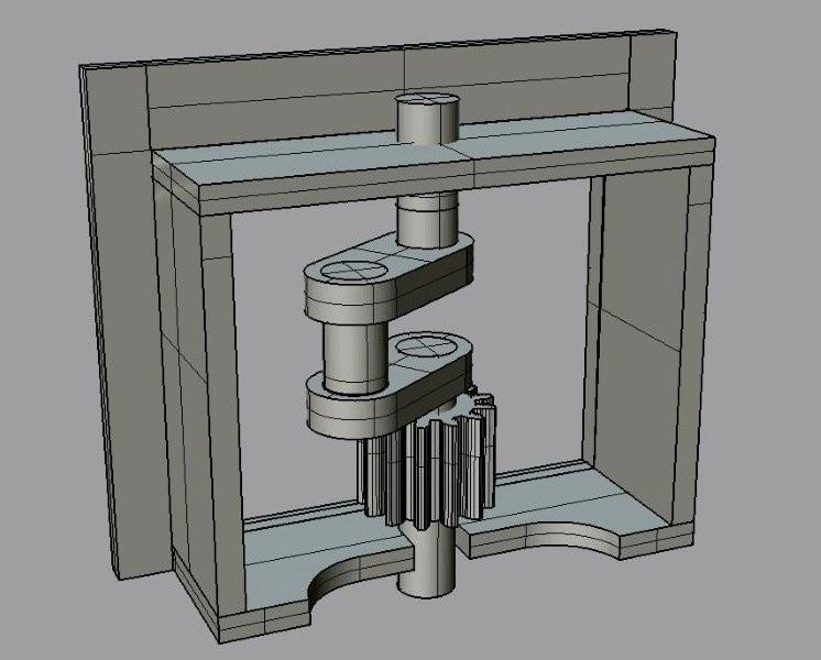

In this circumstance, you can only ask yourself, how should this thing work? And try to guess the most reasonable approach.
Here are some design criteria for the crankcase:
1) It must be possible to assemble it. Put another way, there must be some means for getting the crank into the crankcase.
2) The crankcase requires adequate clearance to swing two connecting rods. We have one partial overhead sketch of one of these con rods, and some circles and lines Ericsson pulled to show their range of motion.
3) It requires adequate room for the valve gear drive, which consists of two eccentrics driving two rods to actuate the valves.
4) The crankcase must stabilize the crank and the pinion against very considerable reversing loads. For this reason I think it needed a middle bearing between the crank and the pinion.
Here is my current guess at the structure of the crankcase.
One assumption is that the crank pin could be locked and unlocked. According to a handbook on 19th century steam engine practices, this was a fairly common mechanical feature.
It appears from the drawings that Ericsson provided simple (un-split) thrust bearings at the top and bottom of the crank, inset or simply cast into the basic box. In the middle of the crank, between the crank and the pinion gear, I am guessing there was a bearing set into a web. This central web would work very like a crankcase web you would find if you dropped the pan of a modern IC engine. At this middle web, there would have been a cap secured with bolts -- a split bearing surface. All three bearings could be align-bored.
To install the crank, the lower half would have been positioned in the bottom and web bearings. The upper component of the crank could then be loosely mounted on the crankpin, and rotated into the box. It could then be slid upward along the crankpin so that the crank axle seated in the upper thrust bearing. The crankpin would then be locked or pinned in place. and the split middle bearing completed with a bolted cap.
The open box structure of this crankcase allows sufficient clearance to rotate the ends of two connecting rods.
Above the crank, it appears there would be room enough for two cams, each driving a valve of the V-twin steam cylinders. These cams certainly exist, but it is not clear from the drawing where on the shaft � up or down or in the middle -- the cams were positioned. They appear only in an overhead view (Peterkin #13, Stevens McCord collection No. 14). I�d like to put them on the upper part of the crank because there seems to be room for them there, and because this positioning gives the valve rods a reasonably direct path to the valve linkage.
Clearance looks adequate for the two valve rods to rotate on their eccentrics. So this mock-up looks plausible, but to see whether this type of crankcase could actually work, I will need to fill in the cams, the valve gear and the connecting rods.
Fritz
Posts: 125
Location: Salem, MA, USA
Re: USS Monitor turret drive machinery
Post by Fritz »
MCG,
Looks like a reasonable method. Some very nice investigative thinking. I assume that the split bearings would be grease lubricated brass liners?
Best Regards
Fritz K.

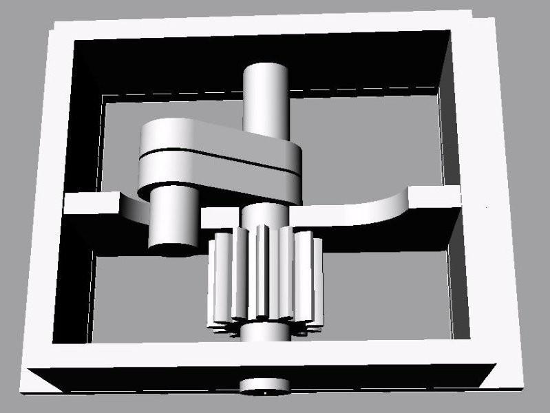

Update. The computer enhanced image has now come in from the Mariner's Museum. My speculation that the crankcase had three tiers now seems very unlikely. There isn't enough room between the pinion and the crank for a third bearing. So the likelier crankcase, in light of the new SIDE image, is a simple box with just two bearings.

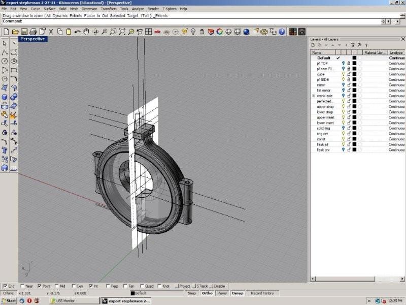

This is one of the eccentric sheaves I was working on. The brass bearing inset is relieved for the cam.
This shows the cam ghosted into place, clamshelled between the two halves of the eccentric sheave, which was also called an eccentric strap. The cams as sketched are 1.5 inches deep, and the USS monitor crankshaft and crankcase are designed with just enough room to stack two of these, one per cylinder. One possibility is that cams were in fact used in the Monitor, and another is that they were discarded around October, 1861, in favor of the much cleverer camless system researched by Starseeker. The whole turret drive apparatus, which Admiral Porter dubbed "the coffee grinder" was installed in the ship at the Continental Iron works in the last week of November, 1861.
I may end up drawing the system both ways, since I have already sketched the cam system. Michael
