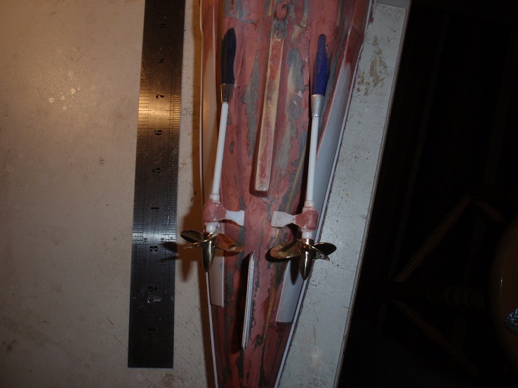

well this time i went whole hog and bought a set of props for sheer,i know expenseive for a static model but they sure are pretty.they look big in the pics but they are spot on with the drawings.here's some pics,they are just rough fitted for now as the prop struts and rudder would more than likely get damaged with all the moving around with the hull right now.

Looking good . :thumbs_up_1: Is that a degaussing cable below the portholes . :thinking:

Hi Russ, I have to appoligize for not coming in to your build sooner, but when reading it all last night the dates posted was when I had a lot going on with my cancer treatment, I probubly looked in but was not in a posting mood.
Things are looking good, but you are going to hate me by saying, the props look a little large, they seem to come a lot lower than the keel, but if you are happy with them leave well alone, :thumbs_up_1: :thumbs_up_1: :wave_1:

Hi Russ This is looking good I do like how the shafts A frames and Rudder have turned out

thank you ron,i like all feedback good or bad.i might not have noticed the props hanging down to much before i glued the struts ,good spoting :thumbs_up_1: .the struts will have to be trimed a bit.this pic shows the size a bit better .they do not look so overly big,plans show the props the same level as the flat part of the hull bottom. Richard they are degaussing cables it is angle styrene strips,on some drawings they show them this size,but i cannot find a pic of them.they where added on one of the rebuilds,1941 maybe?
i pulled it down a bit ,when it is premenently mounted struts will be counter sunk into the hull

Hi Russ, Sorry to put you to some extra work, but its at a piont were it could be altered, looks a lot better now :thumbs_up_1: :thumbs_up_1:
