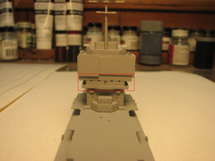

I started working on the block house in section three (part numbers C6 and C7)and they have a minor fit problem. I cut the locating pins off of C6 and was able the square the two parts up. With this done, there is still a small fit problem between the two parts but this is hidden mostly by the radar panels. The corners need the most work. If you are doing a 1967 version of this ship you need to open the two other locating slots on part number C6 for the I1 panels. It doesn't tell you to do that in the instructions, so I didn't and will just cut the locating tabs off the back of the I1 panels.
Cut out slots marked in red for the 1967 version.
minor fit problems fixed with putty that will be mostly covered by<br />the radar panels  I1 and I2.

[quote="Gordon Bjorklund"]I started working on the block house in section three (part numbers C6 and C7)and they have a minor fit problem. I cut the locating pins off of C6 and was able the square the two parts up. With this done, there is still a small fit problem between the two parts but this is hidden mostly by the radar panels. The corners need the most work. If you are doing a 1967 version of this ship you need to open the two other locating slots on part number C6 for the I1 panels. It doesn't tell you to do that in the instructions, so I didn't and will just cut the locating tabs off the back of the I1 panels.
Gordon, did you anticipate this from the dry fit? Looked like it was fitting well at that stage. I have this kit in the stash, and will be taking notes from your build.

The minor fit problems have been noted and simple solutions will fix the problems.
D-Boy asked:
Yes, the dry fit showed this problem.

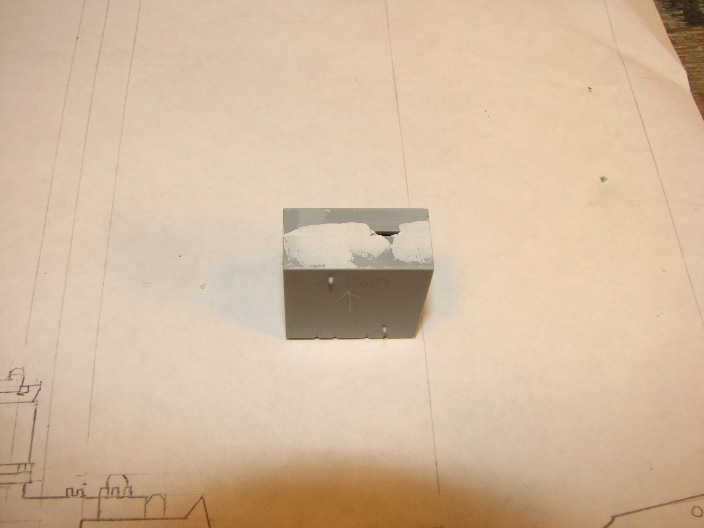

As noted before the block made up of parts C6 and C7 has some minor moulding problems. The upper piece C6 is the major problem where the edges between the two parts don't line up square and the three locating pins were cut off of C6 and that provided a better fit. Two layers of putty smoothed the two pieces and made for a flat surface.
The sanded putty shows the low spots that have been filled in.

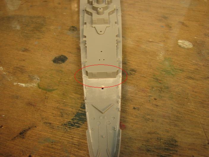

There is a small fit problem with the forward deck.
small gap.
small gap.
This gap is almost completely covered by piece G23 and the small gaps should be taken care of with a little sanding. The gaps between the deck and the hull can also be filled with putty and then the railings actually go over the filled in gap. I removed the front locating pins on part G23 so I could sand the bottom of it for a better fit to the deck.
