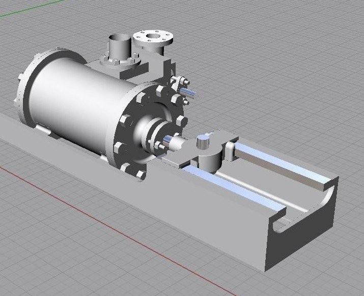

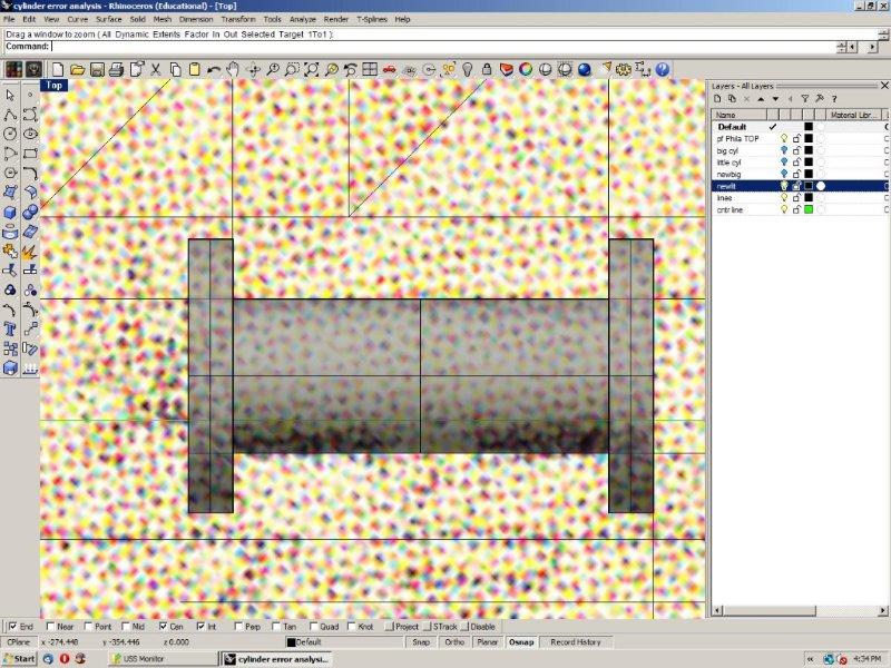

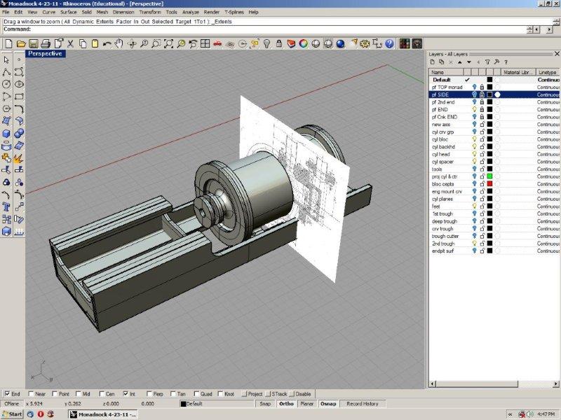

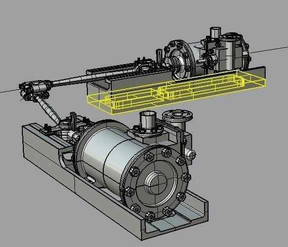

The powerplant is in progress. Mainly using Revolve and Extrude commands. The slides in front of the cylinder are for the crosshead. The steam chest is detailed on the drawing. I am filling in the big block components before attempting the watchworks of the double reversing valve gear.
When this cylinder and the crosshead are detailed I can mirror copy the assembly 90 degrees around crankshaft axis, offset this copy toward the bilge by the width of a con rod, and have in place the basic structure of the V-twin.

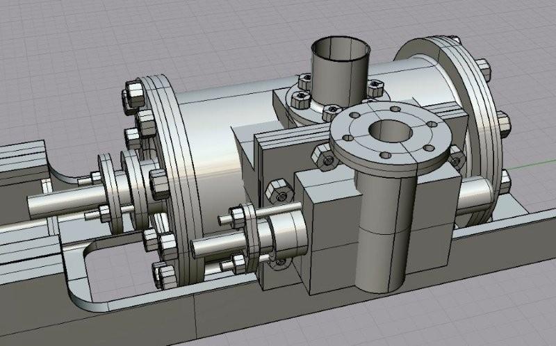

As a diver might find it -- right side up.
Rendered version. Moving parts come next.

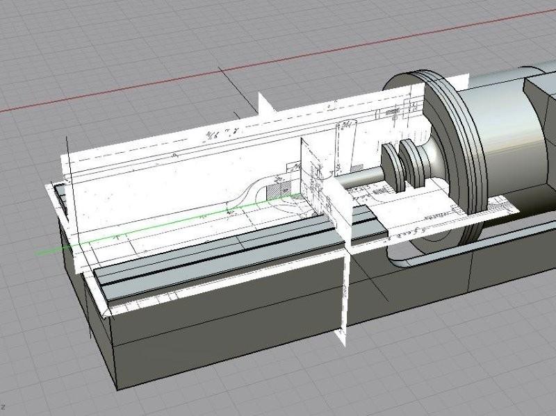

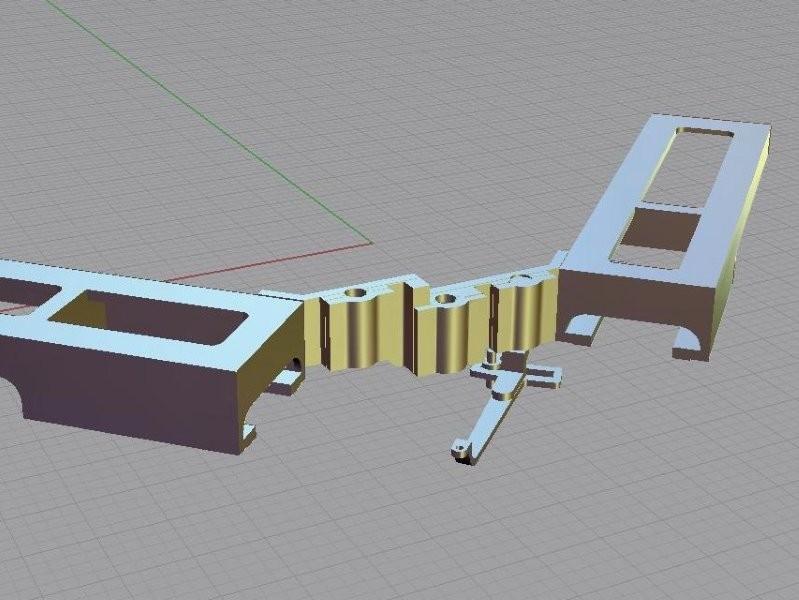

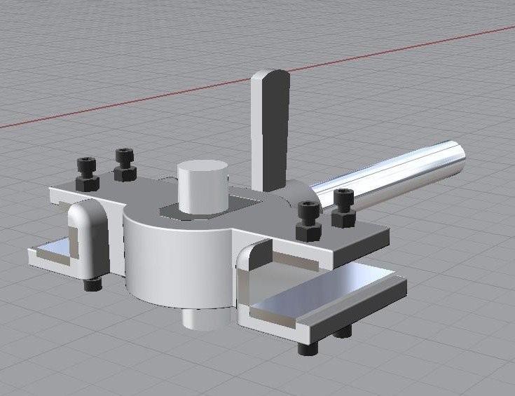

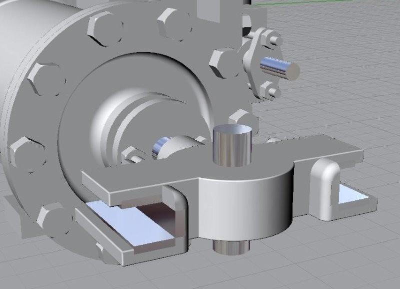

3-view setup for drawing the crosshead.
linear bearing bars were inset into crosshead casting, 3 per side
crosshead as mounted on the engine frame

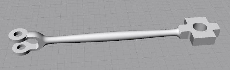

mock-up of a connecting rod casting

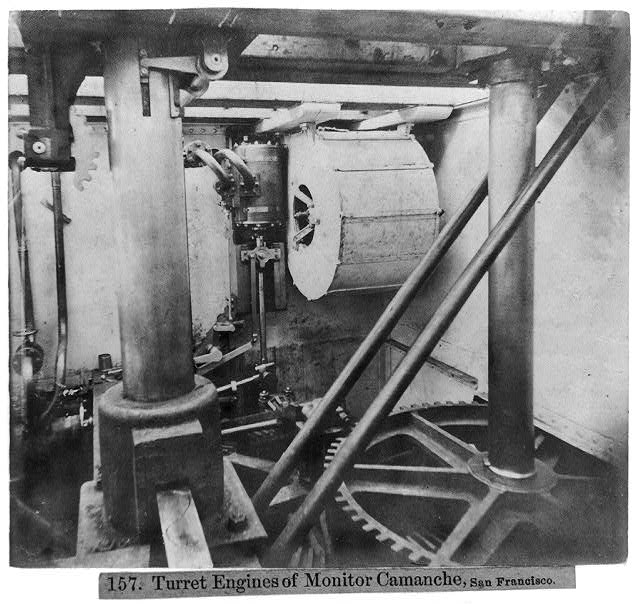

Finally found a photo, in the Library of Congress collection, of a Monitor's turret engines!
Camanche turret engines
One cylinder is vertical, the other cylinder is horizontal, heavily obscured by the turret shaft. Find it by letting your eye follow the steam pipes down the left hand side of the page to the steam chest. This is a late Monitor design, in which the shaft was coaxial, and extended all the way up through the turret to support a (non rotating) pilothouse.
3a36217r to crop.jpg (20.2 KiB) Viewed 6204 times
If we crop in on the vertical engine cylinder and crosshead, there are a couple of things to notice. One is the wooden lagging around the cylinder. This is not in the drawings. The other is that the valve and reversing mechanism is the same, slightly exotic system used in Monadnock, in which the valve for one cylinder is propelled by a linking rod from the crosshead of the other cylinder. Note that some of the meat of the connecting rod bearing at the crosshead has been milled away to provide clearance for the motion of the valve drive link. There is a high resolution TIFF download available at the Library of Congress site here.
http://www.loc.gov/pictures/item/2002725350/
The image was originally half of a stereo card. Unfortunately the other half was lost -- it would be useful to see this in 3D.
Visible in the Camanche photo are four of the eight adjustment set screws on the Ericsson crosshead. These set and locked the clearance of the slide bearings. It must have been an art form to get these just right. A wedge was used to secure the crosshead to the piston rod. It may also have positioned the inset bearings.

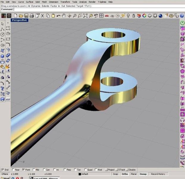

The connecting rod fork.
Probably the casting form was turned on a lathe with the forked end turning out, initially, as a jar on a stick. The jar was then milled away on each side to create the fork. The donuts would have been fitted and added, and the assembly used to make a mold.
This is pretty much how the piece is made in Rhino3D, using revolve, trims, and a boolean ADD to glue on the donuts. However, the back of the fork has been reshaped using Rhino's Blend Surface command, to make a fair transition from the rounded back of the fork to the flat surface of the donut piece. The con rod seems to be the most challenging piece on this engine, so far anyway.

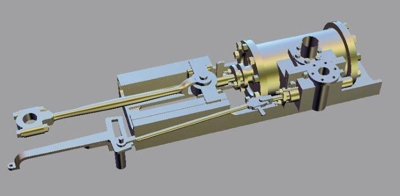

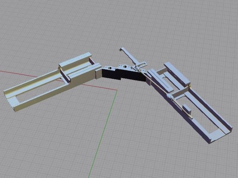

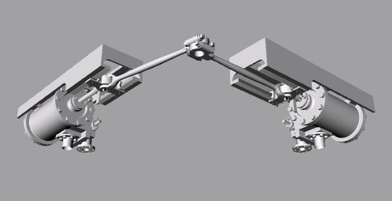

The V-twin, sans valve gear and crankshaft. Camera is looking aft and up at the ceiling of the galley. The inboard steam pipes are the inlets, the outboard pipes are the exhausts.
Below is a shot looking up and forward, toward the central bulkhead.
Note that the engine frame on the right has been deepened by the width of the connecting rod, to compensate for the offset of the two cylinders. Both frames will now mount flat to the overhead deck beams.
Spacer plate in yellow, probably a temporary fixture
At this point the spacer plate is a drawing aid -- it helps to have a uniform datum surface. However we may find that Ericsson mortised one frame into the deck beams to accomodate the cylinder axis offset -- and bolted the other frame directly to the beams. The solution he used may make itself clear when the V-twin is mounted to the crankshaft, since this should establish the height of the frames and mounting points.
Slide valve & reversing T-link
This is the basic slide valve and reversing link for one cylinder. Sliding the link from one end of the slot to the other reverses rotation of the engine. It was possible to accomplish this shift, via a long and elaborate linkage, using a handcrank inside the turret.

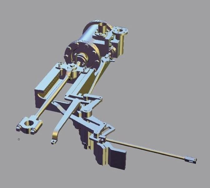

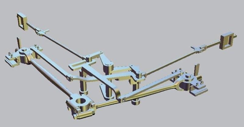

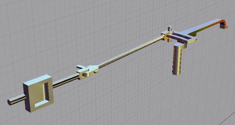

Here is the reversing gear for the V-twin steam engine.
valve links and reversing mechanism, as seen from below
This is what you would see looking up at the ceiling of the galley, with your back to the boilers. The two long rods extending away from the mechanism are the valve rods. Each links to a slide valve inside of the steam chest of its respective cylinder. The slotted, T-shaped links were a commonplace of the steam era. They can be seen on many steam locomotives. Reversing is accomplished by sliding the valve drive rod from one end of the slot to the other.
Because this is a V-twin, two reversing T-links are required. They are not quite mirror images. They are slightly different in shape and vertical placement -- basically to keep them from colliding.
On the central shaft are mounted two control levers. The levers are locked together -- probably as a single casting -- with an included angle of about 100 degrees. Via short links, these levers pull and push the valve rods along the slots.
When the valve rod is In the middle of the slot the turret does not move. At one extreme of the slot the turret rotates at full speed in one direction. At the other extreme it rotates at full speed in the other direction.

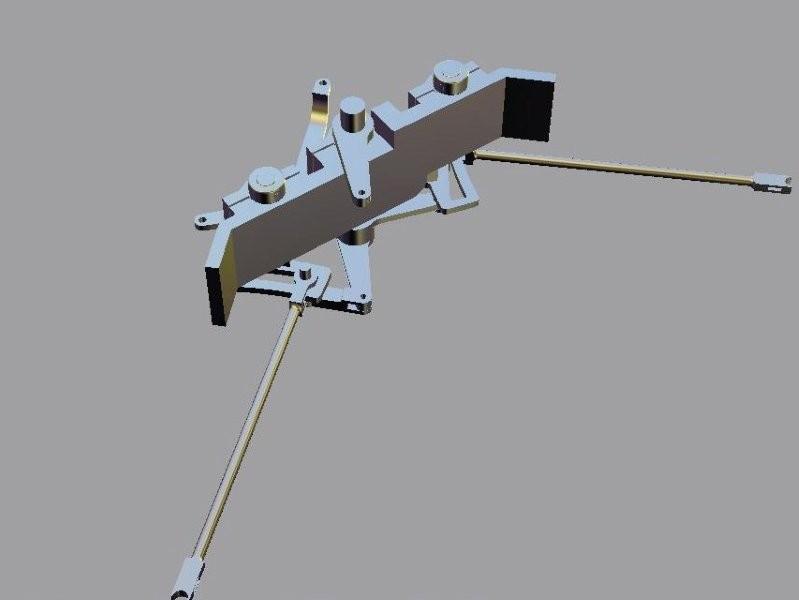

master control lever, from above
This is the same machinery seen from above -- though you could only capture this view while the ship was under construction. The master control lever for the control of the turret is mounted on the middle shaft, and protrudes forward, toward the turret bulkhead. This lever is the beginning of a long linkage leading, ultimately, to a control crank mounted inside the turret.
Missing from this picture are two rods. These were connected from the end of each T-link to the crosshead of the complementary cylinder. From a CAD standpoint, it seems best to install these final rods after both cylinders have been positioned relative to the valve gear. Here for visual context is the valve gear shown with a single cylinder.

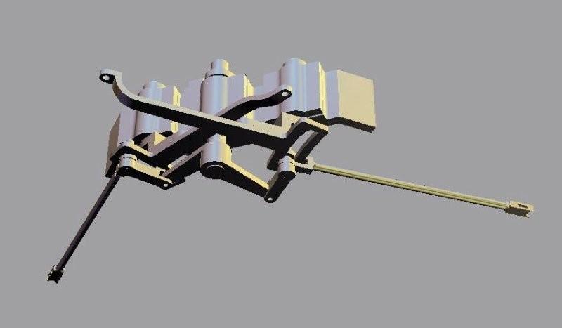

Double reversing system, with one cylinder shown

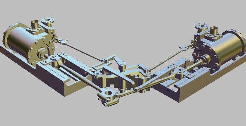

Here is the completed and aligned valve and reversing system for both cylinders of the V-twin. All of the other components of the turret engine have been turned off.
Two straight, simple rectangular section rods connect the crossheads to the tips of the T-links. These two reciprocating rods completely replace and supplant the elaborate cam driven valve gear more typical of 19th century steam engines. This excellent simplification worked because one cylinder of a 90-degree V-twin is always a quarter of a revolution ahead of the other cylinder.
Here is the complete engine, ex-crankshaft.
We know the USS Monitor used a standard, off-the-shelf V-twin "donkey" engine supplied by the Clute brothers of Schenectady. I think it was a rolling mill engine -- already developed and proved in iron works and mills. The features of V-twin rolling mill engines include reliable and sudden start/stop operation, quick reversing, high starting torque, the ability to operate without a flywheel, and stall-proof starting. They were also called "reversing engines." There is a print of one here: http://www.prints-4-all.com/cgi-bin/cat ... 4011875916#
The specific engine I have modeled in Rhino3D, the turret engine for the USS Monadnock launched in 1864, was supplied by the Atlantic Iron Works in Boston. How closely does it resemble the original Monitor's turret engine?

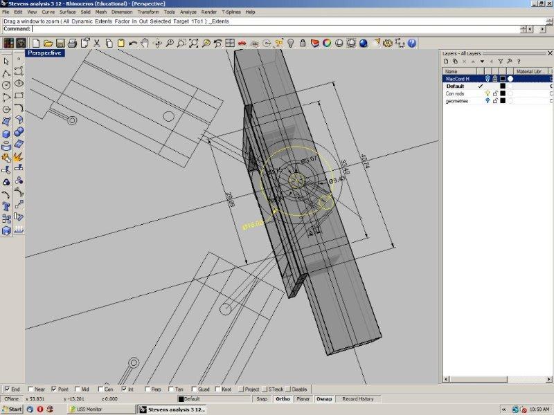

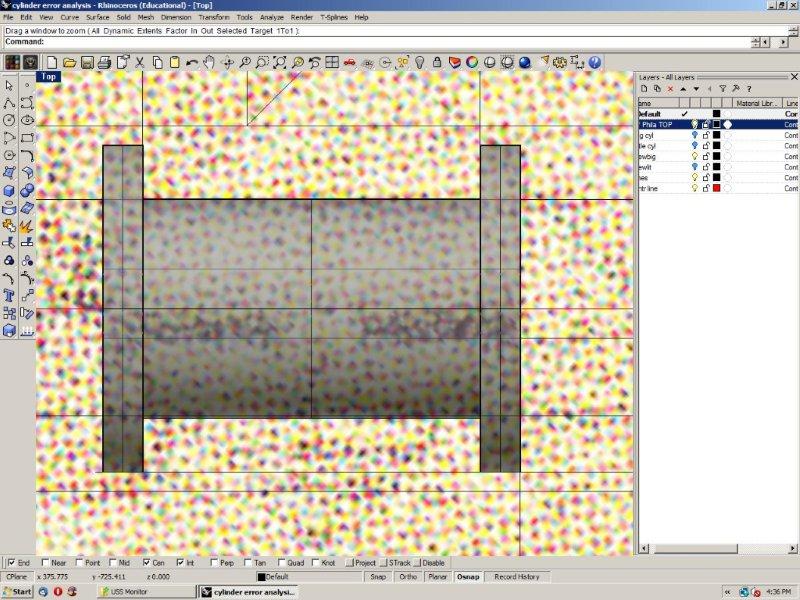

Finally, here is a CAD analysis of an overhead view of the USS Monitor's crank and crankcase. The original image from which these lines were lifted is in the Stevens McCord collection. Net of it, the USS Monitor turret engine was designed with a 16-inch stroke. The bore I have not yet pinned down.
Dimensions taken from the Stevens collection confirm 16-inch stroke
As a practical matter, I intend to use the USS Monadnock engine modeled here to finish the CAD model of the USS Monitor turret drive. It is an approximation of the original, but it may be the best approximation we find until the actual USS Monitor turret engines are recovered from underwater.

Take a look at the cylinders depicted here, in a pioneering CAD drawing from a paper presented at The Third International Conference on the Technical Aspects of the Preservation of Historic Vessels convened in San Francisco, California on April 20-23, 1997:
cylinder diameter seems too small for its length
Subjectively, it seems the cylinders are oddly small in diameter and, therefore, in cylinder bore. The image is intended as a schematic representation, not as a scale drawing. it is a helpful sketch and it shows well the basic layout of the components of the turret drive. But for a scale modeler it is important to note that the cylinder size is not to scale.
How did these tiny cylinders happen? I think it was a CAD issue. It is a question of how you read and interpret into CAD the sense of the original drawings.

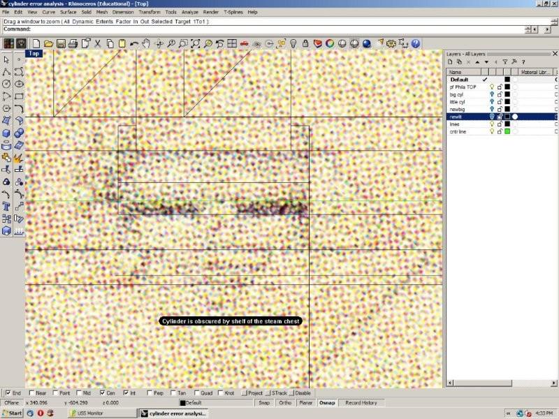

For example, here is a reproduction of a small element of a fine USS Monitor drawing that hangs in the Swedish American Museum in Philadelphia.
close up of cylinder and frame
The drawing has been screened for printing in Peterkin's book, hence the bothersome dot pattern.
The original artist -- possibly John Ericsson -- heavily shaded the cylinder along the edge of a horizontal shelf that demarks the slide valve's steam chest. In this overhead view, the steam chest and its horizontal shelf mask from view almost half of the cylinder.
Given the poor reproduction quality of the drawing, it is easy to confound this heavily shaded line with the edge of the cylinder. If you create a hypothetical cylinder in CAD using this subtly deceptive but absolutely false line, it looks like this:
erroneous cylinder -- off the centerline
One clue that this stunted cylinder is wrong is that it is offset to one side of the frame. The centerline of the piston rod and crosshead (green line) does not correspond to the centerline of the cylinder.
Another problem is absolute size. The oak deck beam crossing the picture diagonally is 10 inches wide. If we allow for cylinder wall thickness, the bore of this hypothetical cylinder must be down in the range of 5 inches. Compared to the 12-inch turret engine cylinder diameters of the later Ericsson monitors, a 5-inch bore doesn't seem consistent.
If we ignore the shaded line marking the edge of the steam chest, and instead revolve in CAD the upper, outer edge around the centerline, we get a much more robust and normal looking cylinder:
corrected cylinder
corrected cylinder
In this one the centerline is correct. The cylinder's outside diameter corresponds well with that shown in another drawing in the Stevens McCord collection in Hoboken.
