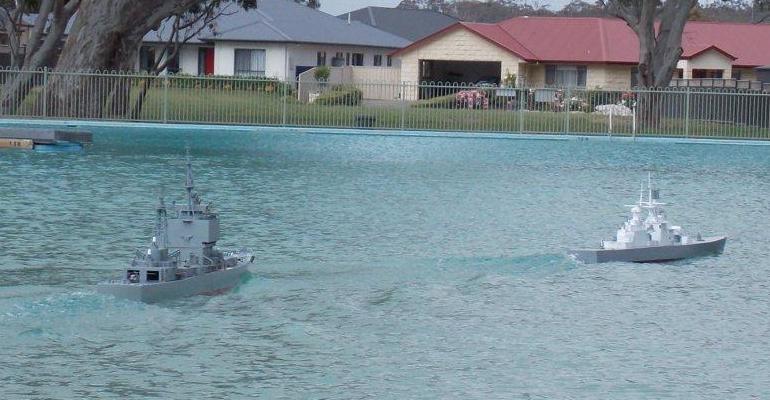

Needed one more day to get her fully painted for our Club event last weekend....Got all but the boot line paint in time!
Here are some pic's of CGN9 running with CGN36 for the first time at the same time! I was at he helm of USS California and my clubmate Nick was steering USS Long Beach (Nick has the all Aluminum LCS2 seen elsewhere on the forum)

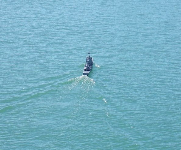

Was back at West Lakes for some testing at a different spot...this location has an arched footbridge about 30' high in center. Had some fun...got some good pix!
Apologies for any duplication of the this post from the build thread!! This is for those that don't check the build forum!!!

Myself, Jim, Scott and Richard rolled up to my new favourite spot at West lakes on Sunday for a Non official TF72 run. We had USS Long Beach (Me), HMAS Vampire (Jim), HMAS Sydney (Scott's AWD completed with functional VLS...) and HMA Darwin (Richard).
We cruised about practicing some Fleet operations and HMAS Sydney test fired some missiles!!!! The locals were suitably impressed and asked when we would be back! Everyone had fun until batteries started to run low from about 4 hours of continuous Operations (Long Beach being the exception! with plenty of Ooomp left in her Reactors!)
Here are some pix by myself and Scott!
Cheers Bruce
File comment: HMAS Vampire (D11), USS Long Beach (CGN9),and HMAS Darwin (FFG04)
File comment: Vampire leads the pack
File comment: Fleet Ops, Vampire was in port refuelling!
File comment: Vampire joins the Taskforce..
USS Longbeach, HMAS Sydney, HMAS Vampire and HMAS Darwin A1.jpg [ 143.89 KiB | Viewed 866 times ]
