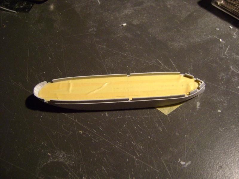

Here are the first shots of my commission scratchbuild of the Peruvian ironclad frigate Independencia. She was built in 1864 in England and sunk in action in 1879 during the War of the Pacific between Peru and Chile.
The hull is made sandwich-style: three layers of styrene, Magic SCulp putty to fill it up and then sand, fill, prime, sand, fill, prime, sand, fill ad infinitum. The deck has V-grooving, the smallest I could find. So far, so good, I guess.

Disaster! The hull turned out to be 2mm too long, and that is unacceptable in 1:700. So I took the microsaw and starting hacking. That messed up the V-groove, so I had to remove the upper deck. Niiiiiice.... Oh well, we live and learn. She's already been put back together, but the deck will have to be redone.

I wonder Michel if you might have had better luck sanding the difference off of the bow? But maybe there wasn't enough plastic in the interior to make that work. At any rate I'm sure you'll find a way forward. Keep your chin up! It's going to be good!

Now, what have we learned, kids? Measure THRICE, cut ONCE.
Don't ask.
Anyway, progress. Hull has been fixed. Now the somewhat complex interplay between the bulwarks and the hull lines. The bulwarks lean back closer to the bow, there were the bowsprit used to be. So there's a complex curvature, interrupted by the gunports. Yeah, real easy.
Here the first parts are up, need more filling to get in line with the hull and with each other. Gun ports will need cleaning up.
Don't ask.
