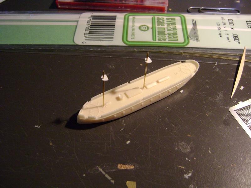

Armed with Jim's valuable advice, I got a pair of plyers, some copper wire and went medieval on this. The result is below, not too shabby, if I say so myself. Next: the aft gun mount and the various deck hatches.

Interesting technique. Note book where are you??? :heh:
Good work, Michel. :thumbs_up_1:

That looks great, Michel!
I must start my Huascar now, would be a shame if I finished the kit after your scratchbuild! :wave_1:
