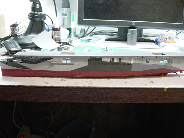

joedunlap
Posts: 33
Joined: Wed Mar 28, 2007 10:06 pm
Re: Calling all USS Independence class (CVL) fans
Post by joedunlap »
Wheee, it works! Thanks again Tim.
joedunlap
Posts: 33
Post by joedunlap »
Gonna be a while before I have any more. Im in the middle of packing for a move from Socal to Portland Or. so shes back in the box for now. Hopefully there will be a PE set available for her by the time I get settled up there. In the meantime, I'll be looking forward to seeing other builds of this great kit here. Wayne, again Ill be glad to help any way I can. Let me know.
Joe
