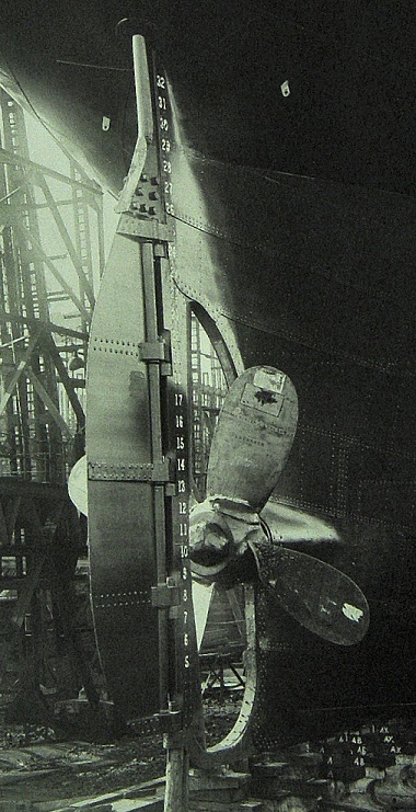

I'm preparing to build my first large scratch-built ship, and am stumped on the construction of the rudder and stern.
The rudder is hinged on the stern post, with a rod going up to the steering gear, on the poop deck, connected to chains and pulleys and such.
All builds I've been able to find documented on the net of RC models have a more modern rudder arrangement.
Further questions may come later, thanks.
Rudder and stern post
