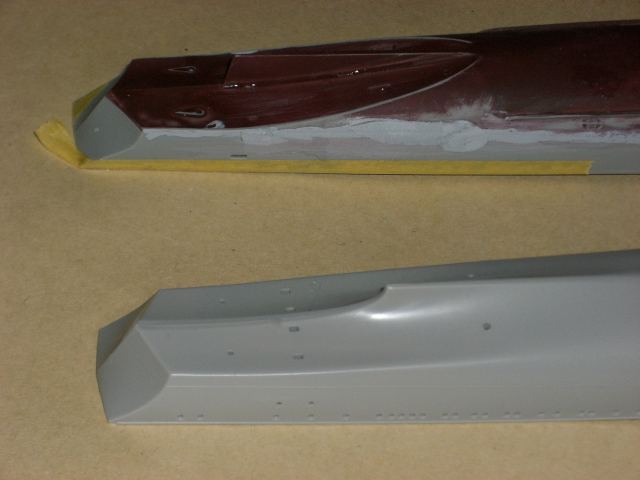

I have seen the line drawings in the meantime. The aft underwater hull of the Z-39 is wrong.
Should be like the photo below, much rounder and longer. The bilgekeels are about 40 mm to far aft and the transom is at least 2 mm too narrow. if you compare it with the Trumpeter hull (Z-25/Z-43) you will see immediately what i mean. This is how I realized it first (see the second photo)
I have the line drawings, but I cannot post them here for copyright reasons. The source is: Hadeler, "Kriegschiffbau" Vol 1 between P. 16 u 17, Zerstoerer 1936A.
For information, Hadeler was Hadeler was leading designer in the german navy before the war and one of the designers of "Graf Zeppelin and had access to original plans.
There are probably other sources for the line drawings, however, you cannot reconstruct the hullform only from a sideview and some cross-sections alone, as this could lead to misinterpretations like in this case

Do they more closely match the Trumpeter hull or the Dragon one?

the shortest drawings are close to the trumpeter model but the big plan is close to dragon, with the bilgekeel arriving until the propellers but the keel lines are more rounded, like trumpeter

My point thus being that it is too early to state definitively that either hull is wrong. We have conflicting sources, and while one would appear to be from a good source close to the originals, we have no way of truthfully vetting either short of photos and other documentation.
