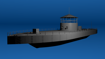

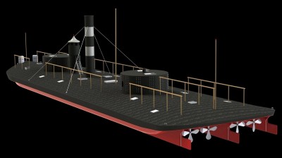

Hello everybody, welcome to the CAD-yard...
This thread will be a place you can share your ideas, techniques, ask questions, and learn from each other. An open forum to show your WIP's, finished CAD models, tutorials, problems, etc., and hopefully learn some new tips & tricks along the way.
I'll start by saying that recently I've become interested in learning Blender, which is free and open source and can be downloaded here http://www.blender.org/download/get-blender/.
One of my goals is to really get into the mapping and textures aspect of CAD models, basically to give them that added realism. My current CAD package is SolidWorks 2010, (been using it off and on for some years now) which does a good job modeling wise, but can be limited in some area's, so with using a SW - Blender pipeline, I hope to really improve my current skills and learn much more.
So my first step was to export a SW file into STL format, then import it into Blender, which turned out rather well, no real problems with missing surfaces or geometry. Now from here it's all fairly new to me, I'll be attempting to texture these WIP's as practice, so when I do finish these models, I'll have a clue as to what I'm doing.
I did a quick render with the default settings in Blender, and all that was adjusted was the background color, and also moved the camera and light around, so these pics are my first test results before moving on.
Any crit's, comments or questions are welcome,
Dean

That is looking sweet! Love the Chickasaw. Could we some wires to see how the geometry came in? I'm thinking you may want to apply the 'Smooth' button to some surfaces, specifically the pilot house and the smoke stack. I can suggest a few tips for a good studio render if you like.

Thanks guys,
this is going to be quite a learning experience for me, so bear with me as I fumble my way through this, and any input is really appreciated.
Yeah, now that I'm getting reacquainted with Blender, (just installed it yesterday) I did check out the wire-frames of these models, and it's not pretty. I'm thinking that maybe some of the detailing, like rivets, etc. may be better left out before importing, because they seem to add bunches of triangles around those areas (got to learn some new terminology too) when it seems like it should be much more simplified. I don't know, maybe that's normal, but I'm sure you'll point me in the right direction. (And get a good laugh at my newbie efforts too) :smallsmile:
I'll have a go at trying to smooth out those areas you mentioned, and post some wire pics tomorrow. And any tips you can throw my way is always welcome.

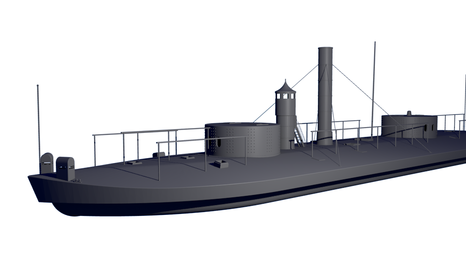

In the mean time, here's one more pic of my first attempt at ship modeling, (only started modelling ships recently) still a WIP and not too scale because of the reference material I used, but I tend to have multiple projects going on a one time, it keeps things interesting, whether it's planes, tanks or now ships, if it has guns on it, I like it.
Dean

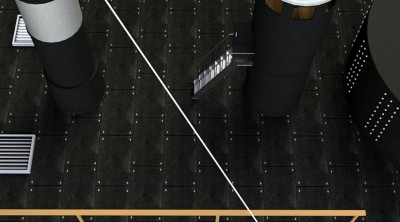

Well, since I'm not liking what I see in the wires, I'll try leaving out the details like the rivets, hatches, rails, etc. before I import it into Blender, just using the main body, turrets, tower and smoke stack and see if that smooths things out, I can always add the details later. Not really a problem because I'll just suppress those features in the SolidWorks file before I do a save-as to a STL file. Being a newbie with Blender and all, and still just fumbling my way around, (which means I don't know jack :smallsmile: ) it looks like those details are causing too many unwanted surfaces around those areas, which can't be a good thing.
So if anyone has anything they would like to share or ask, please do. I'd be happy to share any info that I have.
Dean

That does look a bit of a mess. The model is great, but you are going to have no-end of headaches with that mesh. One thing you could do, is to separate the mesh before you export it. You could export the basic turret shape and hull shape as separate objects, then send out the rivets and hatches as a separate object. Then, when you bring them into Blender, they should sit on top of each other in place, but they won't all be one mesh. There may even be a check-mark box that will allow you to send out the different objects as separate geometry.
Yep, a little more than a bit of a mess :smallsmile: ... Yeah, I was thinking the same thing about bringing it in piece by piece (I already started working on it). If I can get the deck, turrets (without rivets), tower and stack cleanly into Blender, I can work on making some decent texture maps with some details. After those are made, I can just jump back to SolidWorks and use them. With the bigger surfaces being the most obvious, I really want them to look good, and with the smaller stuff I'll just use the textures and materials within SW. And I'm sure I'll have a few questions for you when I get to that point.
