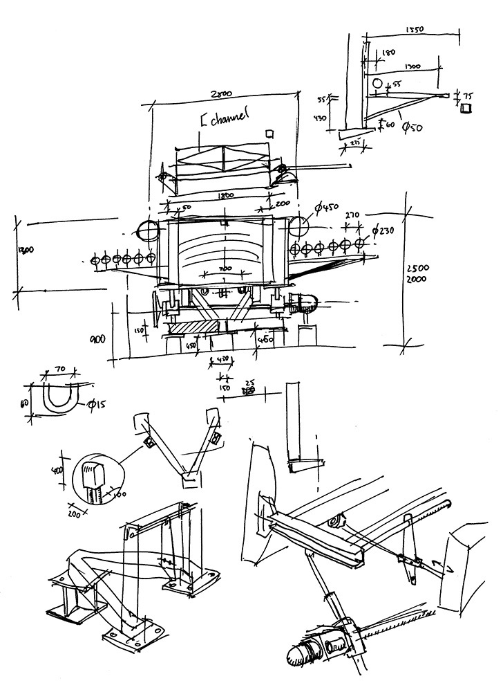

Not that it's much use to anyone, but here's part of the 'creative process' (read headache) gone through to recreate the FLOLS from photos. Part of the process involved using Photoshop's ruler tool calibrating to the height of the rail around the FLOLS, which I took to be 900mm, and where the photo's aren't too distorted due to perspective, sizes were measured off the photos.
The measurements are transferred to paper, along with sketches on how things appear to go together, before trying to transfer it all to CAD as a "best guess".
Dave.

You just gave me another !DUH! moment! I have been making sketches like this (a stack about 6" deep) for my modeling project, using a real ruler to take measurements from photos on the screen.
I have been using Photoshop for years, and I totally forgot about the ruler tool!
Thanks for jogging my memory.
