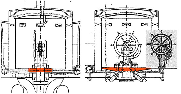

I've been studying the Pilot House diagrams and the blueprints and realised that there was a great big metal platform that travelled the width of the pilot house (marked in orange) and served as a strengthener for the house and as a base for the helm .

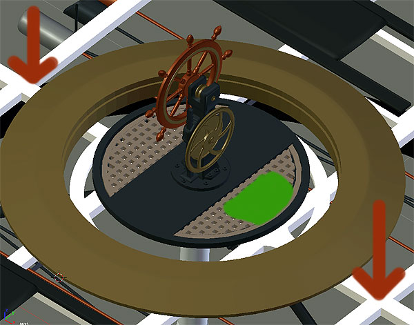

The hatch would have to be either fore or aft of the helm in that case. I've got a pic of where I am with the pilot house, which should show you what I mean. The green blob is going to be the hatch out of the Pilot House. It could just as easily been on the rear, but I'm assuming that things would generally be easier if the hatch was towards the bow as it won't disturb the Pilot if someone comes in or out of the chamber. The floor on other diagrams looks perforated, I've chosen a wood lattice as it looks nice and matches the 'non-skid' nature of the Turret floor, but it could easily have been a metal grate.
If you look at the diagram, the turret has to be turned to the the side for people to get out, otherwise the main fore-aft beam of the turret (indicated by red arrows) will block the hatch. Unless there is some other ironmongery or similar on the turret ceiling, it should be possible to exit the turret whether it is facing port or starboard, just not fore or aft.

That's a great pic of the pilot house, and I see you've got a good start on the interior, looking good...

Owen,
That makes perfect sense, and my Weehawken model also shows the same. Great detective work!

Nice logic!
The caption on the French plan says "Note that at sea, the turret is turned in such a way as to point the cannons to starboard, as indicated... The lines [centerlines of the cannon bores, presumeably] penetrate the page."

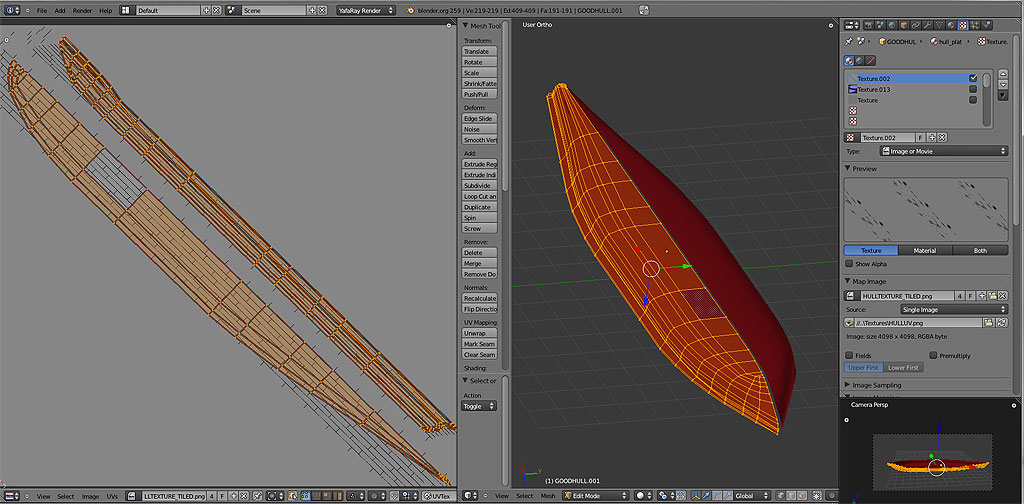

Eventually I UV Mapped it (which I kind of knew I'd wind up doing eventually). I separated the sides of the hull and the bottom and did a 'project from view' on each to get my UV map. Then it was off to Photoshop and create some hull panels. I created one line, and to make the others match, I just duplicated the layer with the line on it and moved it down a bit.
