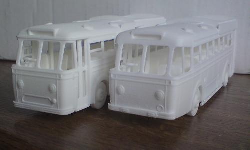

3D printing has come a long way since it's be introduced, and the price has come down considerably, although still not what I would call cheap. The early printers were very rough and expensive, and the detail you could have on parts was low, but that has changed.
Here's a few links to show you some of the detail parts that can be done on the new printers, and like I mentioned earlier, depending on the material used, a lite sanding may be needed, but no more than you would have to do on some cast resin parts. And for something like a turret, you would want a little roughness to give the illusion of iron, so that can also work in your favor.

And a pic of a bus they sell from the shapeways website
Dimensions: 2in wide x 7.9in long x 3.7in height
Dean

I'm not trying to be argumentative here, but just point out some facts. All of these examples are large scale. The busses are about 1:50. The anchor is about the same, and the Hellcat appears to be 1:20 or so.
The "fine" details in these examples appear to be 1-2 mm thick. Like I said, this is pretty big for scale model ships. For example, a 20mm gun with a 1mm thick barrel would be about 1:25 scale. That's wouldn't be useful on anything I have seen posted on the Ship Model Forum.
Don't get me wrong. Stereolith can be very useful for creating larger objects with complex thick shapes. Things like anchors, bitts and chocks are ideal for stereolith in the larger scales. The best use that I have seen stereolith used for in ship modeling is producing the basic large shapes with little detail. Then smaller hand made details are added, such as wires for hoses, photoetch parts, etc. Then these assemblies are used as mold masters.
Someone may have made a 1:700 ship with stereolith - the hull and superstructure are large enough. Even the turrets could be produced this way. But the details certainly wouldn't be scale.

Phil,
No problem, I don't take it as being argumentative, and to an extent I agree, those examples shown in those threads I posted really don't show the detailing that well. The best pics I've found that actually show what is and isn't possible, detail wise, are from the Shapeways website (which I've attached).
And I couldn't agree more about the real fine details, 3D printing does have it's limits, and in a few years it may be possible to do those also, just not quite yet.
I don't know if you noticed it, but that one thread had a missile 3D printed, now how cool would it be to have your Talos model printed... just a thought.
Ultra detail and detail material comparison:
Ultra detail material painted:
And a little update on the Palmetto State and the newest WIP, the USS Onondaga.
Dean
Dean
