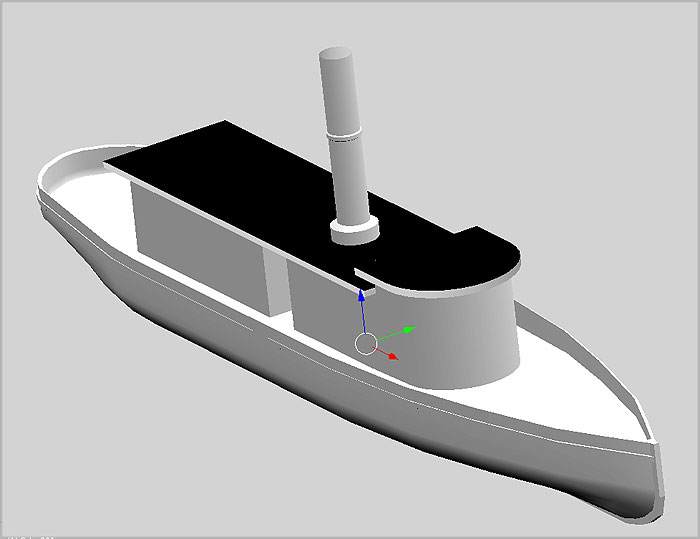

Being late is starting to be my MO here, but I had some time today to work on the 1/200th scale Chickasaw, and it was decided that it will be two halves, top deck half and bottom hull. Here's a couple pics of the top half, the lower half should be done in a day or two, depending on free time. Now, I need to get Devins input on this first, but everything on this half is notched and ready to make cut files from. We decided to go with .03in thick Styrene for all the main framing, and the way I set up the top half is all the flat areas are inlay-ed and notched into the frames for ease of assembly. That leaves the front, back and between the flat sheet areas to fill and blend into shape.
Well enough talk, lets hear some crits... :smallsmile:
And a YouTube link...
http://youtu.be/m8UbgpbntNM
Dean

Looks great!
One suggestion is to make sure that the entire footprint for the turrets is recessed, no need to be more than the .030 thickness of the sheet, but having that little bit gives a nice slot for the turrets to positively align to, just enough depth to cover any imperfections in the bottom of the turret casts, and it's true to the original.
 Post subject: Re: The CAD-yard

Thanks Devin,
Yeah, that's why I recessed the turret slots more than the styrene thickness and added that ring as a solid surface for them to rest on, it lines them up, lets them be movable, and gives you a little leeway with the turret bottoms while keeping them to scale.
I'll also have cutouts for the pilothouse and smokestack to rest in too, that should take care of alignment and location on those too.
Anymore thoughts or suggestions are welcome, I want to make this to your liking, not mine. :smallsmile:
Dean

Dean,
I'll respond to your last email here, as I only have time to really look at the internet at work, and all of my emails are on my home PC.
I think for the stack and the pilot house that tubing or turning them on the lathe is the way to go. At that scale I think the radius would be too sharp to bend sheet styrene around a framework to make the structures. I may have access to a lathe over the holidays, when I visit my family, so I can take care of them then.
I agree with having a test print of the turret done, just to see what we get. Let me know if you want to do it or if I should; I wouldn't mind getting one myself just to see what they can do. Also, on the turret rivets, I have some of those, but I get mine from Archer Transfers.
Really looking forward to this build. It should be really fun and educational.
-Devin
