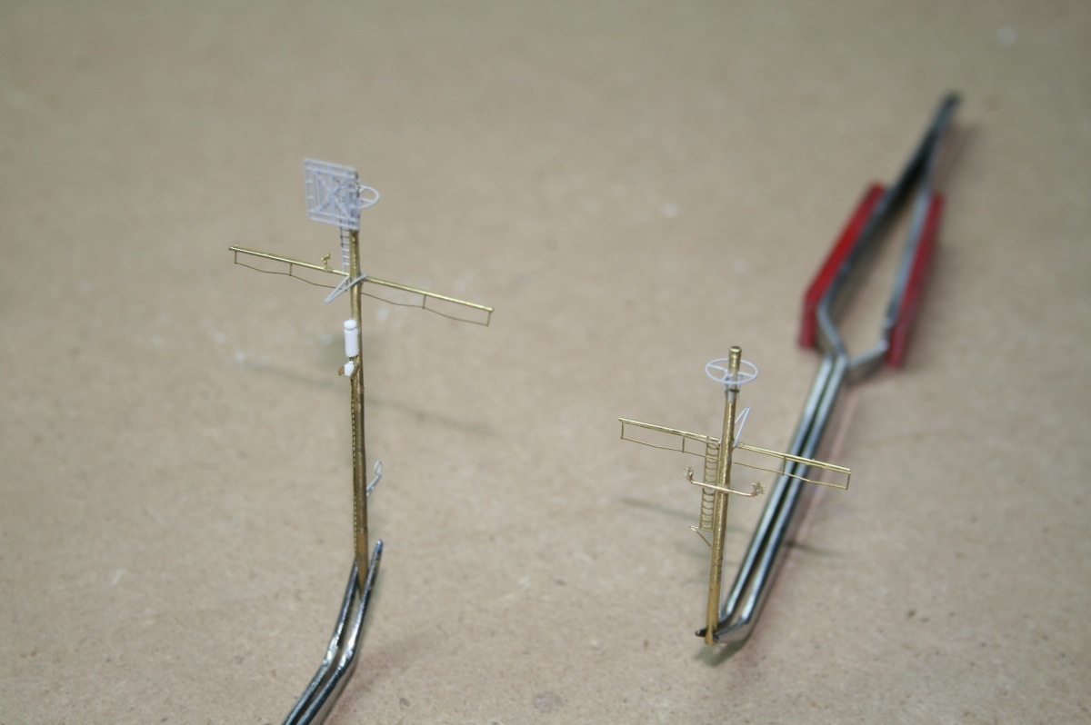

Here is what I used for my 1/350 masts, I assume this would work in 1/700 as well with a little modification and practice.
Drill press
3 sided jewelers file
Flat sided jewelers file
4 sided jewelers file
various grit sand paper ranging from 220-400
Piece of scrap wood
Gel super glue
Thin Super glue
Various PE and plastic pieces
I cut a piece of brass rod about an inch longer than I needed and put it in my drill press. I drilled a hole in the scrap piece of wood the same diameter of the brass rod and brought the platen up so that the exposed end of the rod now sat in the wood about 1/16 inch, don't worry about snug fit as once it starts to spin the rod will stay nice an snug and not bend or wobble. I set the drill press to the highest speed setting and went to work using the files to start grinding the taper into the mast and etching the various steps into the mast. It took me about an hour a mast but that is because my drill press only does 360RPM flat out, a Dremel drill press would be great with the higher speed. Once I had the desired taper and shape, I ran the sandpaper up and down to remove as many of the machining marks as possible and smooth everything out. I cut the unwanted ends off the rod and sanded the top smooth and added the yardarm using a thinner piece of brass rod cut to length. I tried to solder, but I wasn't having any luck as I am just too inexperienced with that so I resorted to what I do know, Super Glue! I added a small drop of Gel super glue to "tack" the yardarm in place and let it dry for awhile to ensure everything was straight and where I wanted it. Once the gel was good and dry and everything looked like it should, I gave it a good dousing in thing CA to ensure a good and secure hold and let it dry for a day. After that I just started adding the details that I desired from various bits. Here are the finished products before painting for my 1/350 USS Atlanta CL-51 HTH
