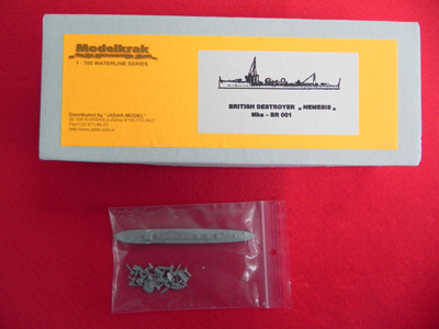

Nemesis Review 1s.jpg (52.21 KiB) Viewed 1794 times
The model comes boxed with bubble wrap around the plastic bag containing all parts.
Nemesis Review 4s.jpg (53.62 KiB) Viewed 1794 times
On first observation the hull is warped. So place in a flat bottomed pot just enough water to cover the hull and bring to a boil. Remove from the burner and when the bubbles stop (96 �C) place the hull in right side up, chop sticks are handy here. Observe the hull, when it flattens, about 1 minute, remove from the water and place on the stove top. Press down amidships gently with a finger (it�s not that hot). Wait until cool about 5 minutes, you�re done.
