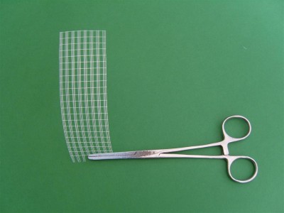

I use this simple wood frame. The threaded rod is glued round the edge with epoxy resin. Only a few windings are shown here, but I usually make a lot more than I need. Once the rails are wound on the frame, I paint it with Baker's Soldering Fluid (Consistency of water). And run a soldering iron quickly across the crossovers. It makes a pretty good job at small scales. I spray paint the finished rails with white matt primer aerosol from Halfords (UK). Doesn't take long, about ten minutes to make a frame full!
Note that they don't all come out perfect. Discard the faulty ones!
Bob
Bob

Yes use a frame just like that shown in the photo in Bob's reply but instead of wire and solder, because my present project is 1:600 scale I'm using invisible sewing thread. Where the verticals and horizontals cross over try using either clear matt varnish or some other clear, "watery" glue that will hold the rails together. It does not need to be a strong bond because the painting of the rails afterwards holds them together. The main trick is not using gluie, varnish or paint that "blobs". At small scale any blobs show up like the proverbial sore thumb. And yes not all the sets of rails you make will go well. Some you'll scrap or only use a part of them. Hope that helps.

The rails shown are 1:384 scale using tinned copper wire 38 swg size. (As shown in top photograph) I have never had any success gluing the joints and find soldering is quicker & easier, but most modellers I come across prefer gluing. The secret is is the flux used. Baker's is the only one that works with this method because it has the consistency of water and can be painted on with a brush. It doesn't even matter if the soldering iron has a lot of solder on it because the joint just takes what it requires and that is a very small amount. I get Baker's from plumbers supplies. Wire thicker than 38swg does not work well either.
Bob
Bob
