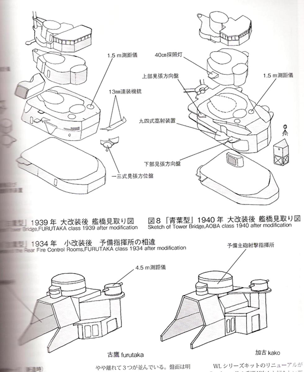

Does anybody have access to any worthwhile Furutaka drawings (else than Profile Morskie)? Also any details about floatplanes onboard Furutaka at Savo and Cape Esperance? Presumably these were 2 pcs E7K2, but what about their camouflage? China-type green+brown over light grey or just IJN green over light grey with orange id stripes on leading edge? Profile Morskie suggests the latter, but as I found some other little inaccuracies there already I do not tend to take this for granted.

I do share a fascination for this class as well. I do have access, but not at the moment. I will post some things today, though.

Hi Dan, thanks for your quick reaction. What you posted just confirmed my suspicions about the Profile Morskie drawings - e.g. the fwd 13mm gun platform looks strange there (e.g. compared to the drawing in L&W) and the large vents on the back of the bridge are missing entirely.

Thanks Peppe for very interesting posts. What is puzzling me again is the difference between the two Model Art drawings you posted (r1 and r3) in the vents on the back of the bridge (marked red in my previous post above) - these are clearly present in r1 and absent in r3. Also, they are absent in Lacroix p. 252 (Furutaka after 1939 modernization). However, they are part of both Hasegawa 1/700 and Blue Water Navy 1/350 http://www.steelnavy.com/BWNFurutaka.htm kits.
There is another difference between the bridge on r2 in your post above and in Lacroix on p. 254 - see below (shape of the fwd platform carrying the two dual 13mm machine guns, railing vs. solid wall).
Last but not least I noticed remarkable difference in the aircraft handling deck shape (under the mainmast) as it appears in the Hasegawa kit (looks similar to the one at r1 picture above, i.e. before modernization) and the one shown at r3, Lacroix p. 252, Profile Morskie and also the Blue Water Navy kit. The latter shape is much narrower and also the aircraft handling rails make more sense to me that way (unlike in the Hasegawa kit).
Furutaka after 1939 modernization, Lacroix p. 252
Furutaka bridge after 1939 modernization, Lacroix p. 254

posted by Peppe is the correct drawing. In my visit in Japan the 1/700 Hasegawa's team said that they used the official drawings from the Tokyo maritime museum archive for IJN Furutaka and IKN Kako models.
Plus some new photos that they where available when the book "Japanese Cruisers of The Pacific War" was published. So the aircraft handling era is the correct on Peppe's second pictrure and Hasegawa's models. I guess the incorrect image of the aircraft handling era came from absence of overhead pictrures and hard to access drawings from the Tokyo archive.

Vladi wrote: Last but not least I noticed remarkable difference in the aircraft handling deck shape (under the mainmast) as it appears in the Hasegawa kit (looks similar to the one at r1 picture above, i.e. before modernization) and the one shown at r3, Lacroix p. 252, Profile Morskie and also the Blue Water Navy kit. The latter shape is much narrower and also the aircraft handling rails make more sense to me that way (unlike in the Hasegawa kit).
Actually no, this picture is AFTER modernization. IJN Furutaka class had a modernization in early 1930's(1932-33). The first big modernization that ever occured to a heavy cruiser in Japanese navy. They where quite different before that.

According to Lacroix, Furutaka was modernized in early 30s and then in 1939 (not 1941, sorry for my mistake previously) when it received the dual 8" turrets instead of the previous singles. During this refit the bridge structure gained one more level thanks to removal of ventilation cowls (Lacroix p. 253). This can maybe explain the missing vents on the back of the bridge on some pictures, but without clear photos it is hard to tell.

That time the double 20 cm turrets replaced the single ones. The drawing on page .252 on the book "Japanese Cruisers of The Pacific War" is wrong as it missing the vents on the back of the bridge and it has the aircraft era the wrong shape.
The first drawing Peppe posted is correct.
I meant this one:
This is based on the official Kure Navy Yard drawing from 1939 where IJN Furutaka got her reconstruction.

Notice the height of aft main mast. Hasegawa is correct only for IJN Kako, you need to modify IJN Furutaka's to recemble the one on the drawing.

Some more illustrations from L & W. Ignore my markings on the Furutaka diagram.
