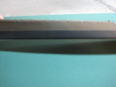

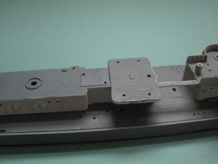

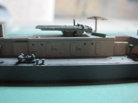

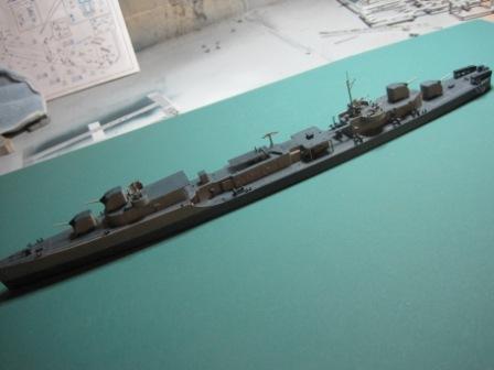

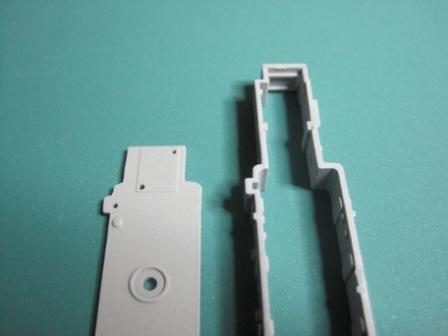

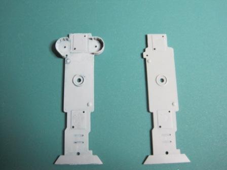

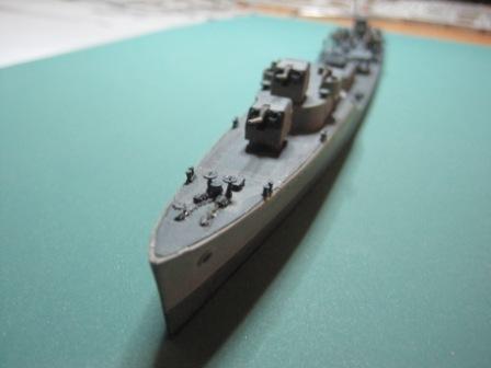

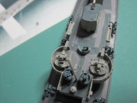

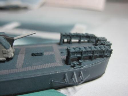

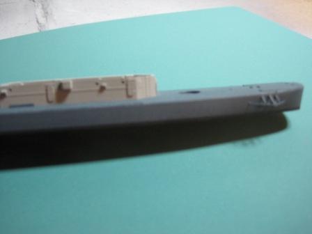

Starting some of the modifications for the 20mm decks needed. The first picture is a before and after comparison of removing the previous gun tubs. The second picture is showing the bulkhead that will be underneath the deck to show what it will match up to.

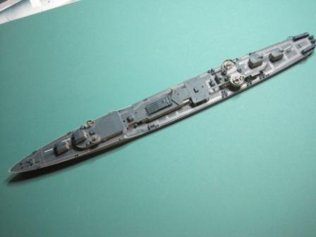

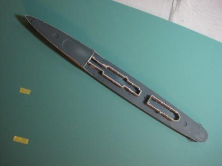

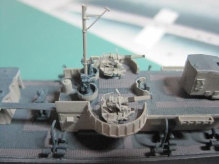

The third picture is merely me being tired of prepping parts and wanting to actually put something together that did not involve tweezers or bending something. My wife commented,"At last. It is looking less like a pile of parts and more like something remotely resembling a ship.".

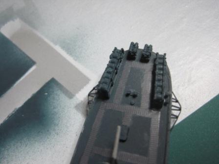

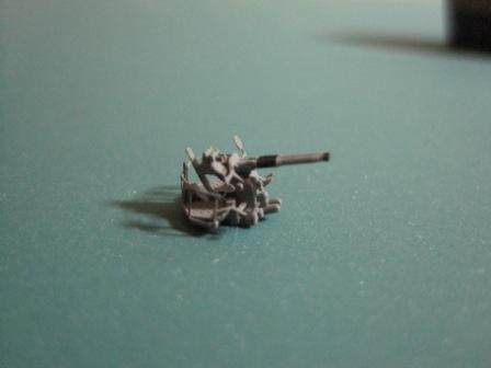

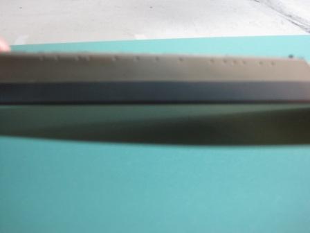

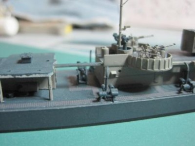

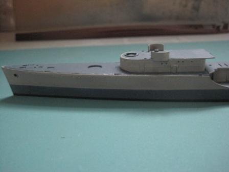

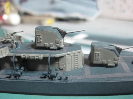

I finished painting the upper hull in M22. The pictures are a little fuzzy buy you will get the idea. I also attached the main decks. The last picture is one of the two 40mm mounts fully painted. Both are complete now.
As always, feedback is welcomed.

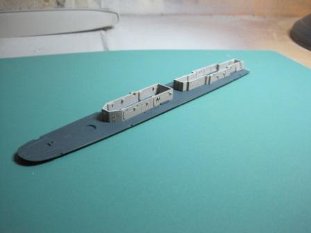

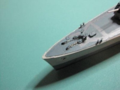

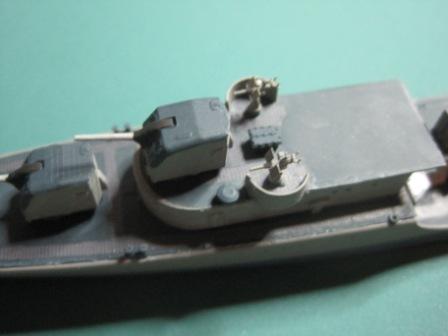

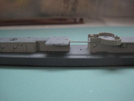

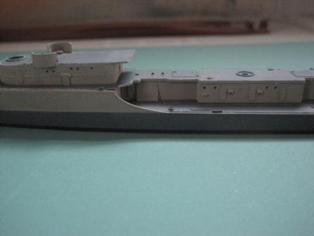

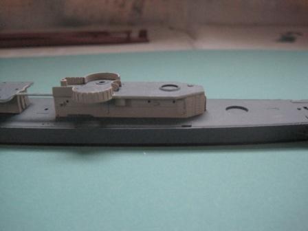

I now have the majority of the deck levels painted and attached. With only the bridge sections left on those.
What I have here is still in need of some touch up painting, but I wanted to share the current level of the build. The last picture shows the most clearly the scratch built 20mm gun decks that have been attached. The splinter shields will be done out of styrene. I was not overly happy with the fit, but I am hoping to hide that.
As always comments and suggestions are welcome.

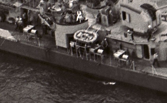

I am going to redo the K-guns with the racks. So if there are any good shots of those that any one has. I am mainly wanting to see the positioning difference from port to starboard. Also, I do not see any cranes where the racks are. Did they not use them?
Thanks again guys!
Gabriel
Posts: 3882
Re: USS Endicott DD495
Post by Rick E Davis »
Gabriel,
I have thought of doing a Square-Bridge GLEAVES class conversion myself using this resin set. But, I was reluctant to purchase the set until I actually saw one installed ... I'm kind of queazy about spending money on resin update sets after seeing the problems people had with the Nautilus 1/144 scale FLETCHER Square-bridge set. So, I'm really glad you are building this model and sharing with us. :cool_2:
To answer your K-Gun reload racks question first. No a crane wasn't needed, that was the idea of the reload racks. A reload depth charge could be "simply" slid over for loading unto the K-Gun. I think they left a "socket" for a removable crane at each K-Gun station so the could use the crane to restock the racks. But, they only needed one crane per side for all three K-Guns and then could store it. The third image below of the starboard side and the one I posted above covers both side of ENDICOTT showing the K-Gun layout.
I have added a couple of views of the centerline elevated 20-mm platform on ENDICOTT and a sister. This shows the opening on the portside and the extension on the starboard side for the ready service ammo box.
