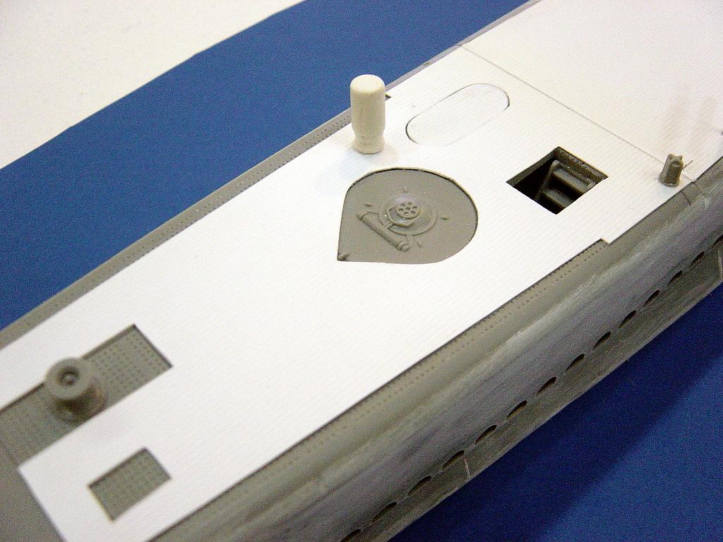

File comment: The new wood deck added forward. I have changed the location here of the accomodation ladder and the fwd. marker bouy well lid. On the Revell kit they are reversed. Note the resin sonar dome, from IBS.

File comment: One of the round bolted plates covering the 5" deck gun locations. One fwd and one aft. Made from .030 styrene sheet and hexagon tube.
With the conversion now completed, I'll move on the final paintwork using Testor's and Tamiya paints, acrylic and enamels. Stay Tuned............More to come.........I continue on :wave_1: :thumbs_up_1:
