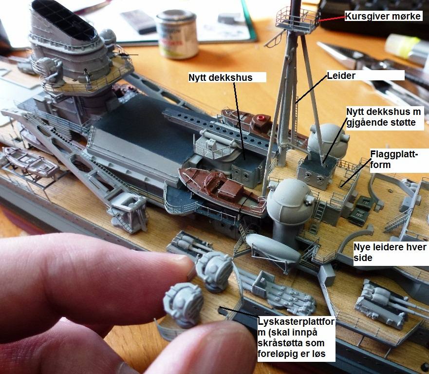

The whole area around the Main Mast needs to be adressed: There are two large deck houses in Blücher not present in Hipper. A lot of detail such as antennas, triangular reinforcement at the mast, a signal lamp, direction/course indicator night etc.
But the most isible and largest change is the signal platform. At this stage, I had already finished this platform in the "Hipper form", so it was nerve-racking to break it appart - but I succeeded without destroying anything important....
So a whole new / altered platform was made of plastic sheets and surplus wooden deck etc with one of the two "Blücher-specific" Deck Houses on top. All in all, a much larger signaling platform compared to the Hipper.

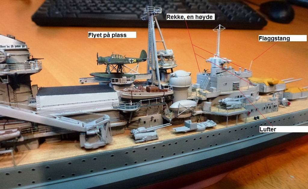

Well, some more pictures:

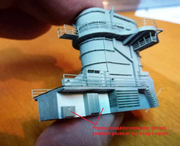

- The smokestack has to undergo mods just like the rest of the ship: There is different layout of platform intallations, steampipes, bridge to Admirals bridge and antenna ducting. In the photo you can see two ventilators each side. I spotted this error in time and were able to correct it before final assenbly. There should be only one, the rear one! So cut the foreward one away! The other ventilators (2) in Blücher are attached to the main superstructure not to the smoke-stack.
(90 degrees turned backward compared to the aft pair)
- The fortop is almost ready with it's radar FUMO 22 and rangefinder. Final painting of met installations and lanterns not done yet.

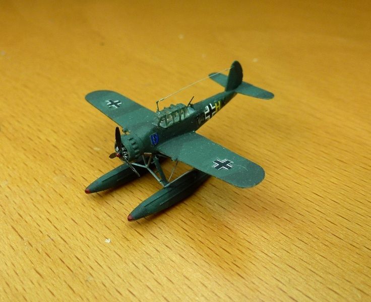

- The Arado is finished. Not correct marking for Blücher - sourced from a Tirpitz model...
- And finally: The cranes are installed. Quite a lot of work to produce a realistic crane! The plastic is quite rough, and the PE is 2D only, so I had to use the parts bin and make some bit and pieces of my own.
Tha Arado is in place, the changed platforms underneath it and deck houses can clearly be seen. The small ships boat in its "davits", and the ventiilator on the side of the aft superstructure (PE-leftovers) +++.

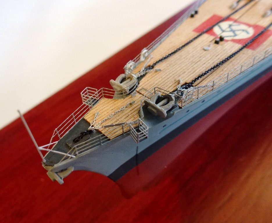

Well, Blücher is almost finished.
- The bow is finished, complete with anchor chains, flagpost and platforms.
- The foreward part of the ship is also finished. Observe the rubber mats/ rubber rings positioned around Turret A (and D). These were there to protect the teak deck from empty, spent cases disposed from the 203mm-turrets.
It was a challenge more then expacted to find suitable material for this, and shape it to correct shape. In the end, I ended up using stretched sprue fastened by small drops of superglue to form it into semicircles.
Also, paravanes (parts bin) and cannisters for claening rods for the main guns (scratch) are in position. Such cannisters were included in Trumperes Prinz Eugen set, but not in this set. I have absolutely no idea why...
- At the rear end you can see the gangway. The support for this was later excanged for a better looking version (from Dragon Scharnhorst), and the small 20mm gun on its platform.
Also note the Kriegsmarine ensign in the small, rear mast om top of the rear rangefinder (B/Wh-photo).
