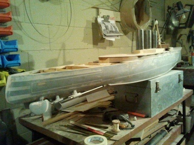

HMS Tiger
As promised; herewith a progress photo
The model's hull is complete and finished ready for painting. The hull is planked with "bread-and-butter" ends to get the tighter shapes. Filled to get shape correct and then fibre-glass. more sanding and filling to get the final surface. Detail of plate runs (only the overlapped strakes) are added using filler against masking tape to get the edge. The thin pale line represents the cover over the edge of the armour belt.
Prop shafts are fitted and next job there is to do props and how they fit the shafts. A-brackets are brass bearings on legs made of polymer moulding resin.
Superstructure (such as it was) is built up of ply and will have plasticard cladding to get the smooth effect of steel. It is mostly complete and the tripod mast is mocked up. This is the area where the plans do not match the 'as-built' and there is some guess work based on much peering at photos in the book. I think it is pretty right. The funnel blanks are car exhaust tube, a bit heavy, but strong and they will not distort. An interesting find; I spotted that the three funnels are different diameters, on the model they are 56mm, 52mm and 53mm which is confirmed on two plans, and a side view photo.
File comment: Apologies for the mess in the workshop. You may spot the twin rudders. I calculated the angle at 12 degrees
